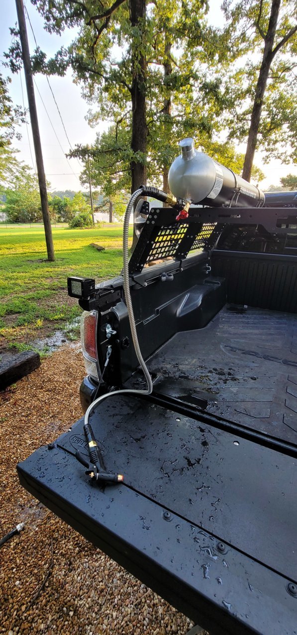

    I've been extremely happy with this aluminum water tank from BAMF on Amazon. Water gets quite hot here in Mississippi.

    I ended up with the same one as @codyjphoto. Picked it up on ebay and it's been awesome. Holds pressure for days easily and can pressurize up to 65psi which has been a LOT more than enough for what I'm using it for. BAM also sells a shower head that does a good job of making a little water feel like a lot but it still drips when you click the head to "off" when pressurized so you need to use the main valve to shut it off completely. Not that I think it matters much but it seems more aerodynamic than the Yakima ones.

    Its awesome,, been using the same pressured up water for like 5 days. Hosing off hands or face after yard work. Can you send me a link to the shower head?
    Side note, the safety pressure release sounds like a child being murdered in a horror film if you put in more than 65 psi.

    https://www.ebay.com/itm/154178985715
    It would be cheaper to DIY though.
    MIP/FIP/NPT are all the same (compatible anyway, so you know what I mean, plumbers) I'm just using it to denote male and female ends. GHP is specific to garden hoses afaik. Also, this is my best guess but check for yourself/don't be mad at me if I made a mistake :p
    1) 15" 3/4 FIP water heater flex hose - $2.65 Homedepot
    2) 3/4" female GHP to 3/4" MIP
    3) 3/4" MIP to 1/2" MIP
    4) Water saver shower head with an on/off button (with the standard 1/2" FIP threading)
