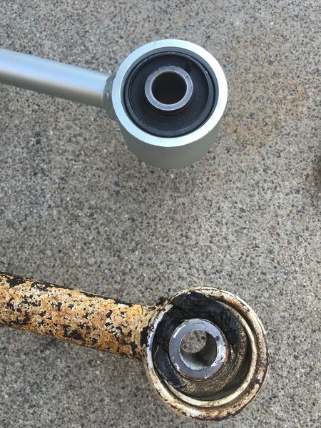

    • Total Chaos uni-ball UCA's

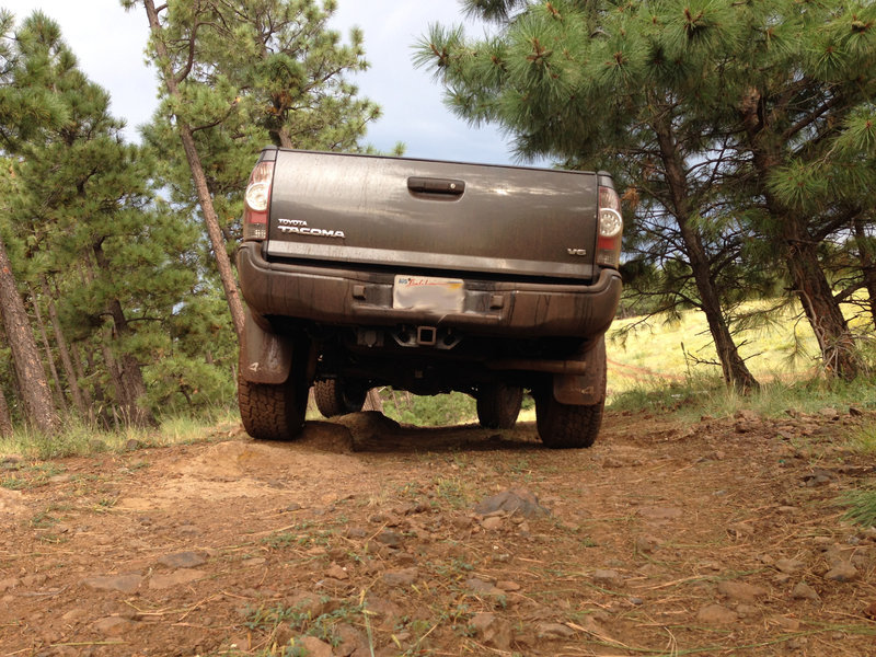

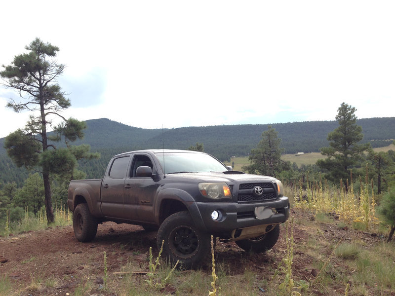

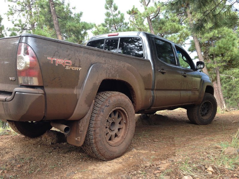

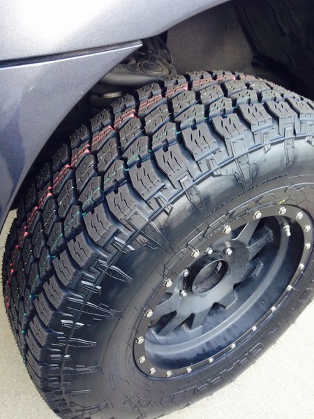

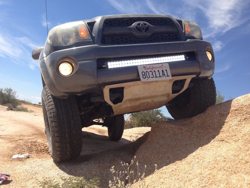

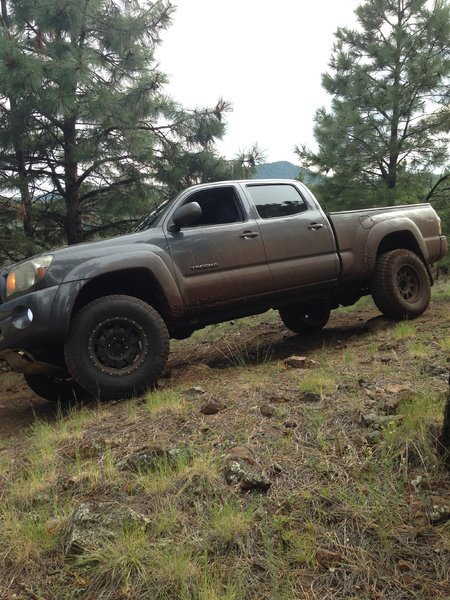

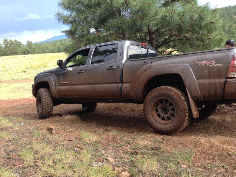

    After having the truck for about a week or so I threw on the Terra Grappler G2 285/70R17 tires because the old ones were cupping.

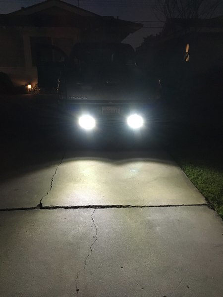

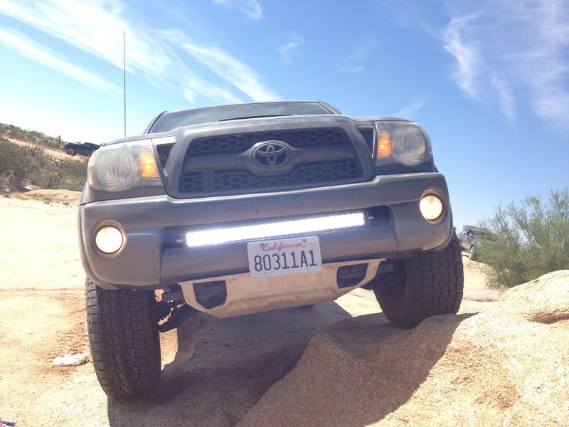

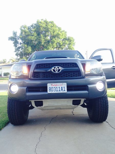

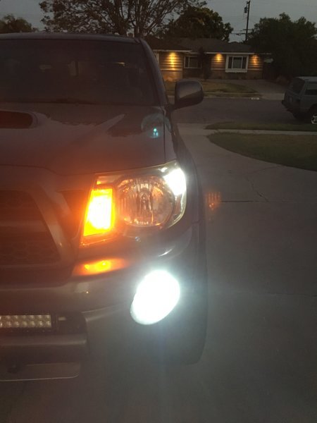

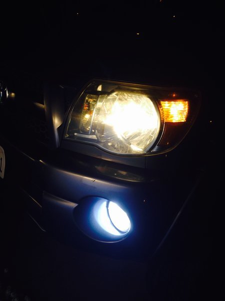

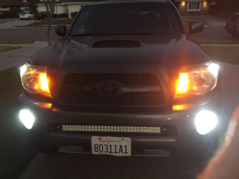

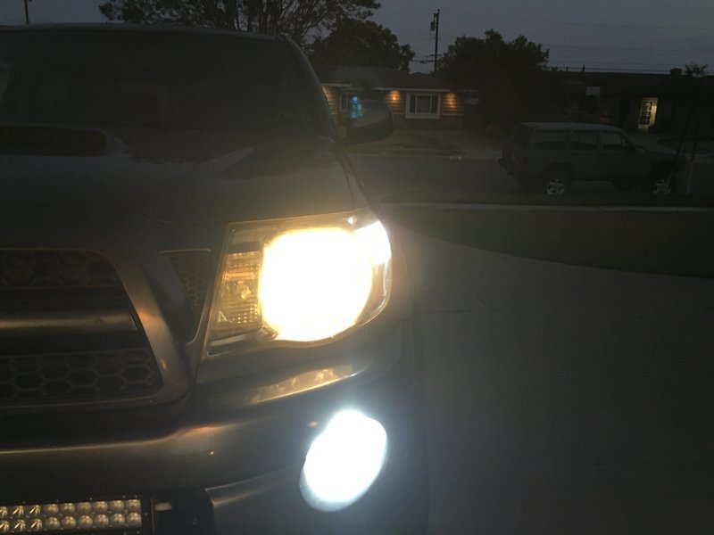

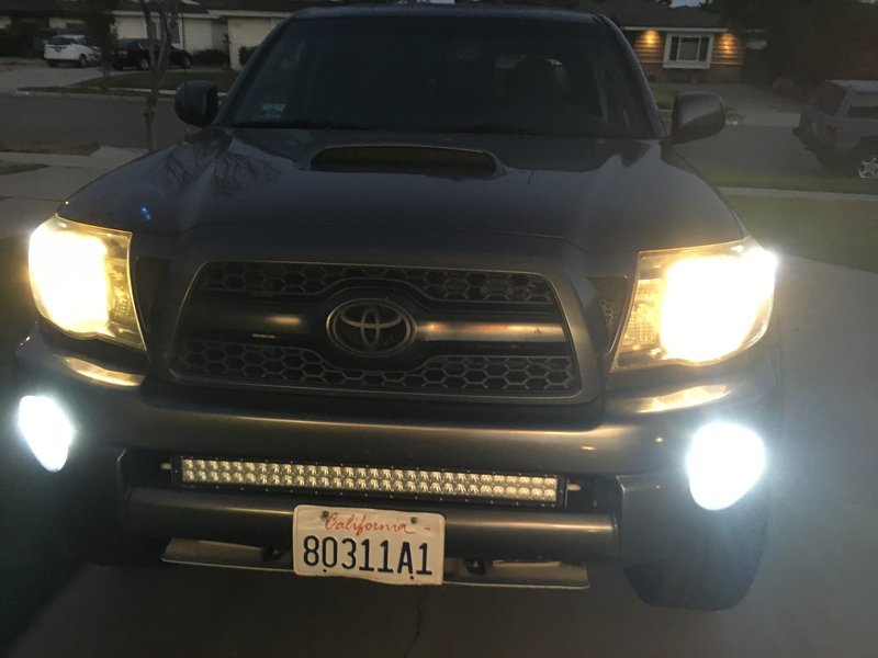

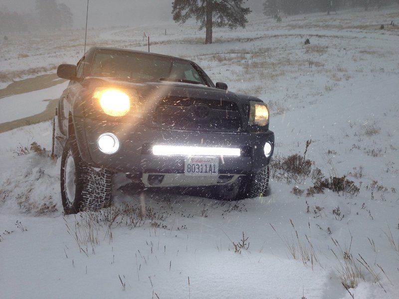

    Did the anytime fog light mod then I replaced the fog, map, dome, and license plate lights with LED's.
    FullSizeRender (10).jpg FullSizeRender (7).jpg FullSizeRender (4).jpg FullSizeRender (6).jpg

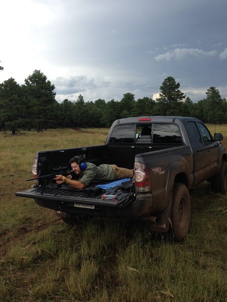

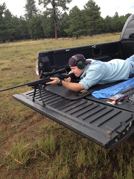

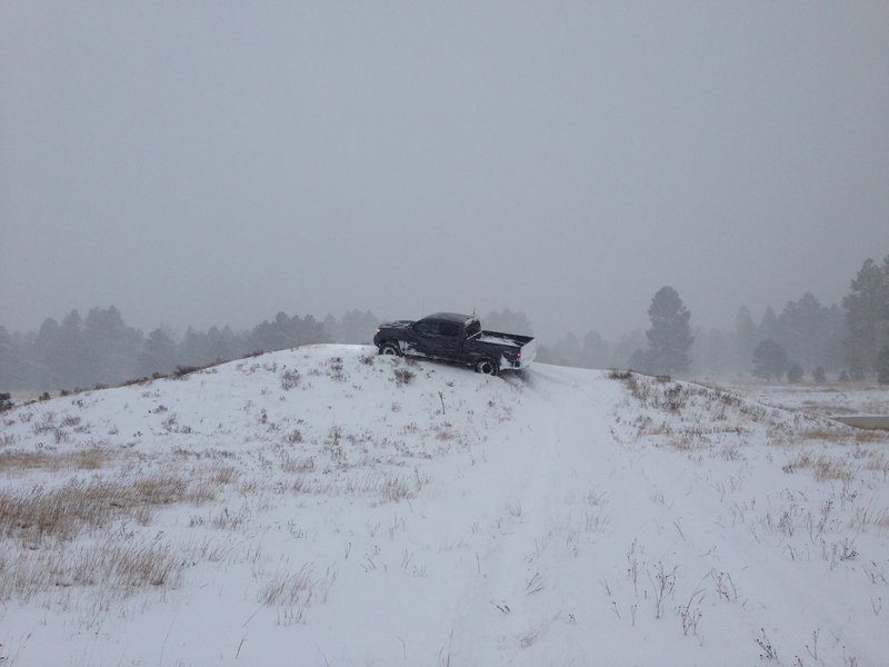

    Some general around Flagstaff BS. The truck bed served as a pretty decent spot to lay and shoot from, put some foam down but still a little hard.
    IMG_2014.jpg IMG_2015.jpg IMG_2016.jpg IMG_2017.jpg IMG_2018.jpg IMG_2019.jpg IMG_2020.jpg IMG_2021.jpg IMG_2023.jpg IMG_2024.jpg IMG_2044.jpg IMG_2051.jpg IMG_2052.jpg Howerton_Brett_CS_110_HW0.jpg

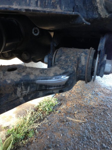

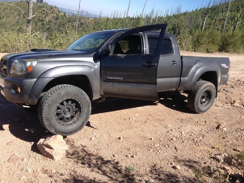

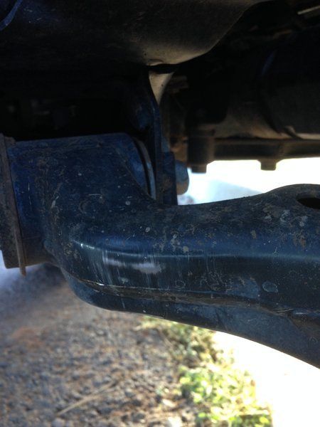

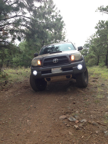

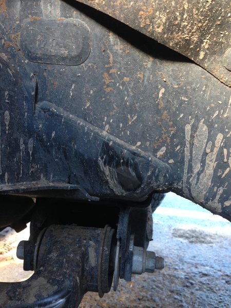

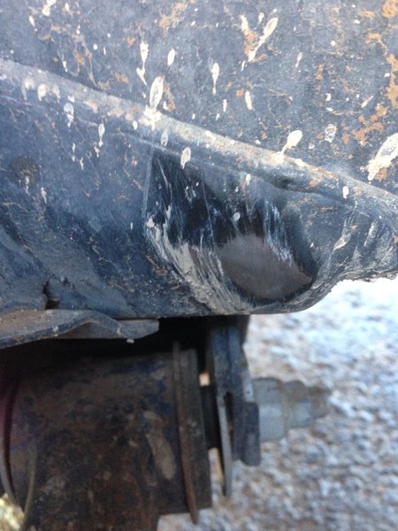

    Started to notice some rubbing on the LCA and stuff but too lazy to deal with it not too major at the moment.
    IMG_2161.jpg IMG_2162.jpg IMG_2163.jpg IMG_2164.jpg IMG_2165.jpg IMG_2166.jpg

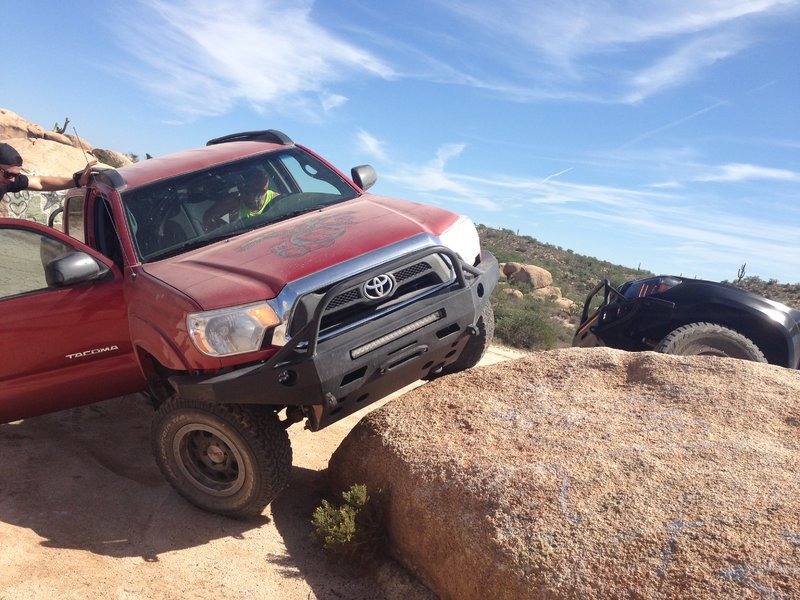

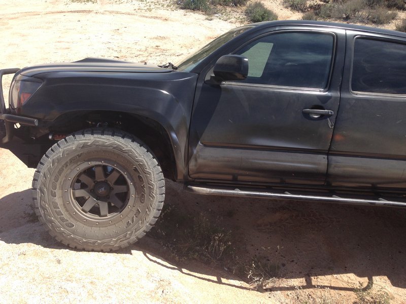

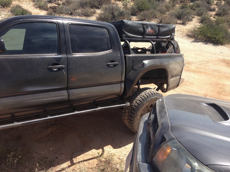

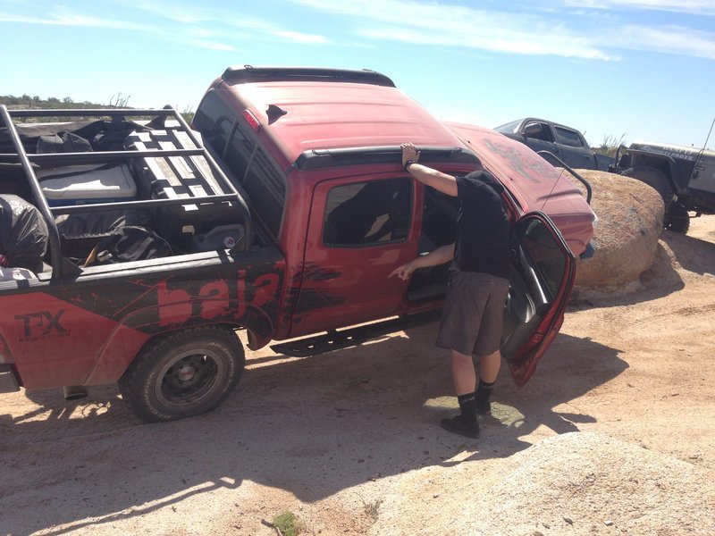

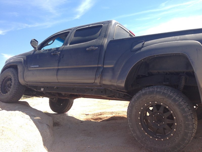

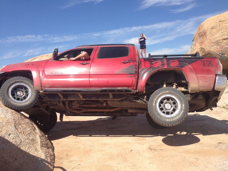

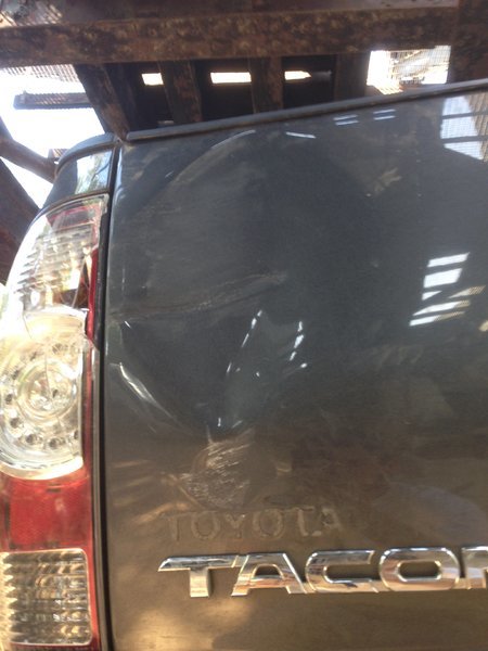

    First TW meet with some of the AZ peeps in Florance. Although the truck got some damage it was fixed perfectly. Also removed the swaybar this trip.
    IMG_2076.jpg IMG_2077.jpg IMG_2078.jpg IMG_2079.jpg IMG_2080.jpg IMG_2081.jpg IMG_2082.jpg IMG_2083.jpg IMG_2084.jpg IMG_2085.jpg IMG_2086.jpg IMG_2087.jpg IMG_2088.jpg IMG_2089.jpg IMG_2090.jpg IMG_2091.jpg IMG_2092.jpg IMG_2093.jpg IMG_2094.jpg

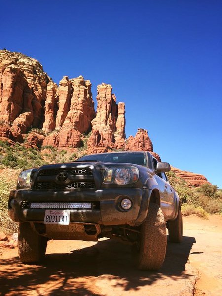

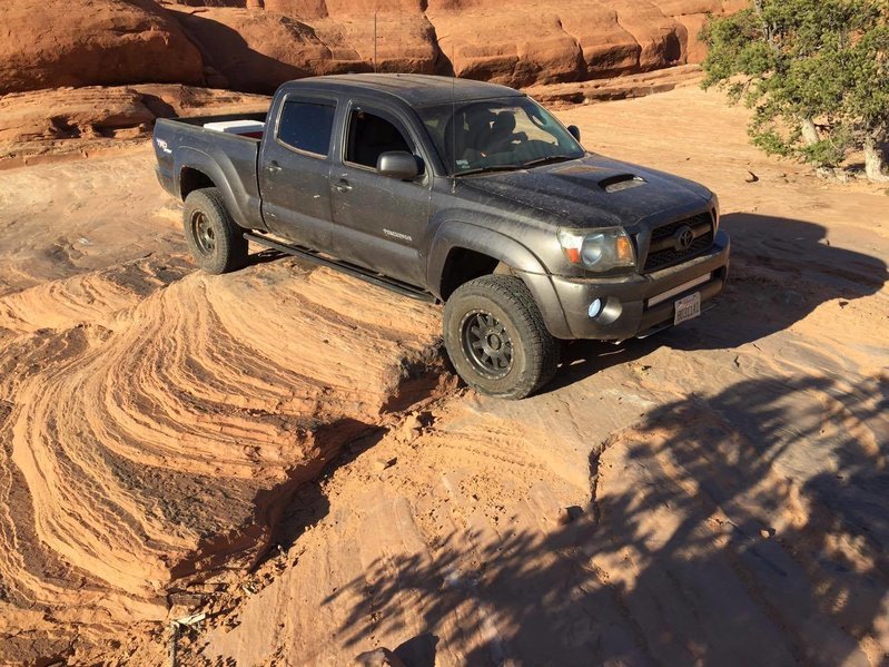

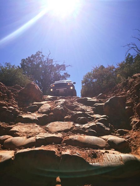

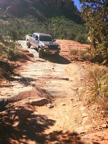

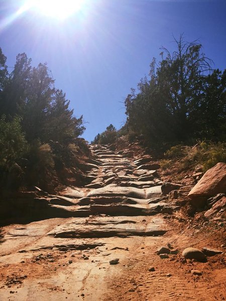

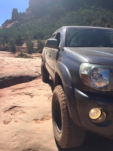

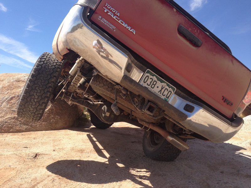

    First run of Broken Arrow in Sedona didn't get to play in the crack until another night.
    12072616_10203703322064058_4331417103198532731_n.jpg 12072689_10203703324784126_8872990617620636720_n.jpg 12074938_10203703320944030_5035804676179642105_n.jpg 12088320_10203703325944155_1713214887800483400_n.jpg 12096500_10203703323504094_8299778834846189792_n.jpg 12105869_10203703308343715_9028874223843616044_n.jpg 12107080_10203703322784076_2675859078510782508_n.jpg 12119040_10203703325224137_5883089538686334243_n.jpg 12143196_10203703322304064_1502725283682214782_n.jpg

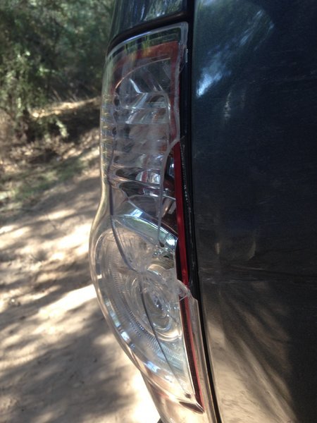

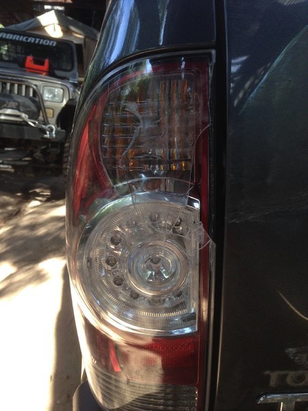

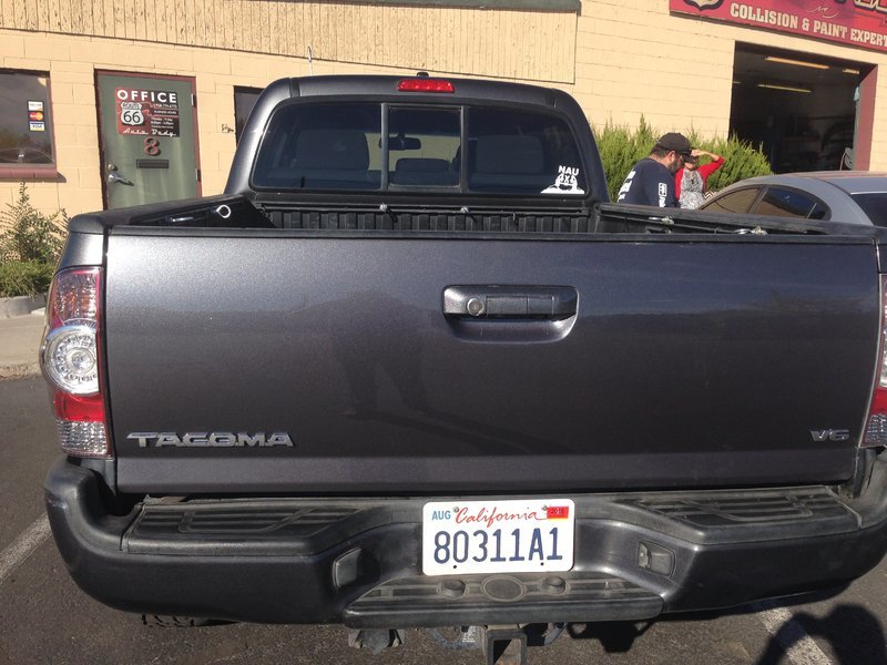

    Got new taillights due to them being broken in the forest.

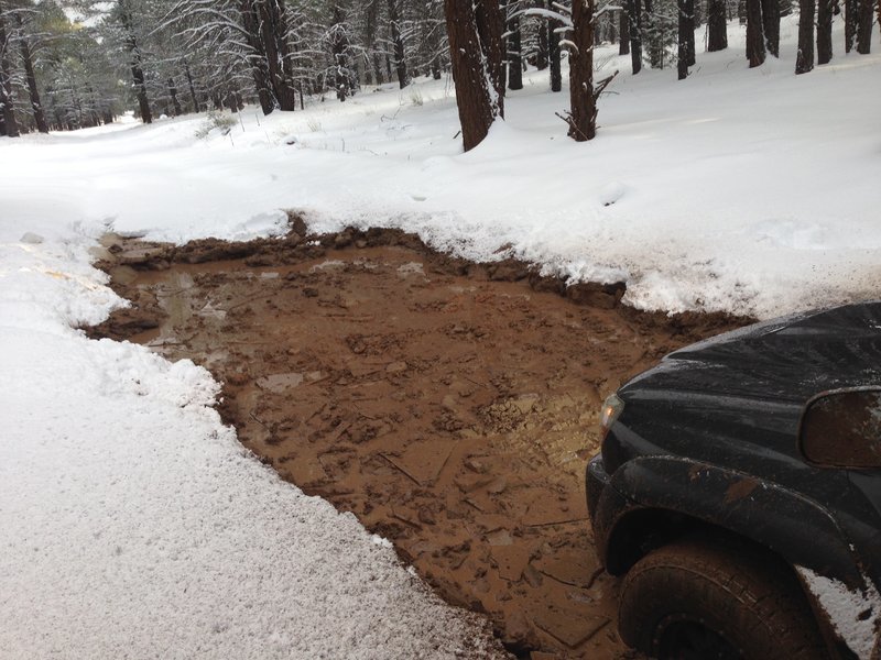

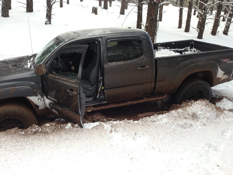

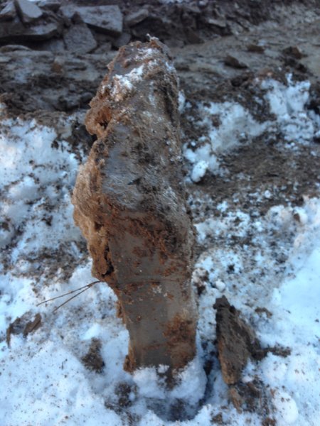

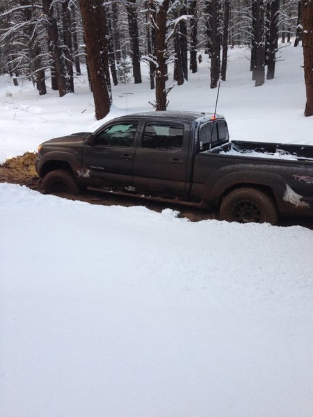

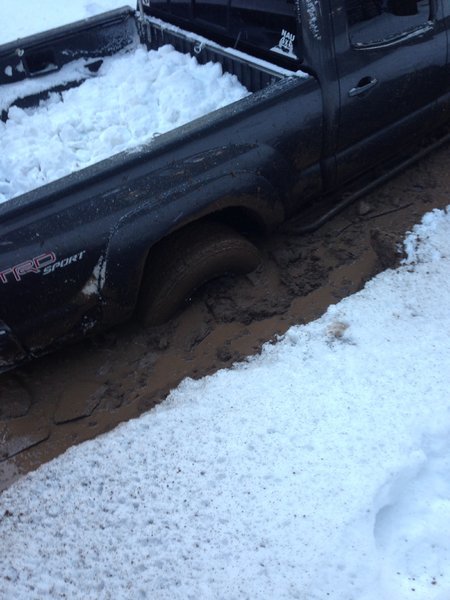

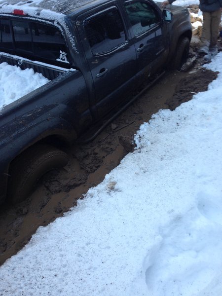

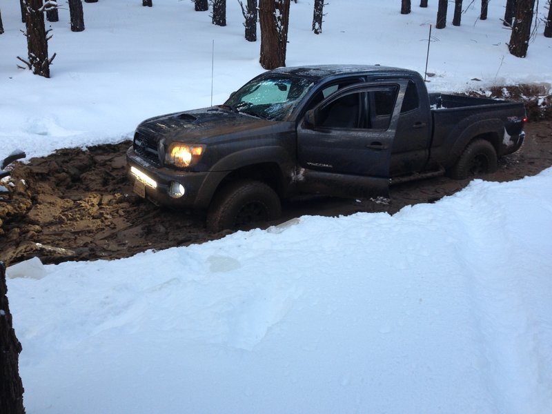

    Was out looking for a friend who was stuck ended up in some mud ice combo.
    IMG_2234.jpg IMG_2235.jpg IMG_2236.jpg IMG_2237.jpg IMG_2238.jpg IMG_2239.jpg IMG_2240.jpg IMG_2241.jpg IMG_2242.jpg IMG_2243.jpg IMG_2244.jpg IMG_2245.jpg IMG_2246.jpgIMG_2248.jpg IMG_2249.jpg IMG_2250.jpg IMG_2251.jpg

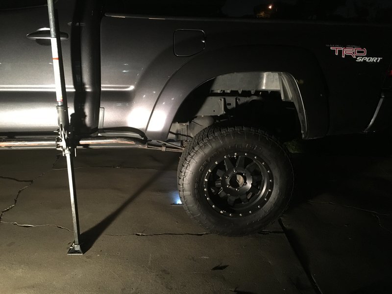

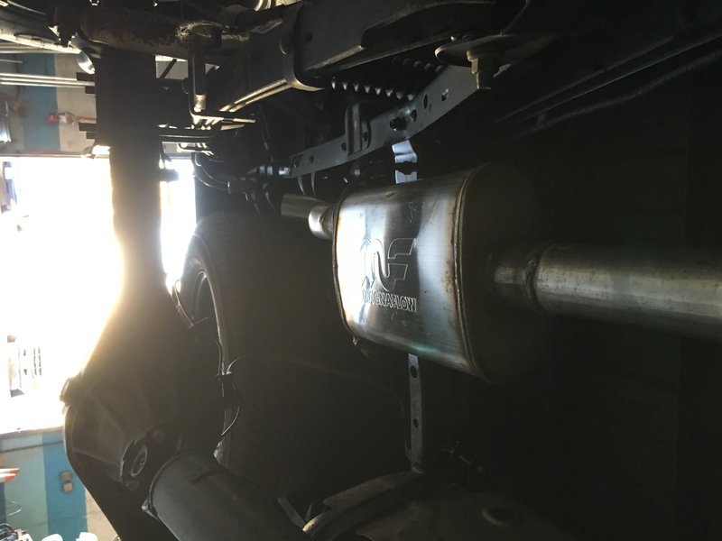

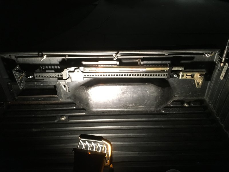

    Got the Hi-lift mounted it and got the exhaust.

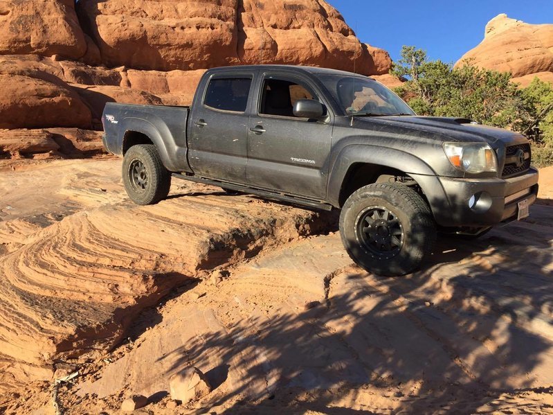

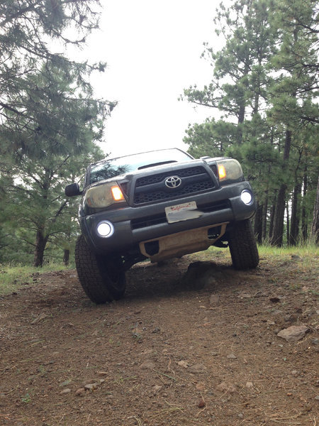

    Rocky Gap Rd in Las Vegas. Was a fun trail but was a little scared still new to off roading.
    IMG_4971.jpg IMG_4972.jpg IMG_4975.jpg IMG_4977.jpg IMG_4978.jpg IMG_4979.jpg IMG_4982.jpg IMG_4984.jpg IMG_4986.jpg IMG_4987.jpg IMG_4988.jpg

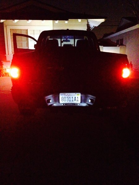

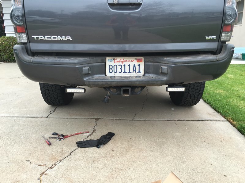

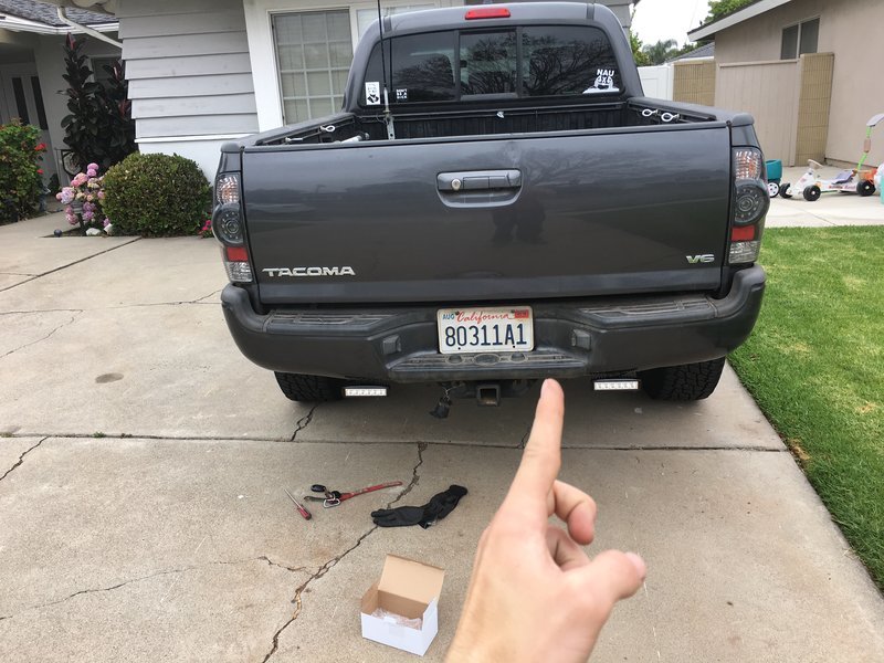

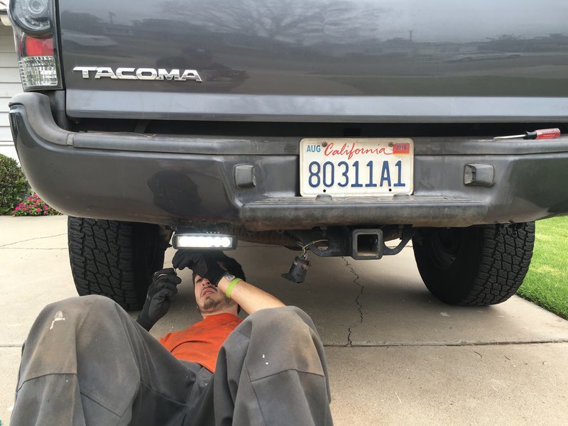

    Got the reverse/ fuck you lights put in and wired up.
    IMG_3455.jpg IMG_3456.jpg IMG_3457.jpg IMG_3458.jpg IMG_3466.jpg IMG_3467.jpg
    LED turn signal and running lights installed.

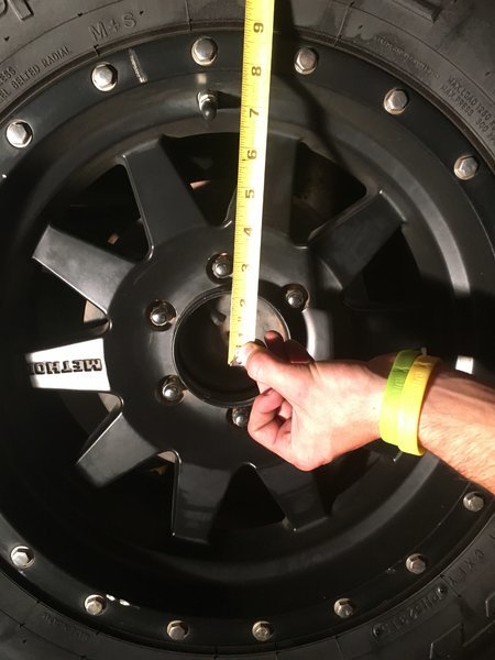

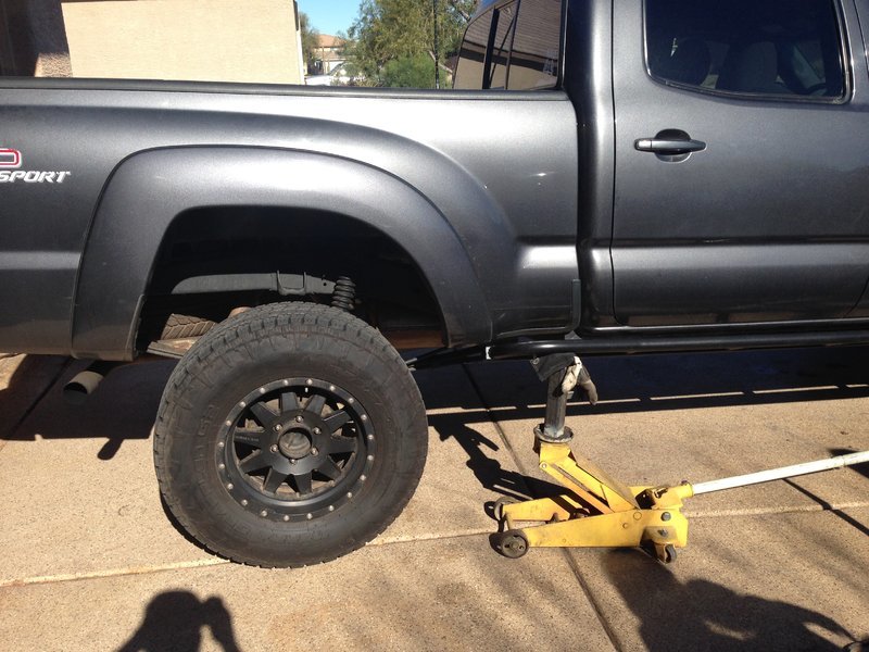

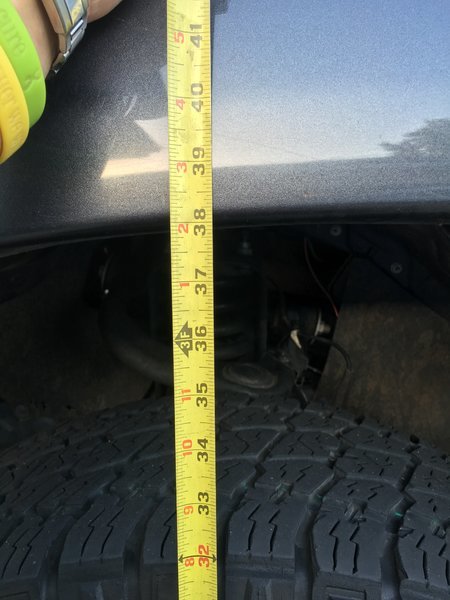

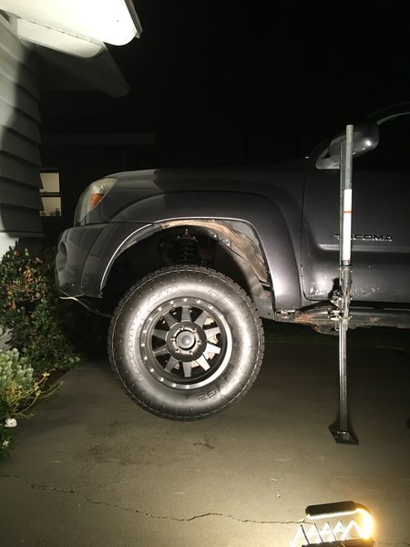

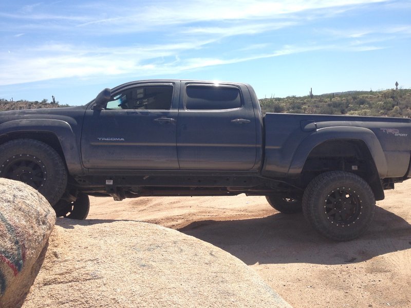

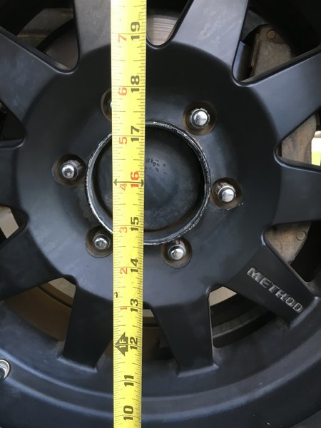

    Pre-lift measurements
    Measurements Cliff notes
    • Odd camera angles and probably bad measurements from me, so I kinda changed a few numbers.
    • Front: 2" ((38"-15.5")-20")
    • Rear: 1.5" ((37"-15.5")-20")
    ok so here is how she sits
    Front coilover
    Front measurements are from ground to hub and ground to fender (to fender-to hub=lift)
    Rear lift block, leaf spring, and shock
    Rear measurements are from ground to hub and ground to fender (to fender-to hub=lift)

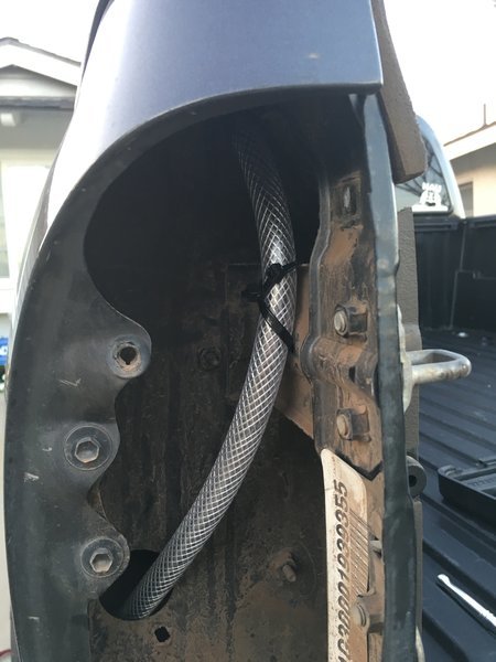

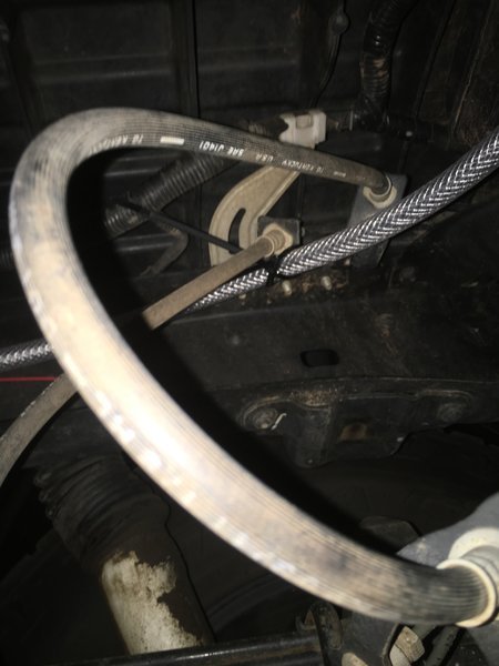

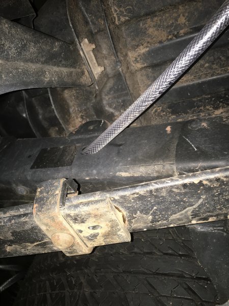

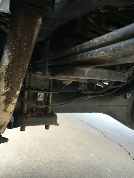

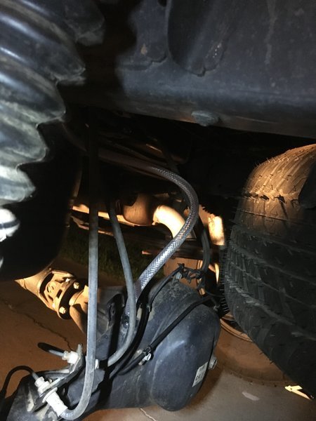

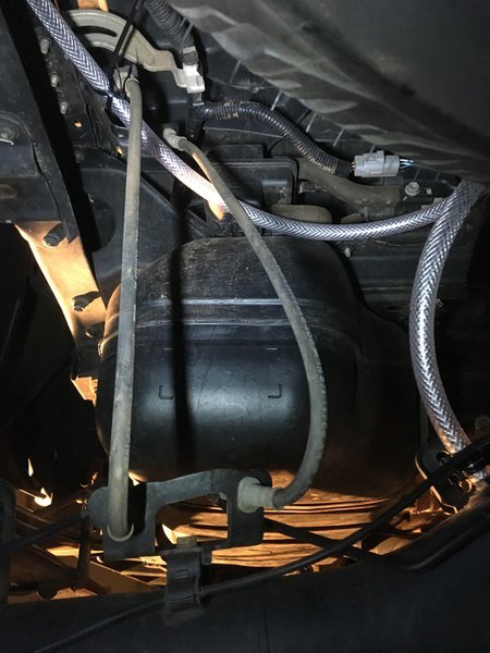

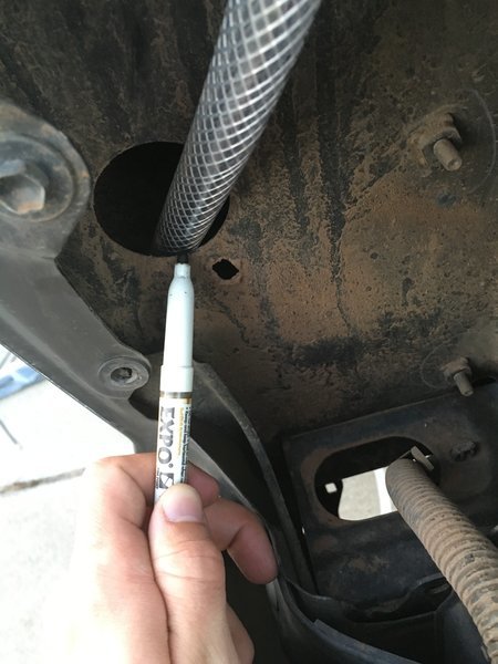

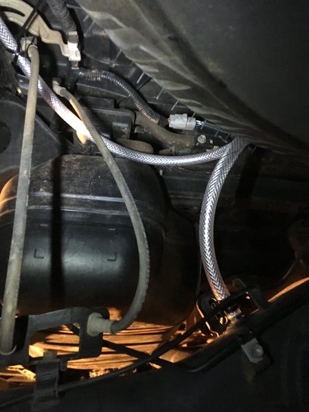

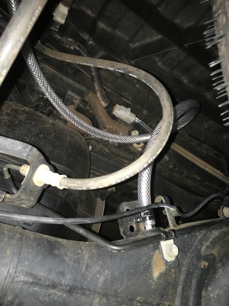

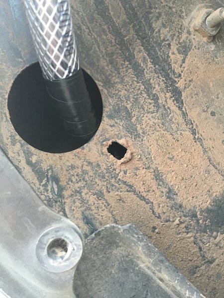

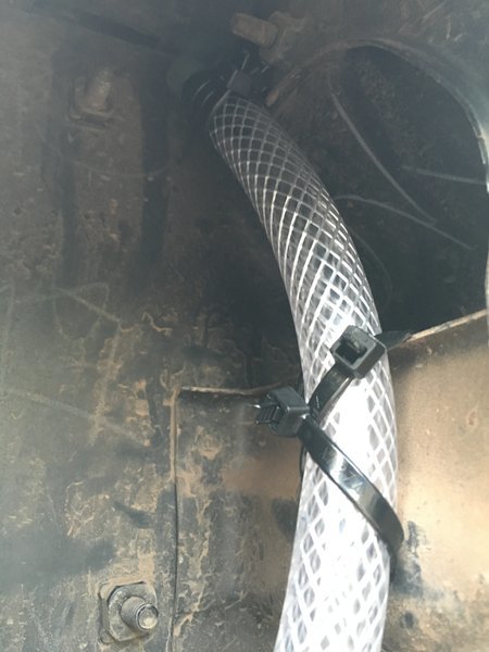

    Differential breather mod.
    Breather is all the way up at the top of the bedside behind the driver tail light.
    To help stop it from cutting the hose.
    There is a second zip tie here now to keep it in place better.
    I have a zip tie holding the tube up to the bed now.
    Ran through the frame.
    Tied it to a brake line mount.
    Drooped the suspension out. Just got the one tire off the ground a tad to get length of tube at full droop.
    This was while still full droop I made sure to add about 6" ontop of full droop just to be safe.
    While back on the ground.

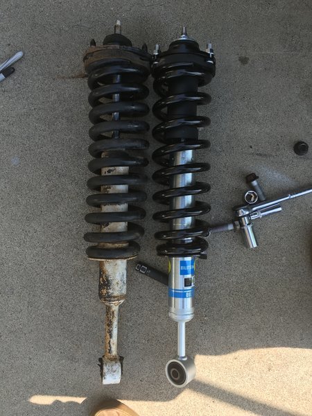

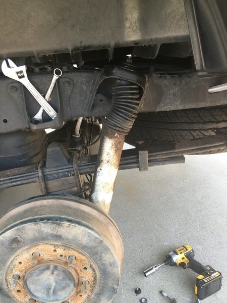

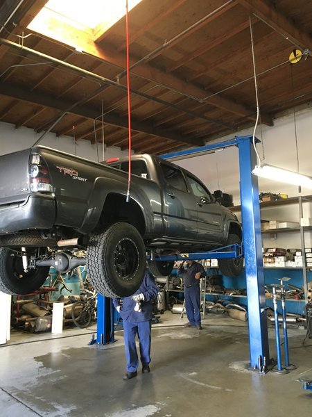

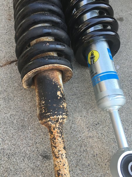

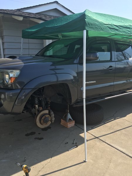

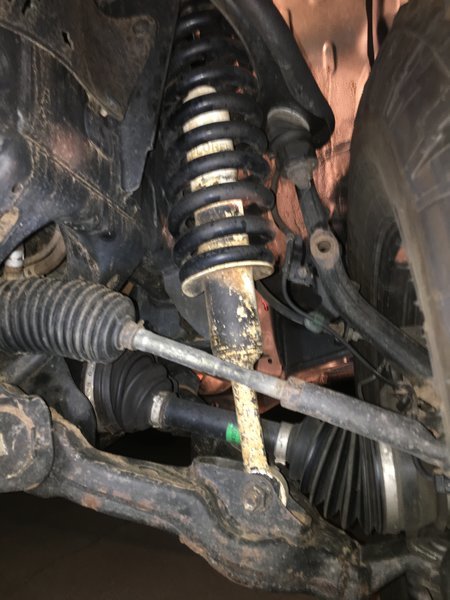

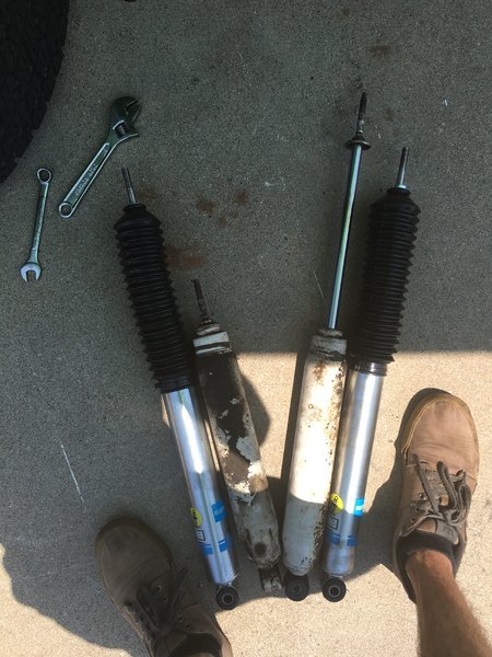

    Threw the new suspension on the other week.
    Front

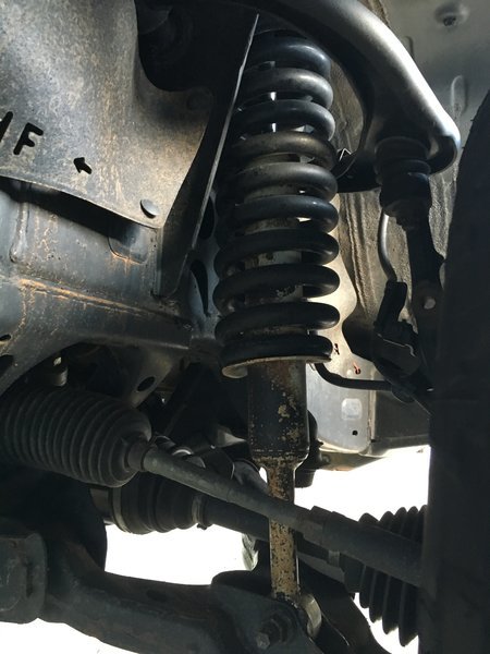

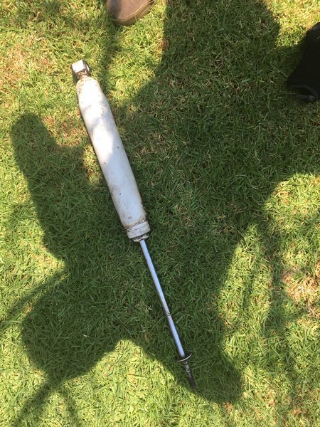

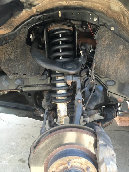

    Old struts removed.
    Big difference between the old and new shocks. I now need new UCA's due to the UCA hitting the spring at full droop. (Thought I took pics of new shocks on the truck but I guess I didn't.)

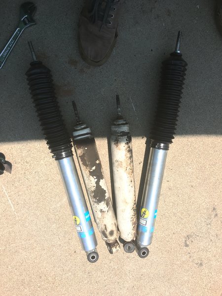

    Rear

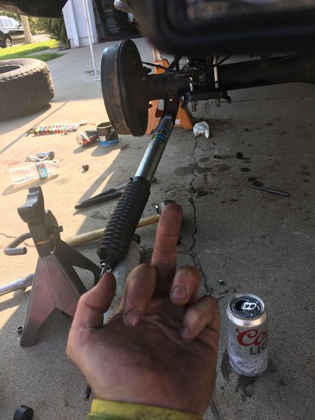

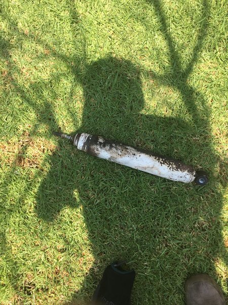

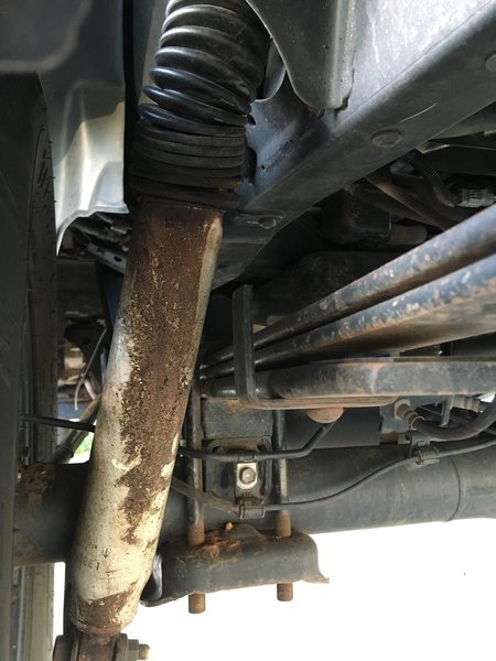

    Rear shocks out.
    Old shocks were slightly longer than the 5100's but definitely blown.

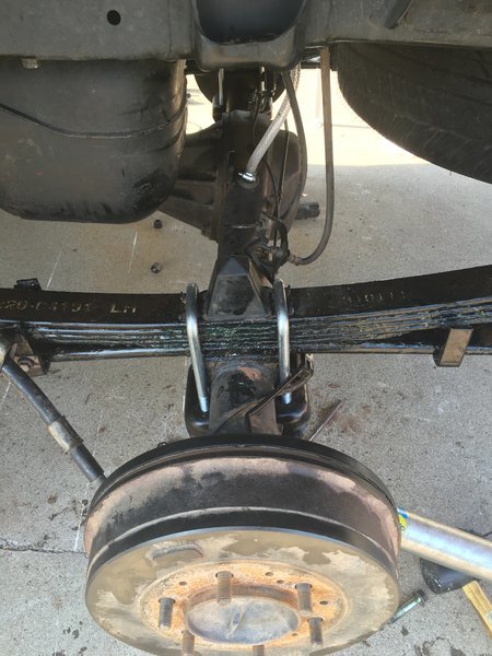

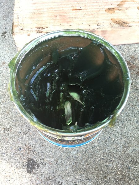

    Greased the living piss out of the leaf springs. I probably shouldn't have used marine grease but it was cheap and in front of me so I used it. (No pics of the AAL install due to greasy hands.)
    Was having issues getting the lower mounts into place by myself. Finally a friend showed up and we bent the bracket out more than I already did, greased it up again, mounted the top, set the lower in place, jacked up under the lower mount, and lots of hammering but they finally went in. (No pics of rears in place I was over working on the truck.)

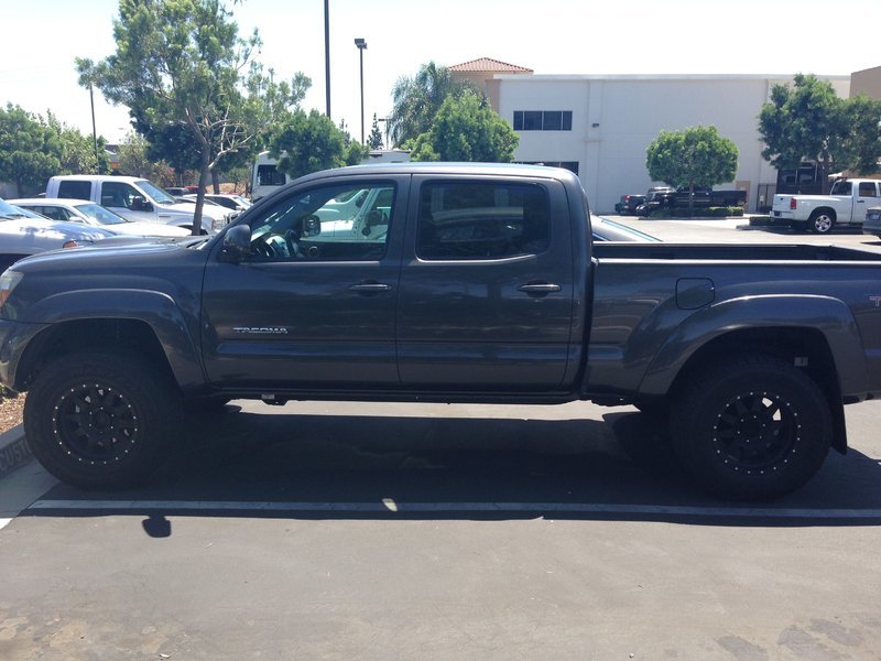

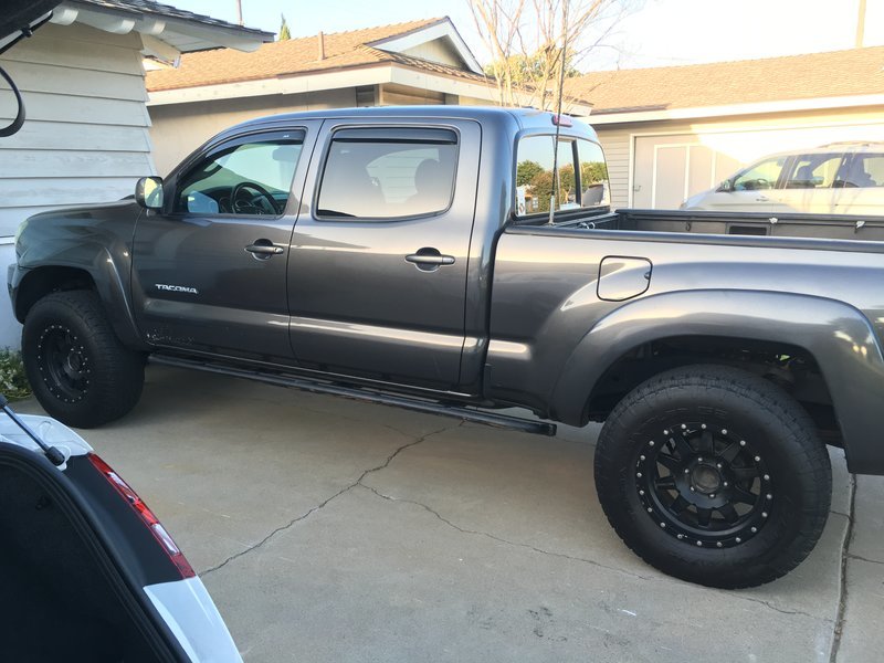

    After
    I think it sits and flexes just about the same. Although rides a lot nicer but going from a blown suspension with 718 lb. springs to new suspension on 590 lb. springs with no sway bar is quite scary.

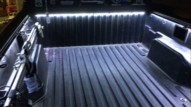

    Installed bed lights on a switch located in the bed.
