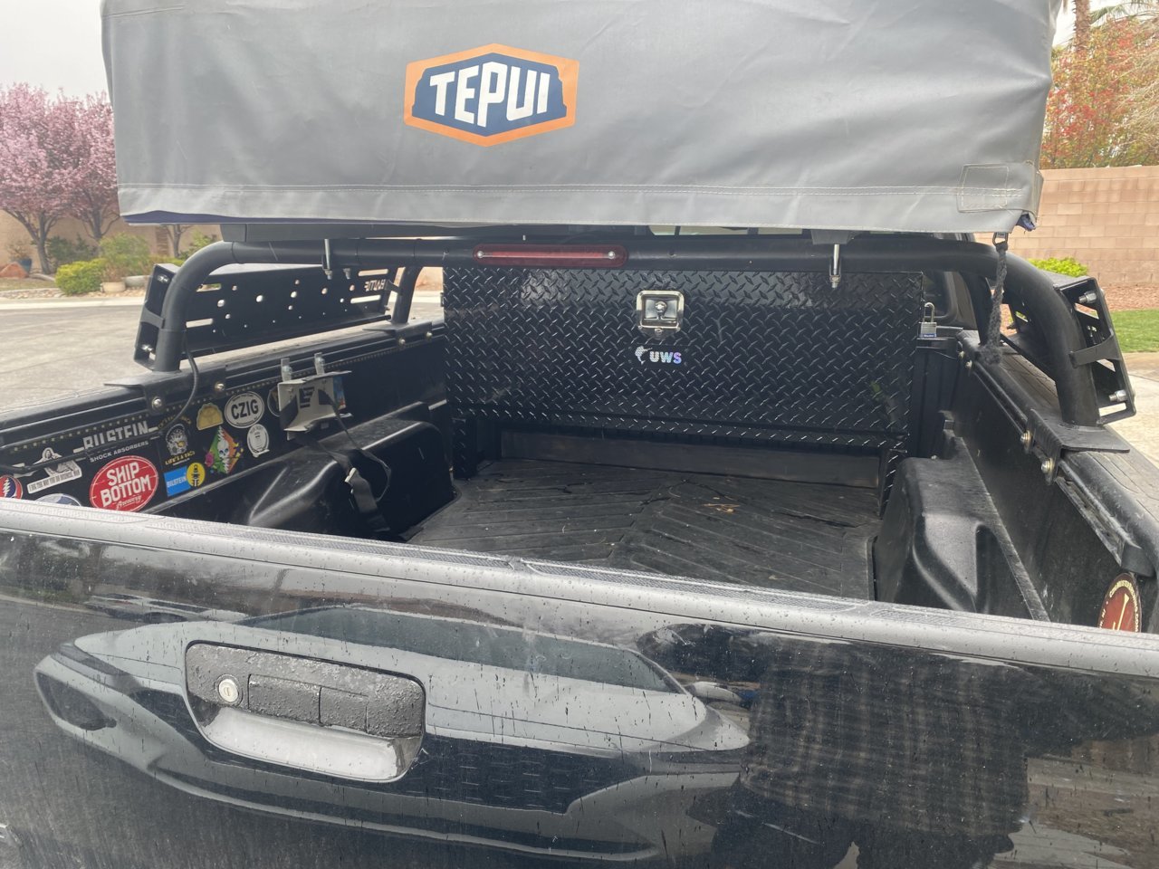

    Hey all, so the idea here is that I’d be doing a 2-3 month road trip over the summer with me, my girlfriend and our dog.
    I’ve been wracking my brain trying to come up with secure, locking storage solutions for when we hike for a day etc. I have a pop and lock tailgate lock, but my current setup with the tent and rack allows people to reach in and grab whatever they want or remove my bins.
    Id like to store 3-4 Plano sportsman trunks in the back. 1 bin kitchen, 1 bin food, 2 bins clothes, cooler and water jugs will ride in the backseat (access cab seat delete). I’ve considered:

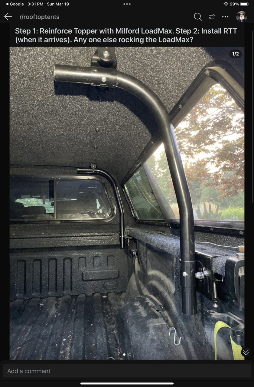

    • Buying a lower rack so that nobody can remove the bins. Just put 2 padlocks on them each. I’d lose my toolbox this way.
    • Hiring a welder/fabricator to make a “cage” with the rear bed rack (or something similar) so no one can pull bins out.
    • Chaining my bins with a padlock to the rack?

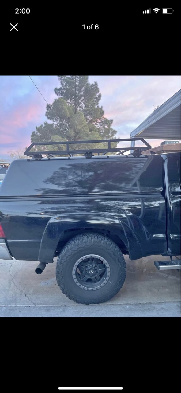

    • Buying the pictured topper, it has no windows aside from the back, but I’m not sure how it’d hold up to the weight + fire roads. Seller doesn’t know the brand and would take $600, wanted $900
    • Kind of a PITA, but just removing the bins from the bed each time and throw them into the cab somewhere.
    I’m open to other solutions from those who have some. Putting the bins in the cab each time would be the cheapest solution but would suck in the case of rain or coming back from an 8 mile hike and having to move stuff. However, money isn’t an issue (within reason of course)

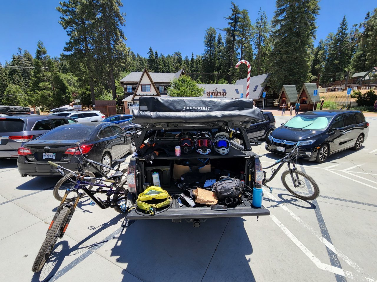

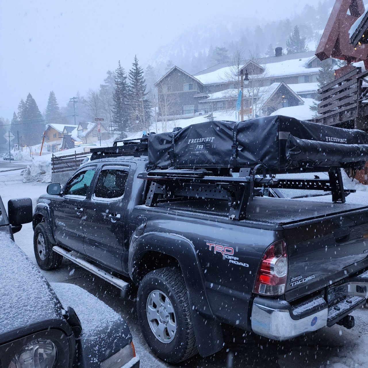

    I have a KB Voodoo rack with my BAK Revolver. I don't have a good shot of it, but here are some pics. I usually keep 2 Plano 108qt sportsman trunks underneath and whatever other stuff I decide to bring when camping. I can still roll it up most of the way to access items deeper in the bed.

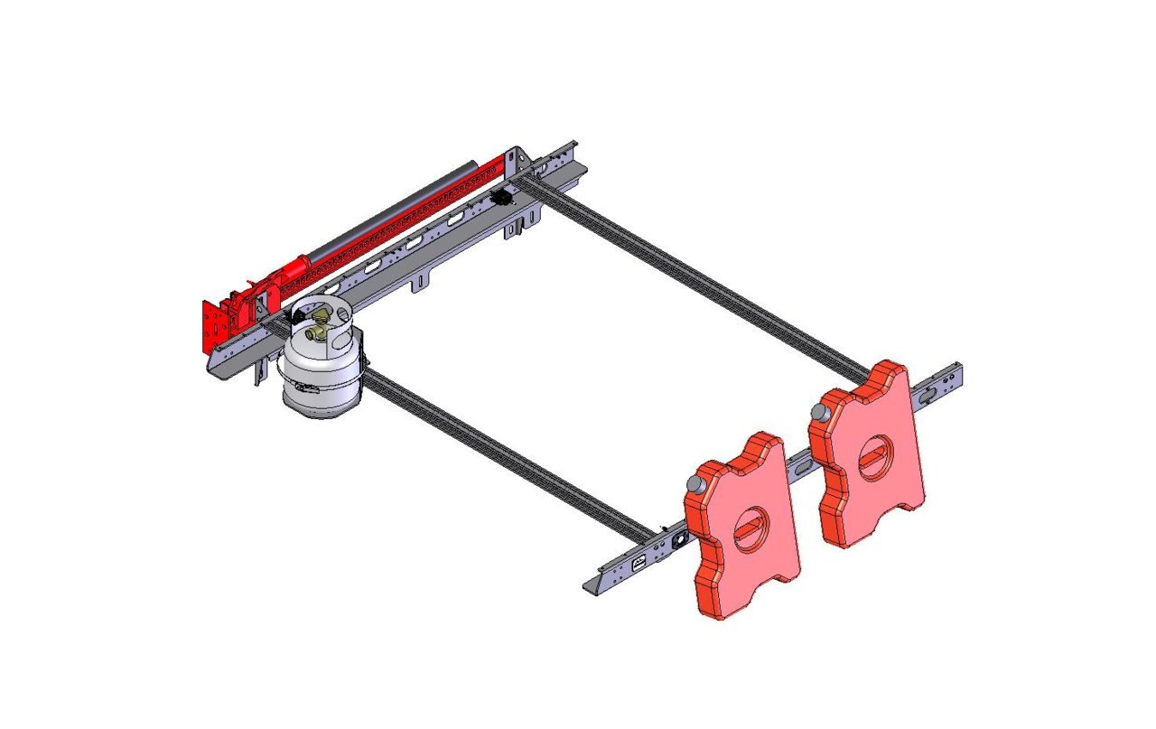

    Thank you, I believe I’m going to go with the cap though and weld up some supports similar to the one in the photo except have it go down to the bed. No US sellers of these apparently, it’s an Australian company (further proves they get all the good stuff), don’t know if it’s just not in the US market yet. Seems like a good idea though for those who wanna run heavy weight on their camper shells.
    If I decide otherwise I do have my eyes on a set of your low profile bars already
