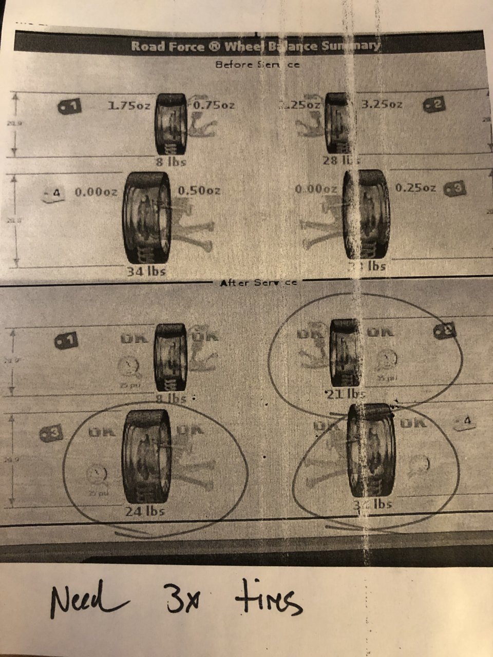

    New Member posting for the first time.
    I bought a Used 2020 Cement Tacoma TRD Off Road in November with 20,000 miles
    This is my first Tacoma, I've had several TJ Jeeps and a 03 Tundra in the past.
    When I drive my tacoma on Highway at speed between 65-85 the truck vibrates pretty strongly. The passenger seat with no one it, visually vibrates from he seat back and the fuel door also vibrates. I took it back to the dealer and supposedly they checked the trie rods, ball joints, and tire balance and said they couldn't duplicate it during a road test.
    Wondering if anyone has any suggestions? I realize the tacoma might not have the smoothest ride around but can't imagine what I'm feeling is normal.

    Thanks for the suggestion. I had them do a high speed balance today. the fronts were off by a few oz's, so I thought that would fix it. After I road tested it it felt, the same. So Im assuming that variable is eliminated. The tires a pretty new (sumitomo encounter ht). I guess I can always check the u joints, can't imagine they could be compromised after 20,000 miles. Wanted to replace the tires with some BFG AT's but doubt that would solve the problem.

    Still sounds like one of tires have a balance issue. I bought new tires once, had them rebalanced4 times. Then I looked at the weights and 1 wheel had 1/2 pound of weights on it! They knew that tire was bad and they were trying to pawn it off on me. They finally replaced it. Check your wheels see if they have a ton of weights on them.

    I worked tires for the better part of two decades. Never laid a hand on a Sumotummy. I'd follow the tire guys recommendation and put some tires on it. (3.25oz is like strapping a small hammer to the tire lmao) Not E rated tires, but the tires that are recommended on the truck. Yeah, I'm a Debbie Downer. I'll bet there are over 2,000 threads on tires on this forum, twice a week, rubbing, vibrating, alignment. Good luck Sir.

    I'm curious was tire make/model these are? My winter tires would vibrate at 55-60 mph like that but the summer tires didn't. I had them balanced multiple times, by different service centers, but no changes. I'm convinced some tires just vibrate more than others.

    Had that issue with 33's All Terrain tires found out the only thing that solves the issue on my 2016 is Road Force Balance. I get no vibration at a with Road Force Balancing

    Boonedoggle, They are practically new sumitomo HT tires. They are a highway truck tire. Ive had them balanced 3 times they all zero out after each balance. Truck is a year old with 20,000 miles on it. They were on the vehicle when I bought it last month.
