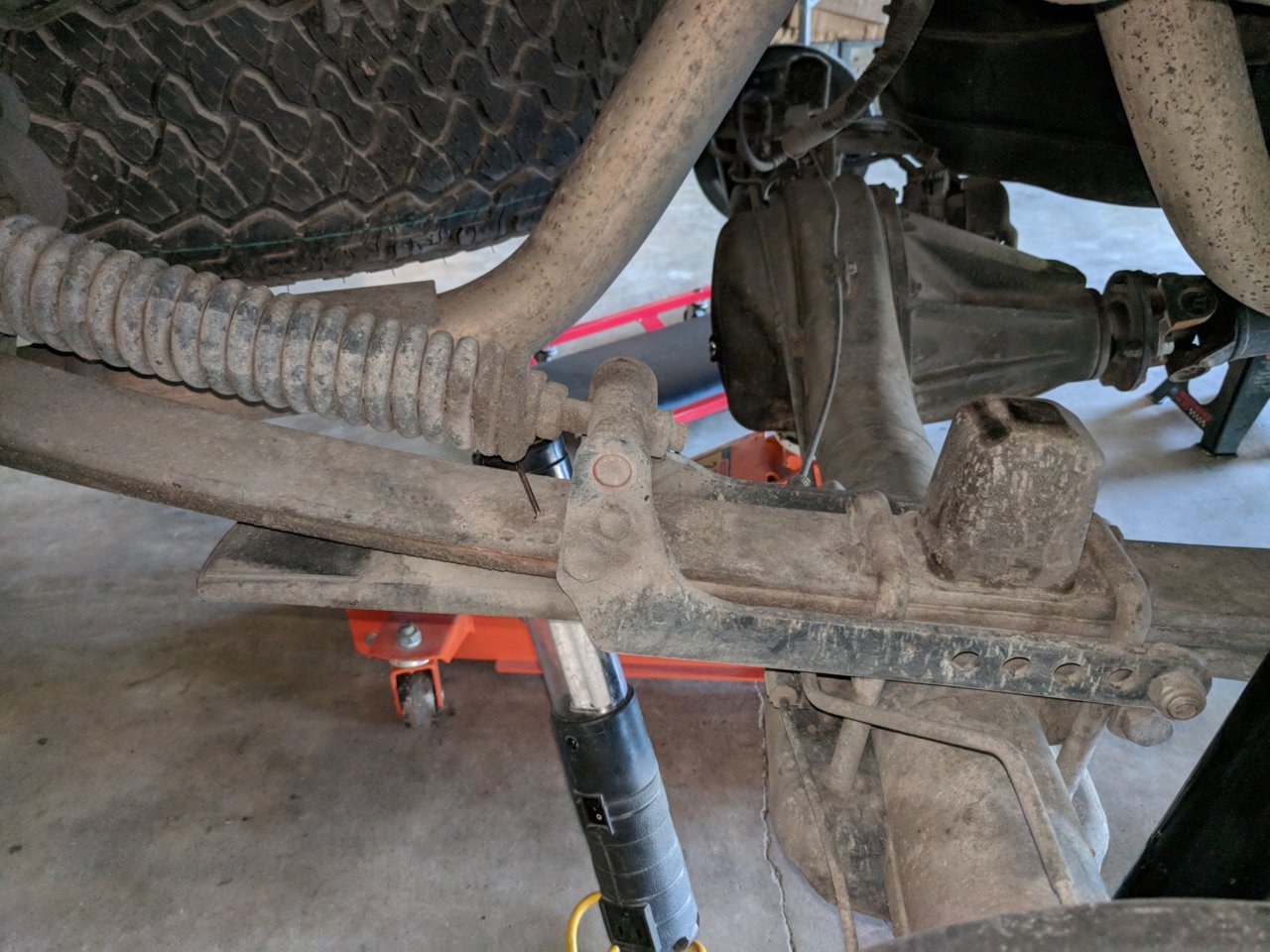

    Here to update on my own thread after having the leaf springs replaced and the reinstall of the Roadmaster Active Suspension (RAS) on my 07. The original leafs springs were a 3 pack and the new ones are a 4 pack. The additional brackets or clamps on the leaf springs caused a little bit of problem. I made a call to RAS in North Carolina for tech support. After their suggestion the RAS went back on with no problems. I decided to adjust the tension spring to the 40% rather than the 25%, which is where I set it back in 2012.
    Now to rectify myself for posting a Ford rear end on Tacomaworld, I give you a picture of my Tacoma before the leaf spring change out.
