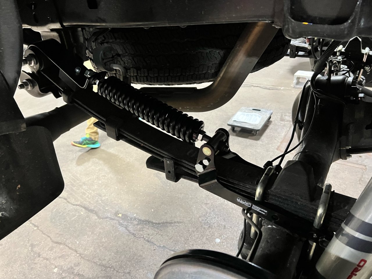

    20200801_105841.jpg 20200801_105836.jpg 20200731_190747.jpg Just a quick thumbs up for this setup on my 2020 SR5.
    I'm towing a 1400lb teardrop camper with additional camping gear in the bed.
    Easy install and setup.
    Great ride.
    Small lift in rear (about 1/2 inch).
    No noises.
    Minimal rear sag with camper.
    Much better performance than my 2016 SR5 with Firestone Air Bags and Daystar cradles. This combination rode like crap and eventually leaked.

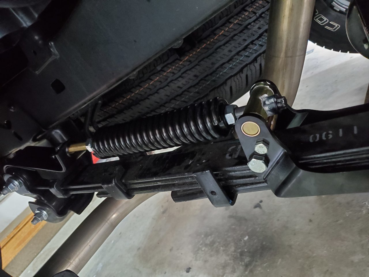

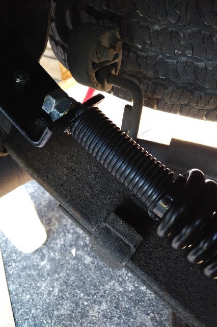

    I just got mine installed today. I wasn't able to fully get mine fully tightened to fit the black disk, because I ran out of threaded rod.
    Did you use the far most mounting hole, or did you use one of the holes closer to the spring assembly? From your picture it looks like the far most hole?

    It was difficult to get my head inside the wheel well but here is the pic.

    Hope you can see it. I'm on the 3rd hole in from the end.

    One suggestion. I covered the exposed threads with some black split wire loom to protect them from corrosion.

    Yes! I see that. Will definitely open up space. I will adjust mine as well!
    Thanks for sharing.
