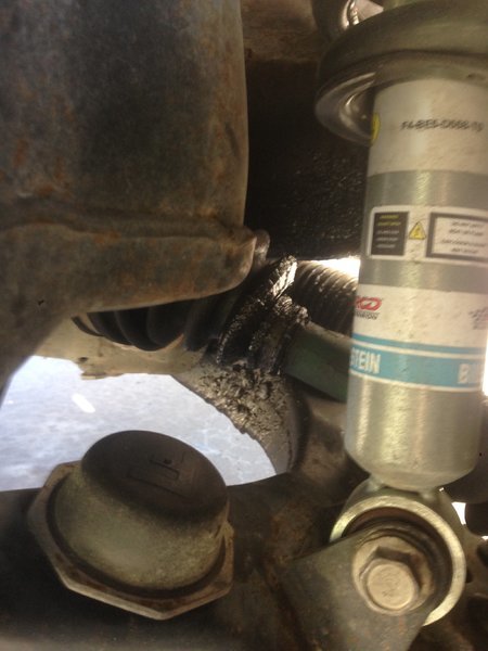

    Torn my inner CV boot on the driver side. I thought it could have been because higher angle which make the fins rub and wear down more quickly, but it tore right above the outter clamp... slung grease everywhere.

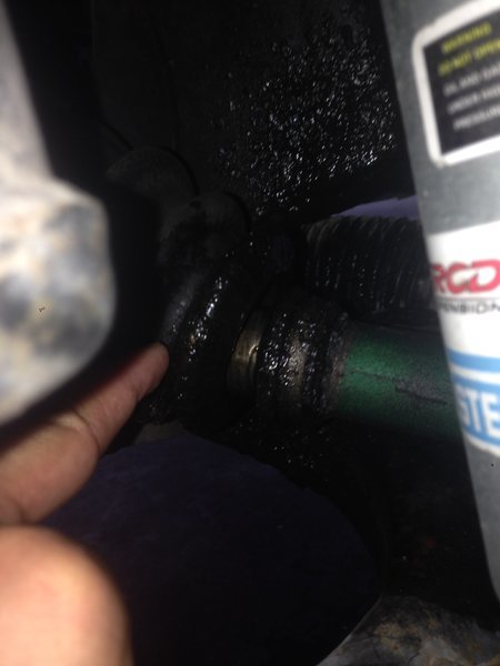

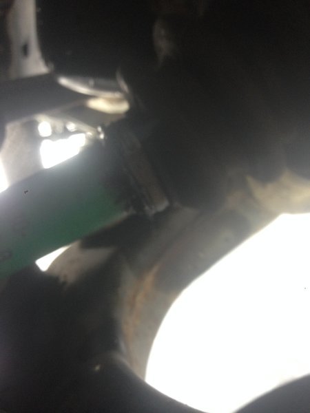

    Took it to my good friend to reboot and noticed the passenger side inner boot was also leaking....

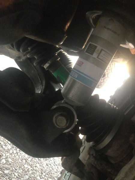

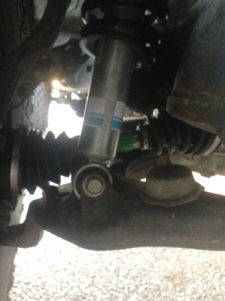

    Here is my new Toyota factory boots with the CV Boot mod!! (Used the old rubber from the boots for the mod).
    11/22/16
