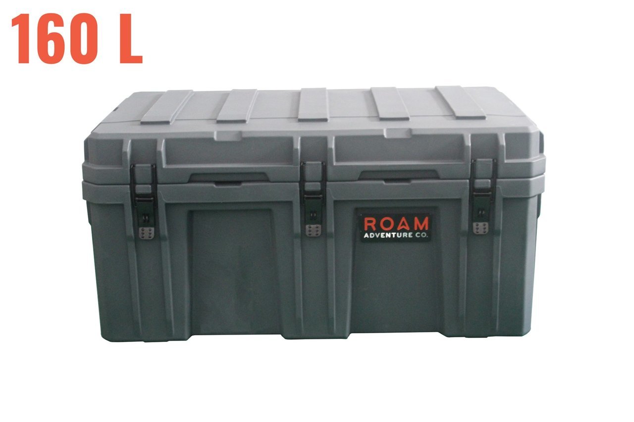

    So I recently purchased this rugged case.
    My plan is to secure it to the bed, almost like a tool box.
    I emailed the company that makes them and they weren't really sure.
    I was thinking maybe drilling holes into the box itself that go into the bed and putting long bolts with lock washers on the underside of the truck.
    Any ideas?

    use fender washers in the box & the bed. consider ratchet straps over the whole box in perpendicular manner, attached to footloops through the bed with the aforementioned fender washers.
    can't go wrong with this ditty " . . . compatible with Yeti accessories . . . " from the website.

    Yeah I was thinking rubber washers in the box to maintain waterproofing, then the steel washers between the box and bed, and under the truck. Wing nuts so I can remove quickly if necessary. In my area, it would get stolen if I made it easy for people. 1/4 hole for the bolts.

    I actually love this idea. But 2 questions, if I drilled them into the channels of the bed with the supplied hardware, would it stay secure, of would I have to go under the bed and put washers on?
    And second, the bolts they show on the site that go into the channels wouldn’t be long enough to go up into the box. Unless they have longer bolts that I’m not seeing

    You would go under and install the tracks, but it would be a 1 time install kind of deal.
    And yeah, I went and looked at that case. That casing is super thick.

    I don’t mind keeping the track in there. Especially if I gain tie down points for the future and if it sits flush between the bed groves. And I don’t have measurements for the thickness of the box. But if I can get a bolt that goes into that track and fits into the box to bolt it down, I’m sold.

    Well if you do (ext height - int height)/2 it says about an inch think.

    From the build, I am satisfied with the box itself. Nothing crazy but for the price I think it’s great especially compared to those boxes in the 5-600 dollar range. My only issue is, when opting for the gas lid struts, they don’t come assembled to the box, have to install them yourself. Which wouldn’t be that bad, but they use rivets. Which now means I have to go buy a rivet gun. Just more hassle then I expected.

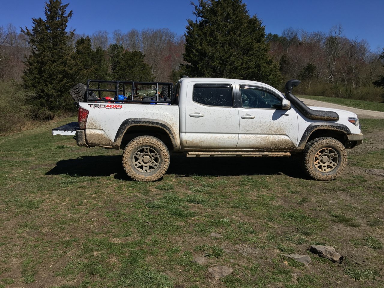

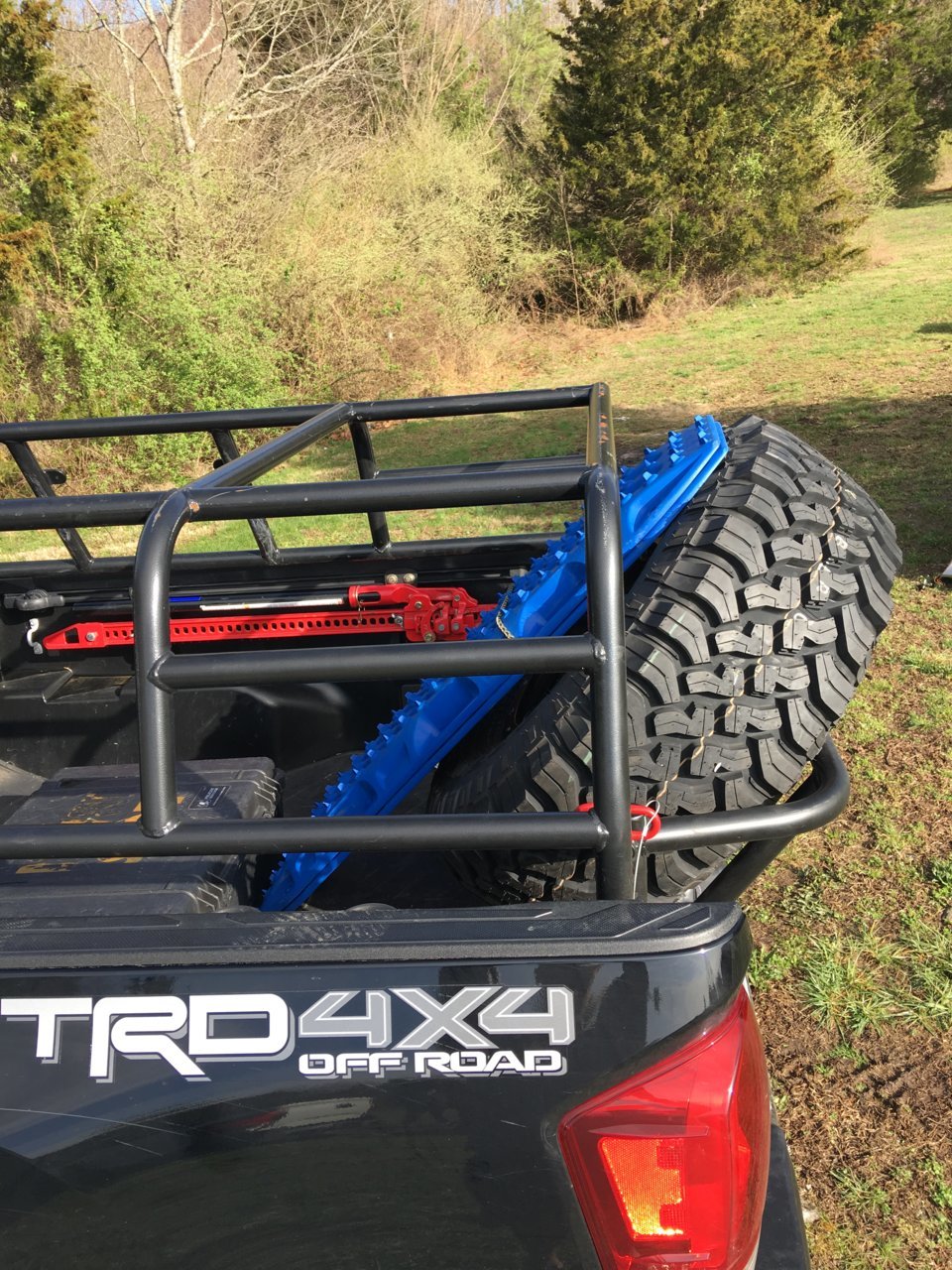

    I see. No wasn’t stolen, I was using my rack/tire carrier when we went to TN for a wheeling event. Ended up giving to my baby brother for his birthday gift, and drove home without mine since I don’t use it with the carrier.
