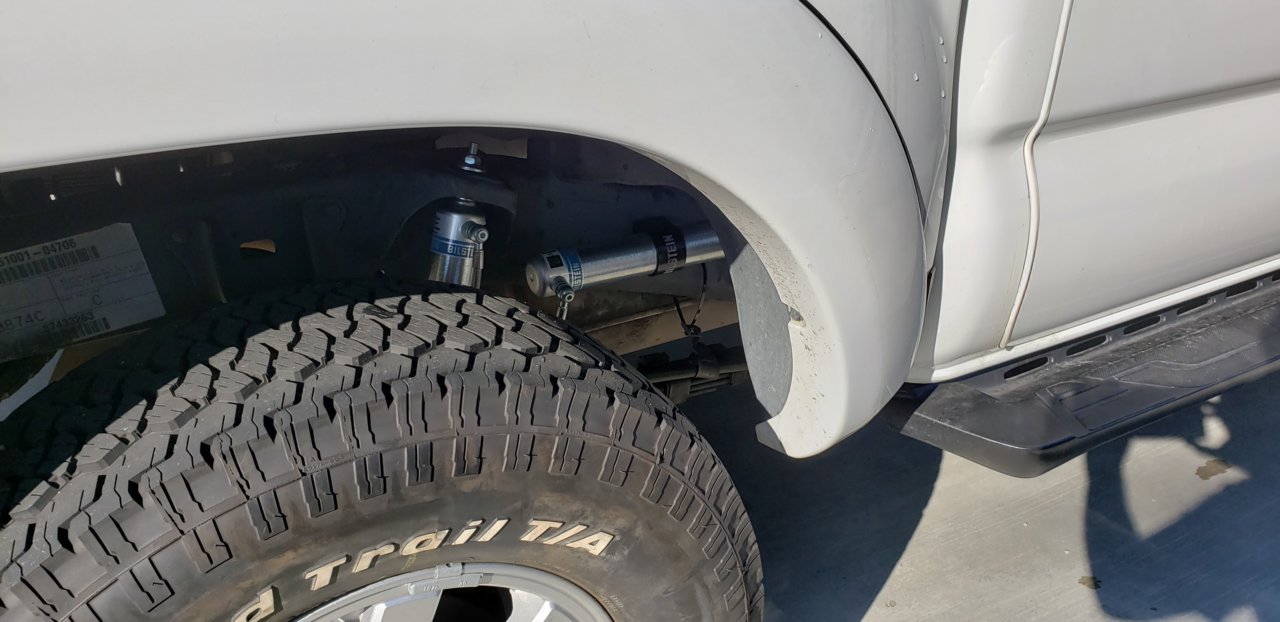

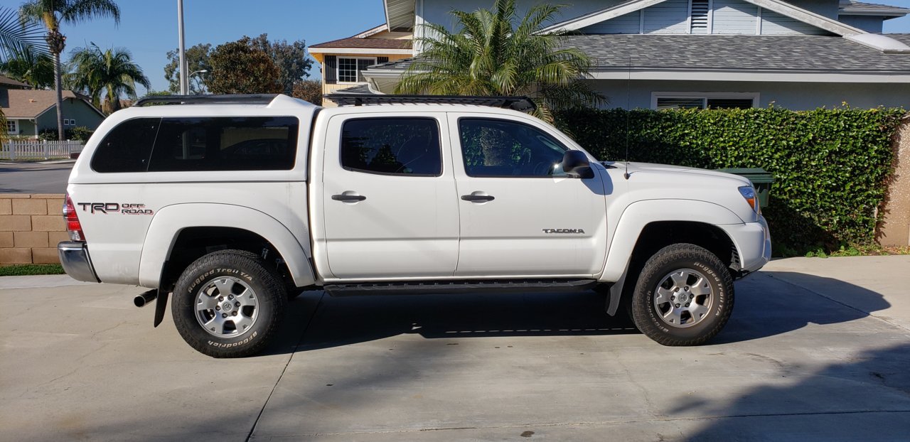

    So added my lift 6112 in front 4th notch 5160 with icon aal in back. Both sides level front and back, but drivers side 1/2 lower both front and back than passenger, what do you think?

    Did you see a lean on the rear before install?
    If it doesn't settle down you can do the 1/4 inch front spacer.

    Yeah already ordered it from headstrong, really notice the lean when headlights hit a wall

    What did you do with the brake line bracket

    Zip tied mine right now

    What size if I don't wanna chop, thinking bfg KO2, or maybe Toyo open country, or Nitto ridge grapplers

    I was able to use the existing bracket for my brake line.
    265/75 should be fine and clear. Toyos I believe run taller rated size but it would be minor rub if any.
