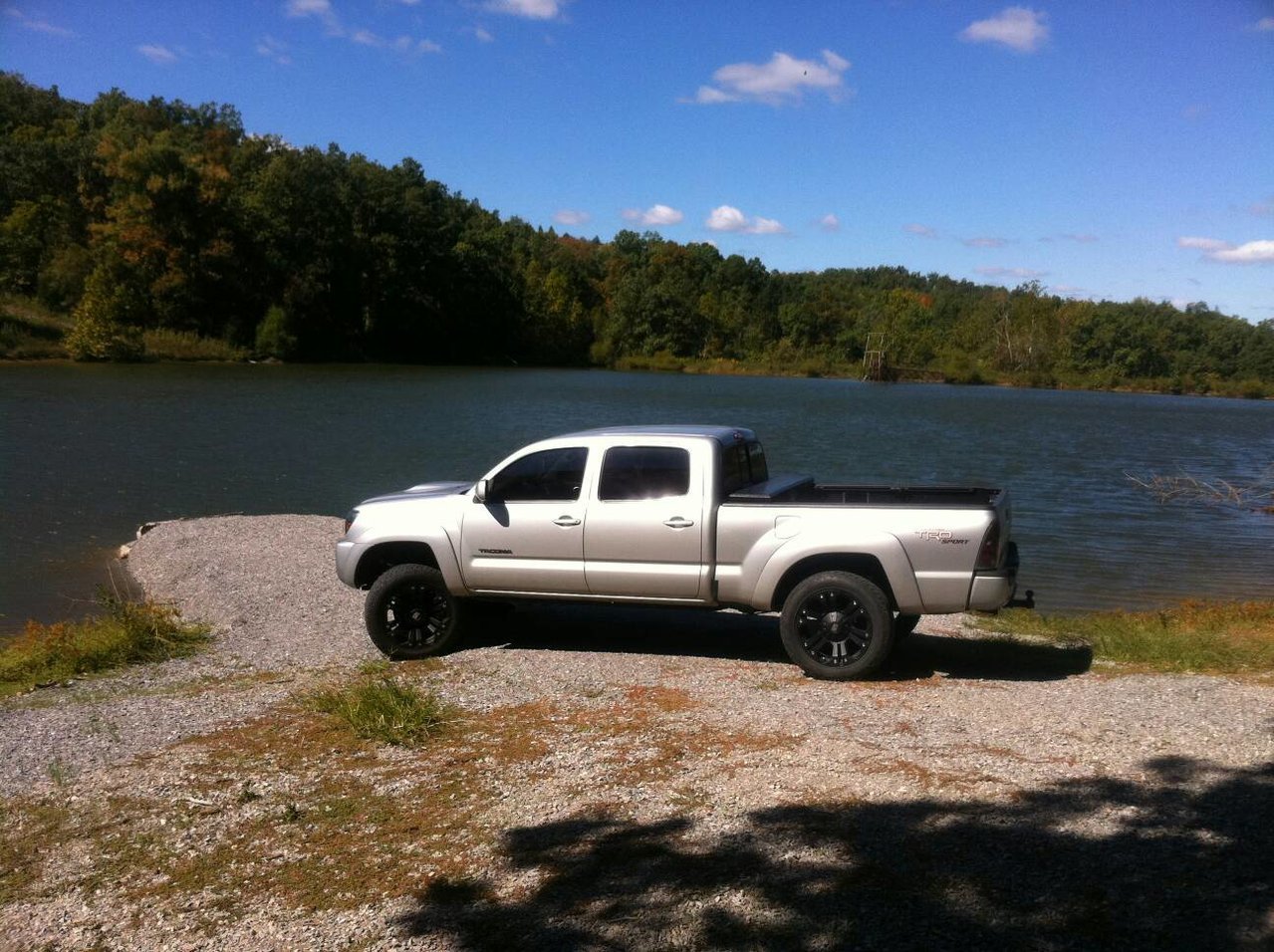

    It's a 2008 dclb sport edition.

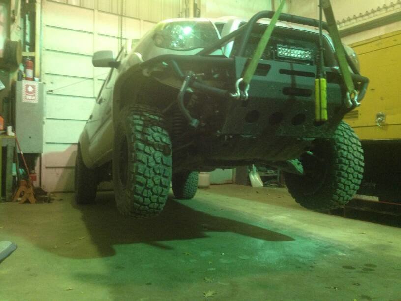

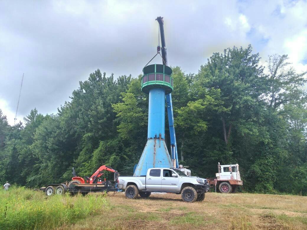

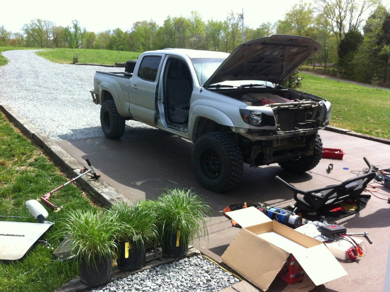

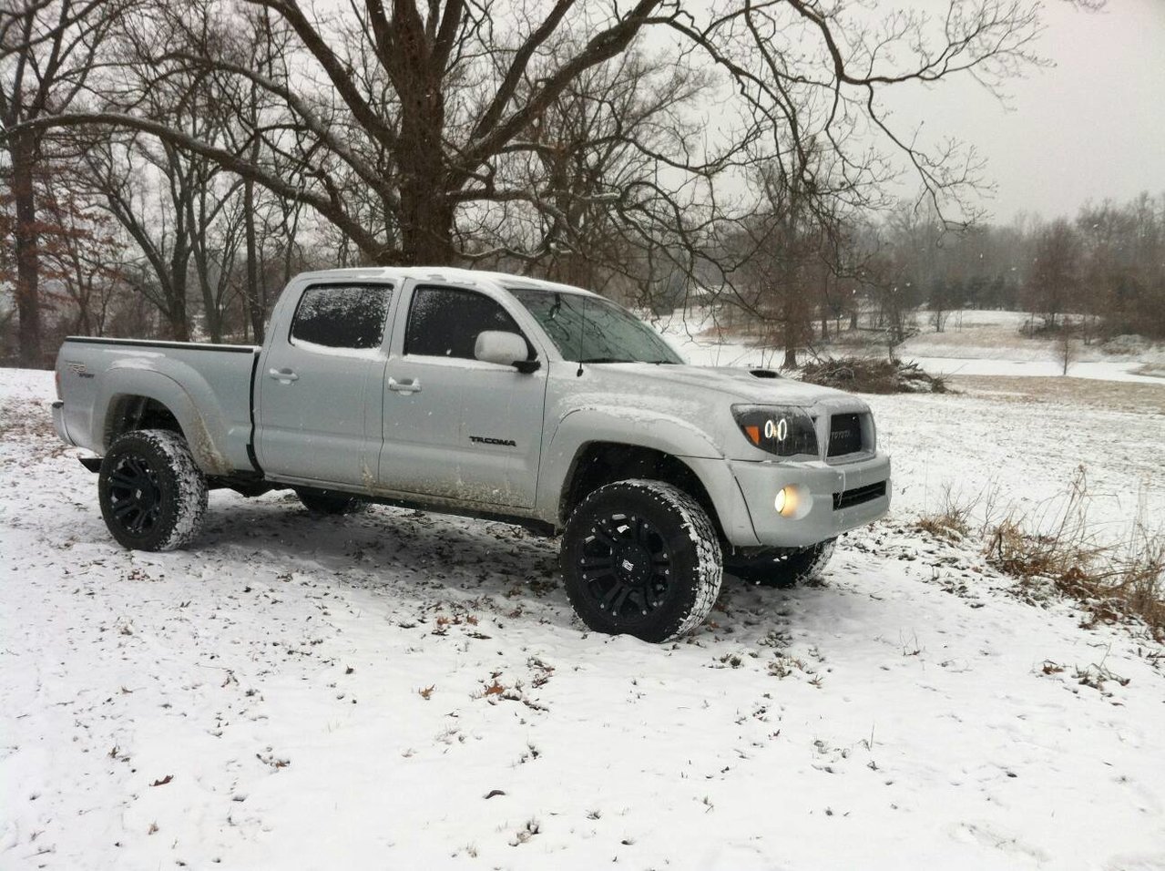

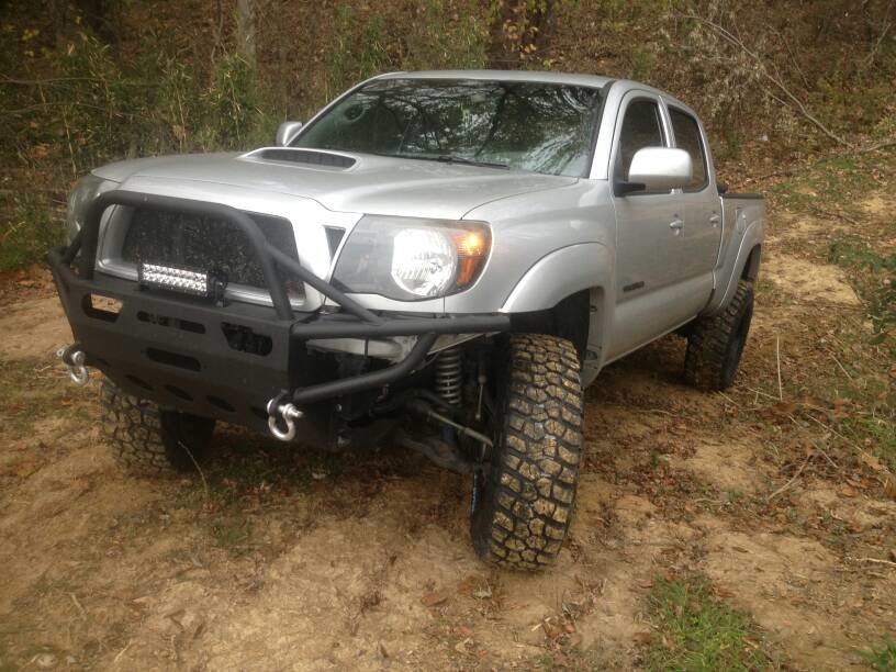

    How she sits today... people who know me will get a laugh...

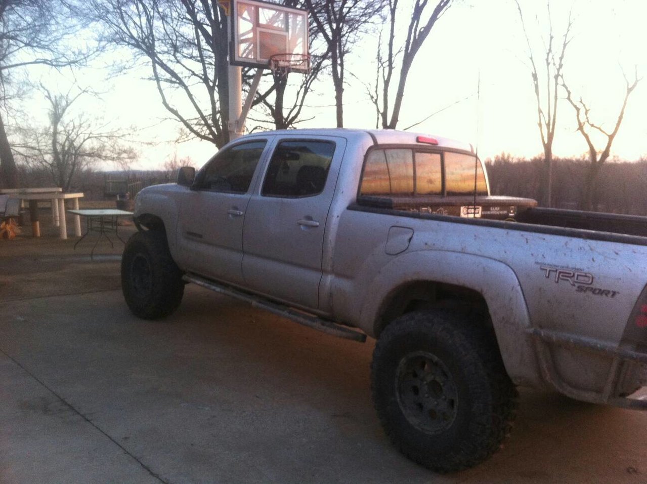

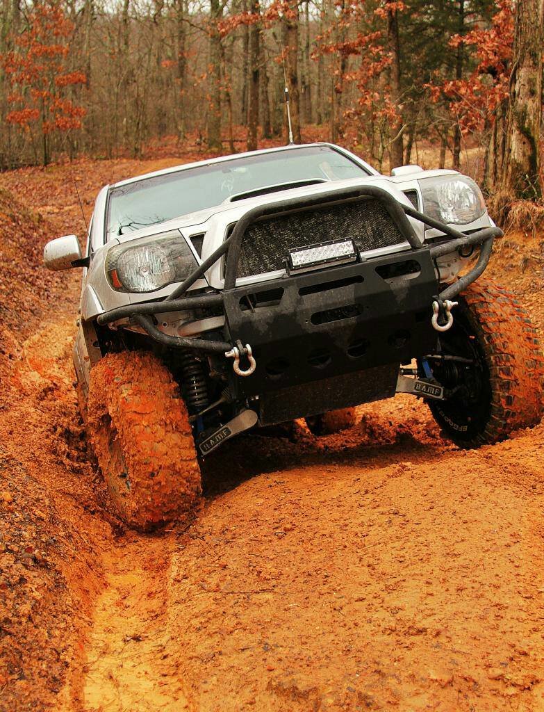

    that's a joke, here is how she sat when I made the build thread

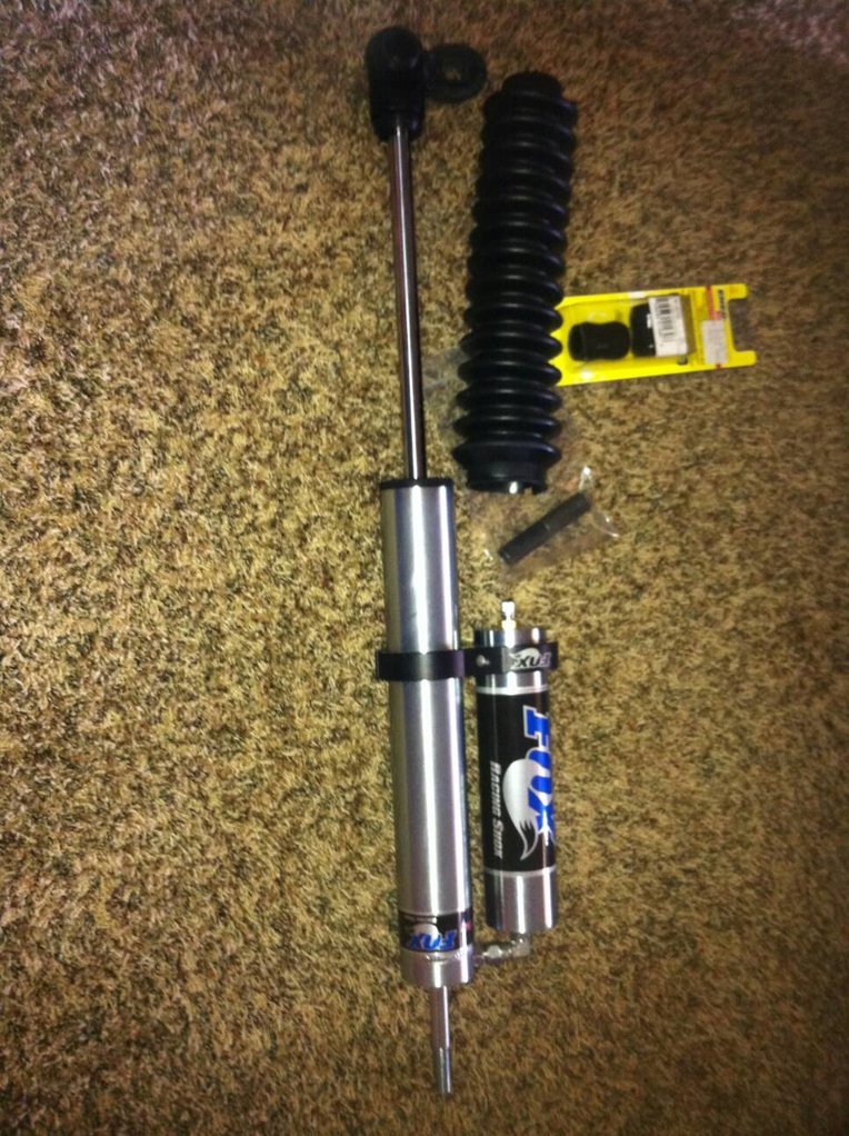

    Next I decided I was gonna put Fox shocks on because all the cool kids where doing it! So I picked up some used Fox 2.0s front and new rears

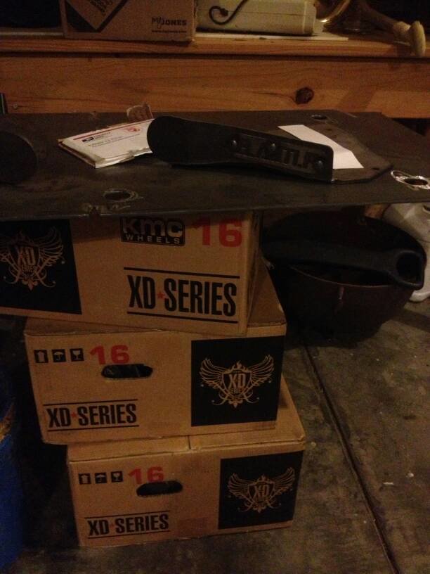

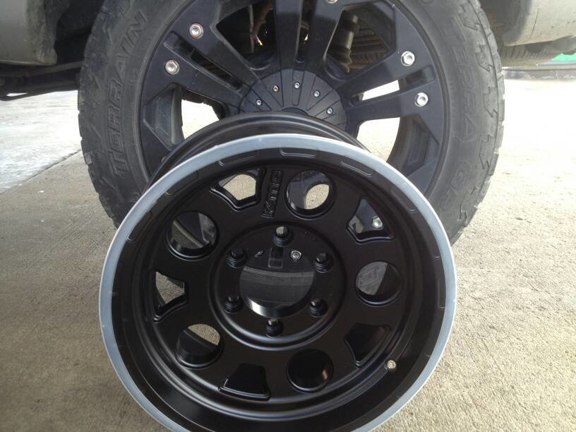

    While I was waiting for tires to come in I picked up some other goodies
    Finally the tires arrived!

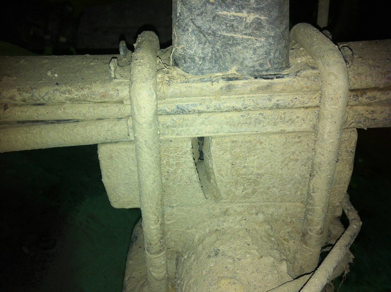

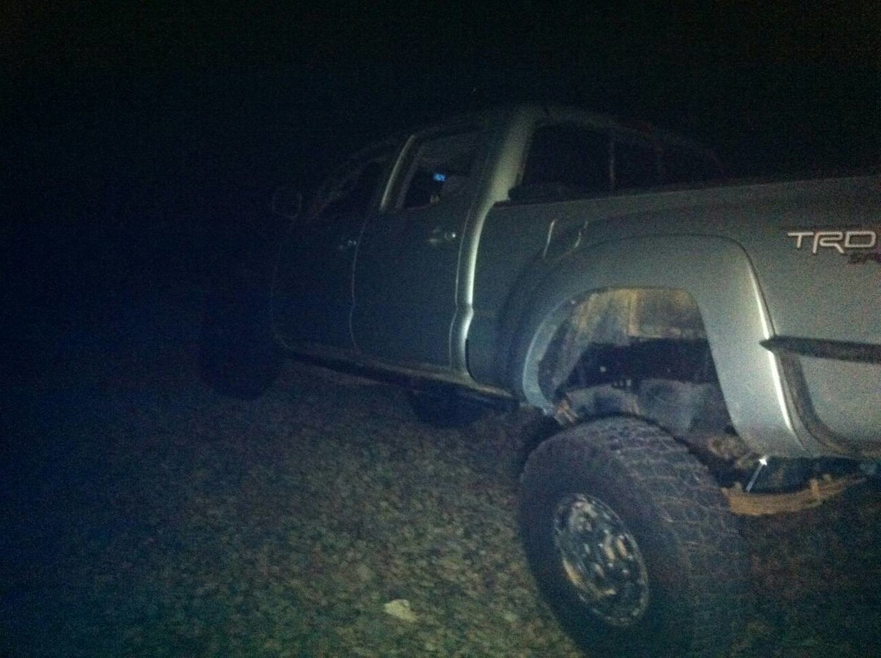

    Had to test out the new tires and while I was out and about something bad happened!
    Damn blocks! Thankfully the night before my first wheeling trip these came in!

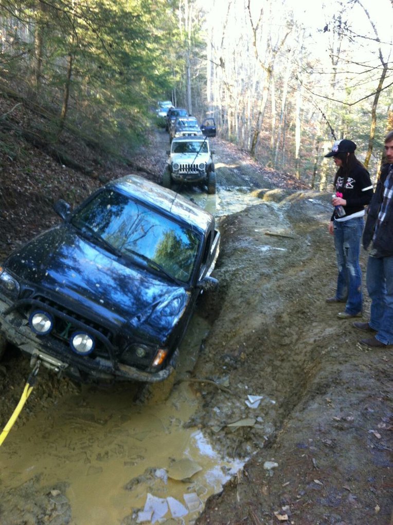

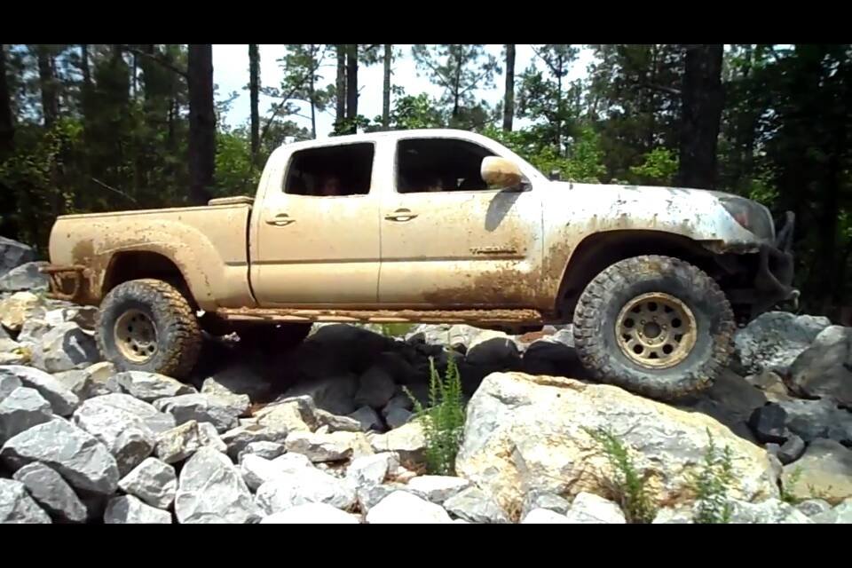

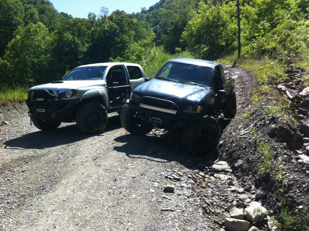

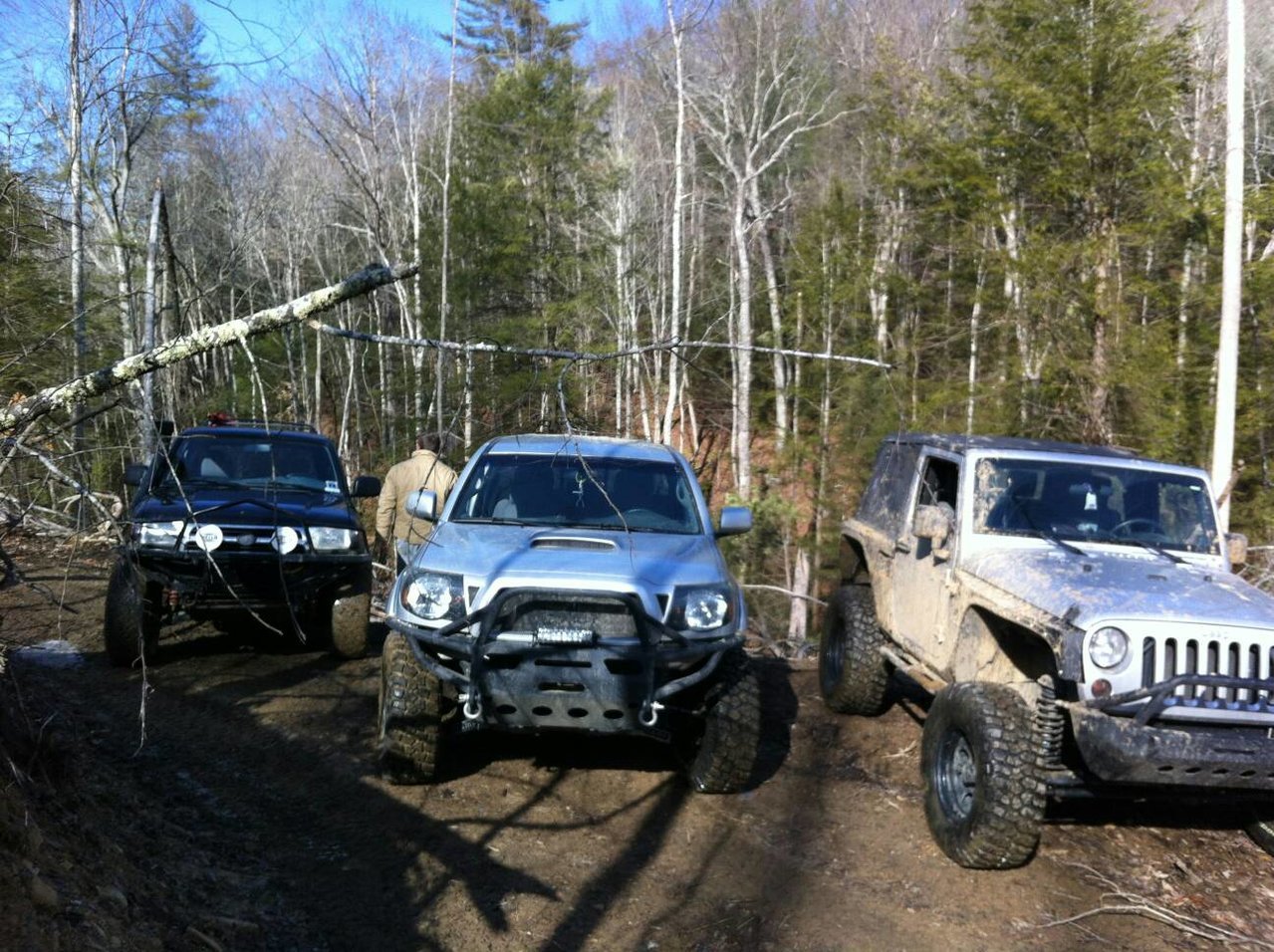

    Then off to slade, ky where I met another fellow named cody (sk8erjess), little did I know how much of a impact he would have on my build!
    Cody got stuck haha

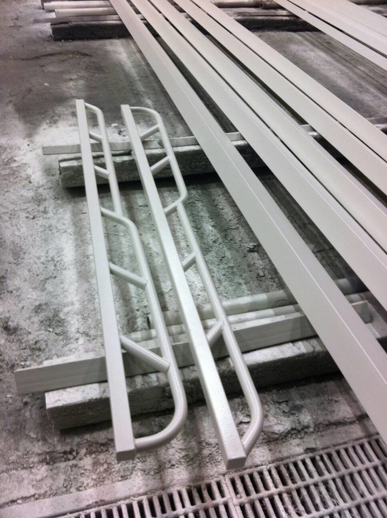

    So after that trip I knew I was gonna need armor so I ordered skids, rear bumper (trail gear), and sliders. Waited for ever for them to show up. However bamf had a quick delivery with is lca skids. Then the next off road meet came and it was a blast.
    After the meet I got camburg ball joint uca and the sliders showed up

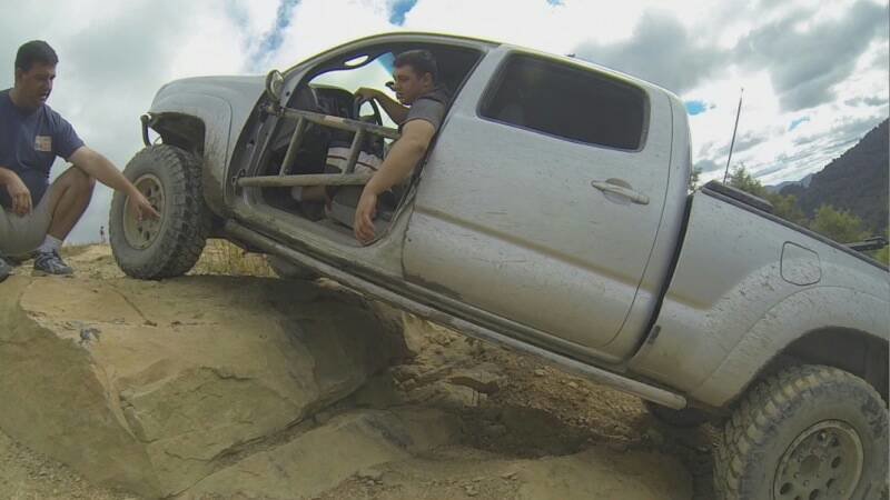

    Then I got bored and cody suggested tube doors, so why not?! Also picked up an engo 9000 winch on sale so it turned into a mini mod day
    Then cody and I decided to go to Harlan Ky.
    Decided I loved it there and the Tennessee thread decided to have a meet there in the fall. So time to collect parts.

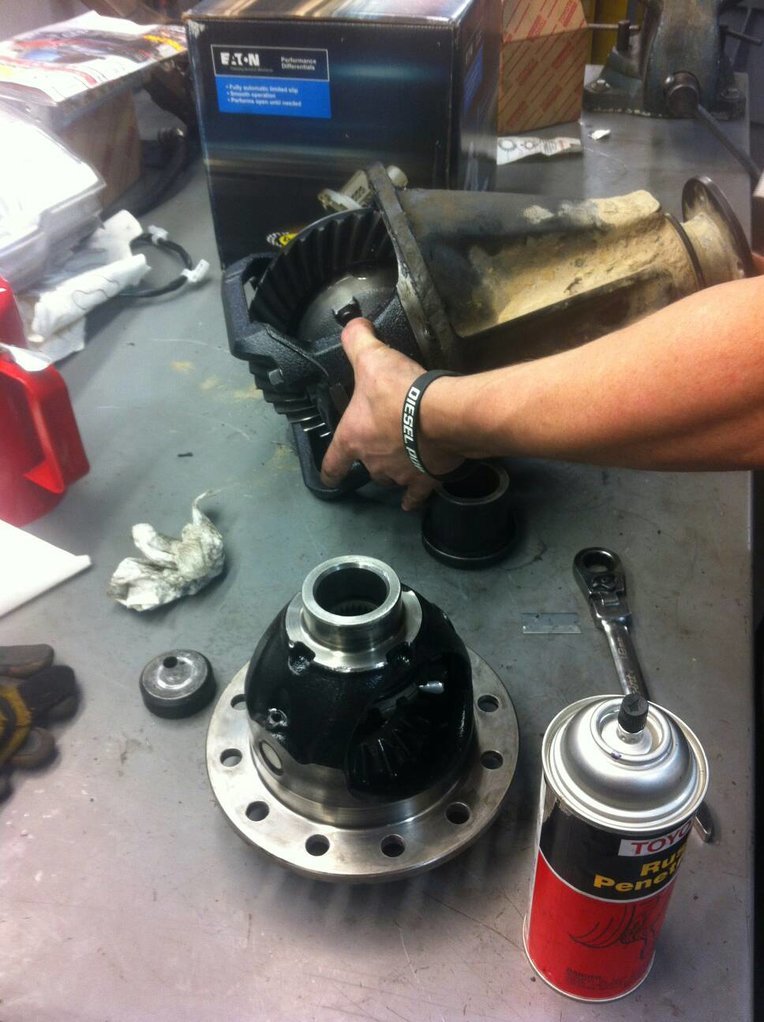

    When I got back from the trip ordered my Detroit locker.

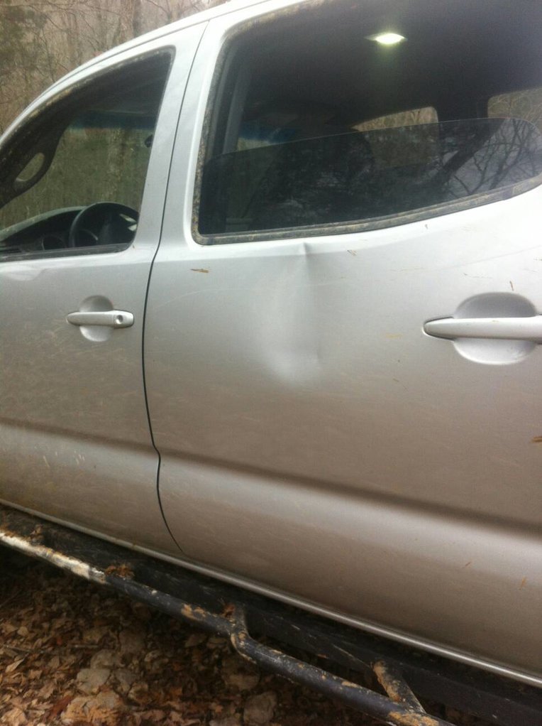

    Got it installed and was in a hurry to try it out. So I went to wishbone ranch in bowling green.
    Decided I liked a tree to much so then all bets where off time to get to business so I ordered 35s. And day I put them on got to put them to the test to go pull out a buddy. Didn't get a pic of the recovery though :(

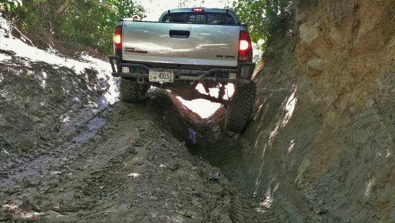

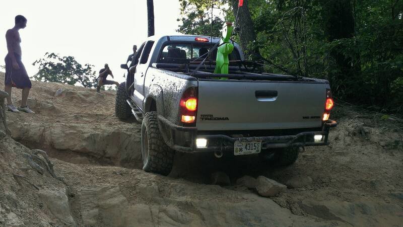

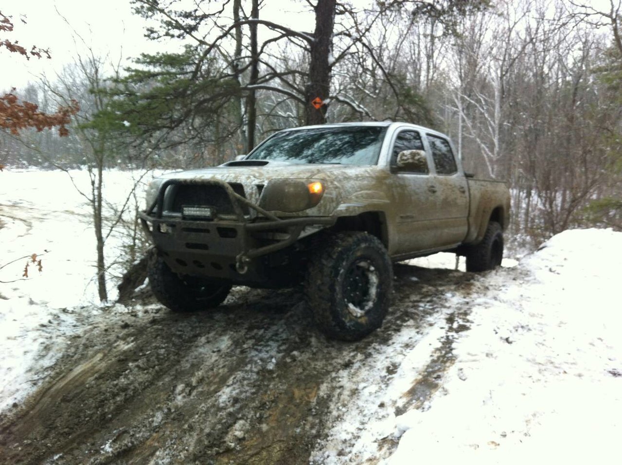

    Then went to Turkey bay to give them the test.
    Had fun so memorial day Gideon and I went back!

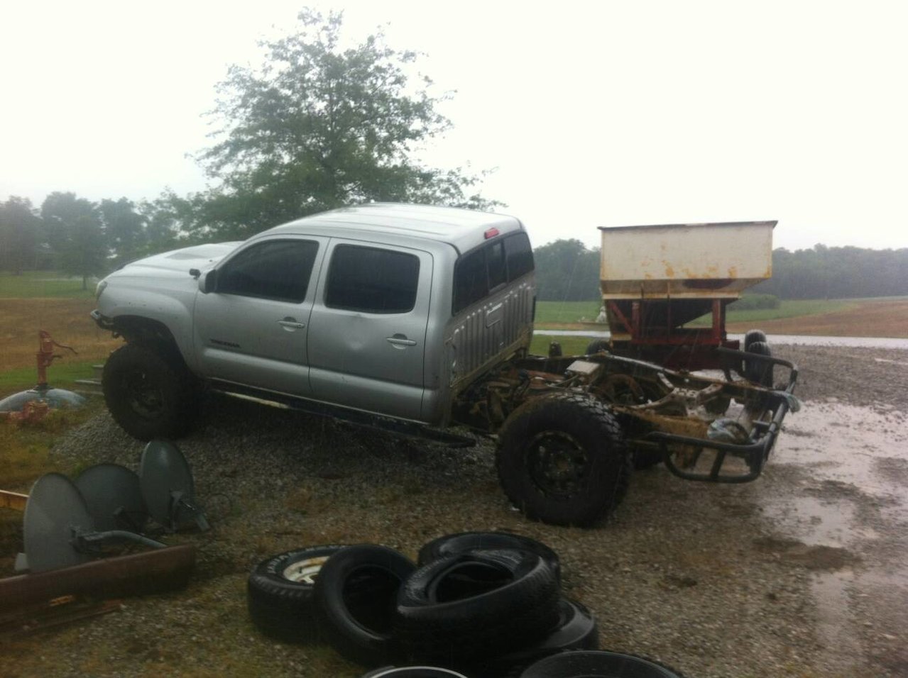

    So I ordered a shackle flip kit, and some 4" shackles for a jeep. Decided I was gonna tackle the project about a month before Tennessee's fall meet.
    Figured taking the bed off would make things easier.
    So I started on taking the rivets out for the old shackles when I was told I would be going to the virgin island for work.

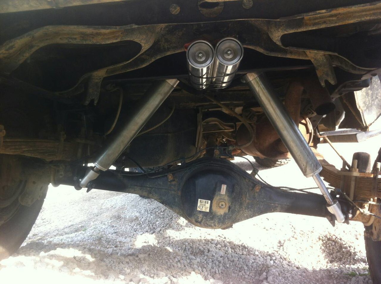

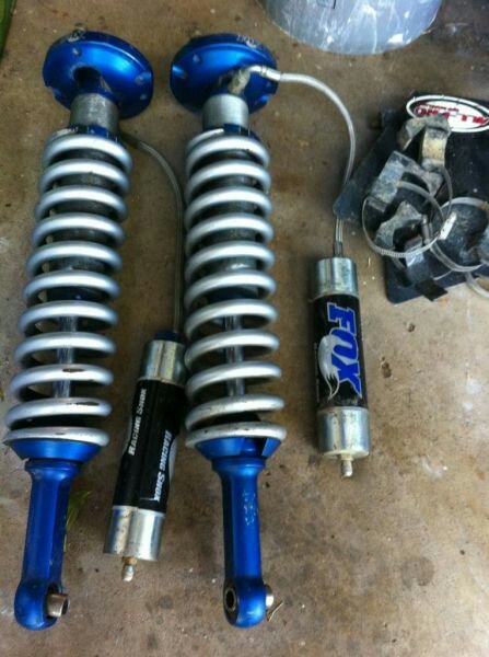

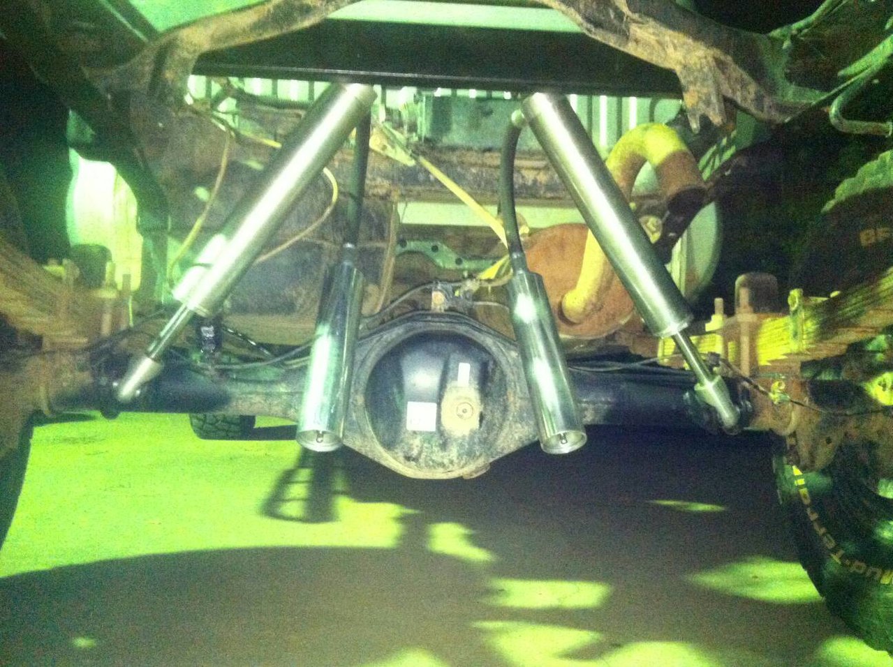

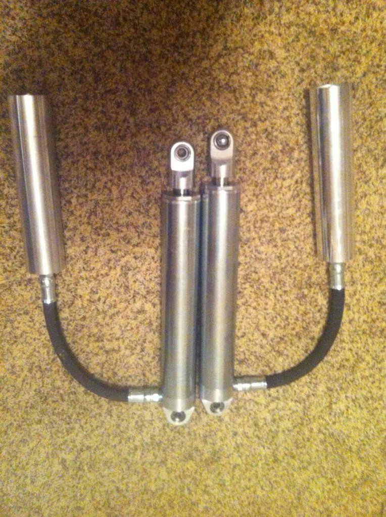

    While I was there I bought some foa 2.5 rear shocks and used front icon 2.5s. Both where sitting at the door when I got home.
    So made some new shock mounts and finished up the rear.

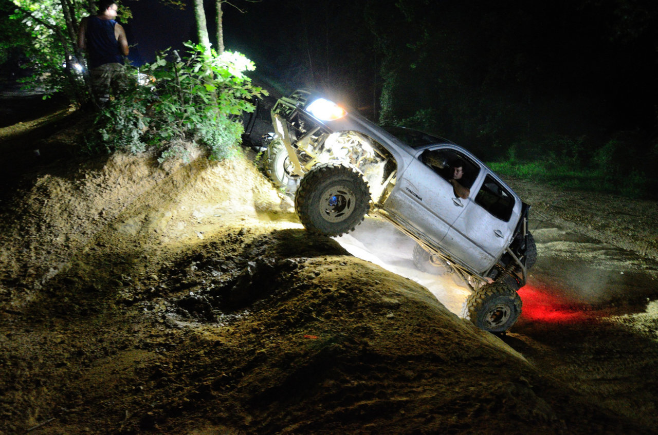

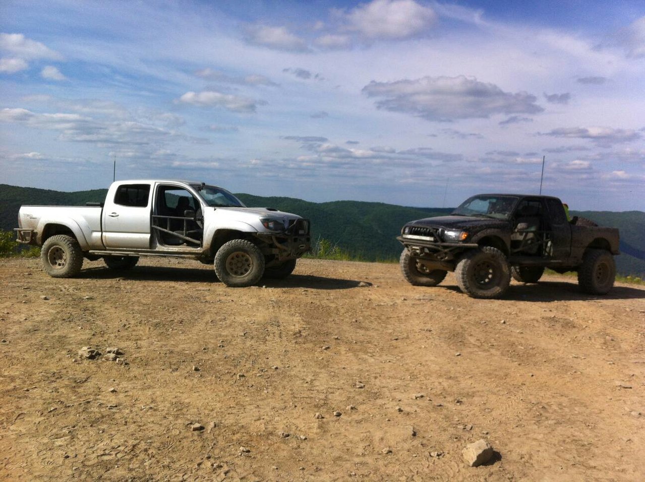

    Then installed the front and had about a day to spare before windrock. Which is the most recent trip. Finally got to test out the new set up.
    Got into a tree... saved the cab, bed picked up a new dent.
    And then... drum roll please...

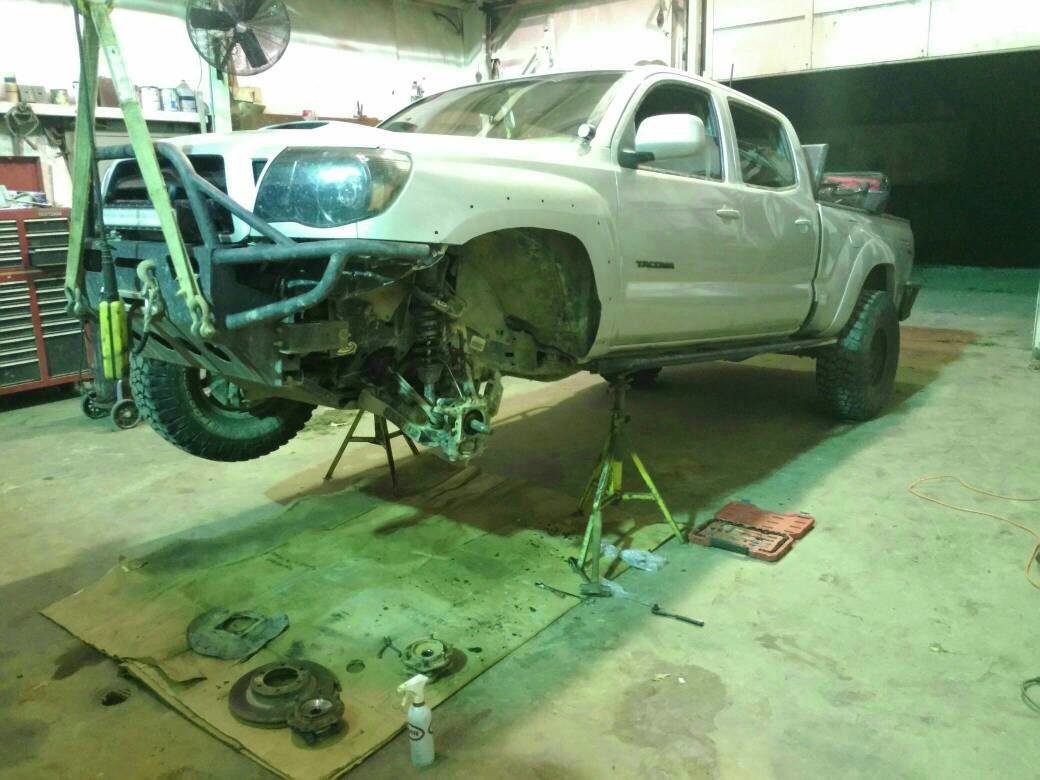

    Bent my tie rod right as night was setting. Thank you everyone who helped! Got it fixed and made it back to camp about 11 at night.
    After the trip a new rack n pinion is needed (leaking and bent), New drive shaft as mine has a nice dent, and my passenger icon needs a rebuild.

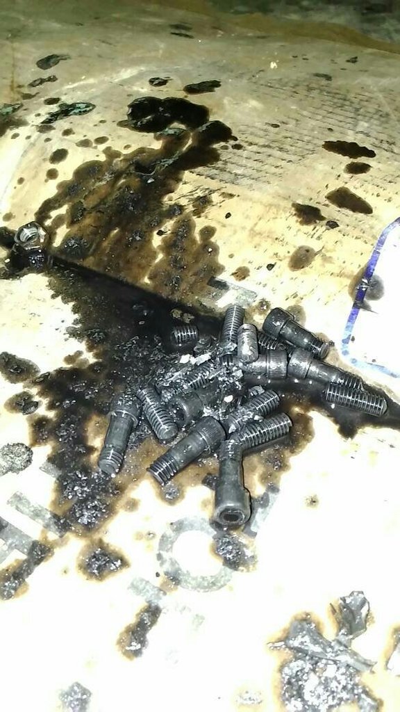

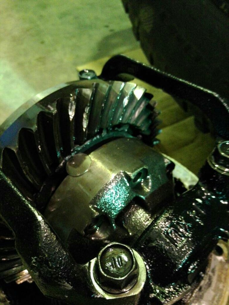

    Then about two week ago on my way home I heard metal scrapping and noticed the drive line picked up a vib. When I got home a buddy came over and we listened to it and then BOOM! Sure enough rear diff exploded...So limped home in front wheel drive and pulled it apart.
    The bolts in the Detroit backed out... and they where not messed with during install. Only thing I can come up with is Eaton forgot to put loc tight on the bolts... either way they replaced it and the new diff is waiting for me when I get home.
