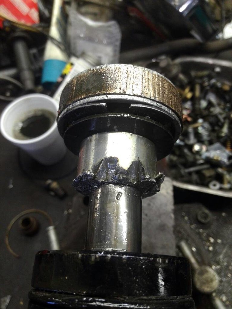

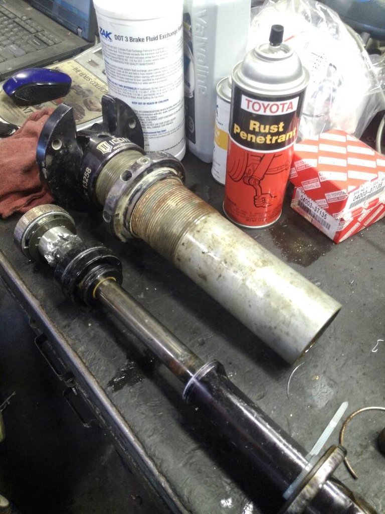

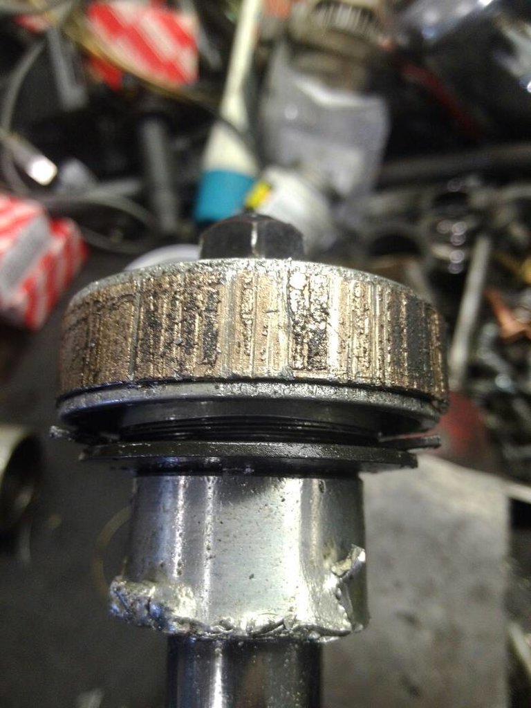

    Speaking of Toyota I went there today and tore down my shock to get it ready for a rebuild. But instead found what looks like a mini explosion happened in the shock. Needless to say buying a new shock tomorrow.

    New and shiny. So far it's been a really easy install until I found out that Toyota didn't give me the right size new bolts.
    You can also see my new bump stops :)

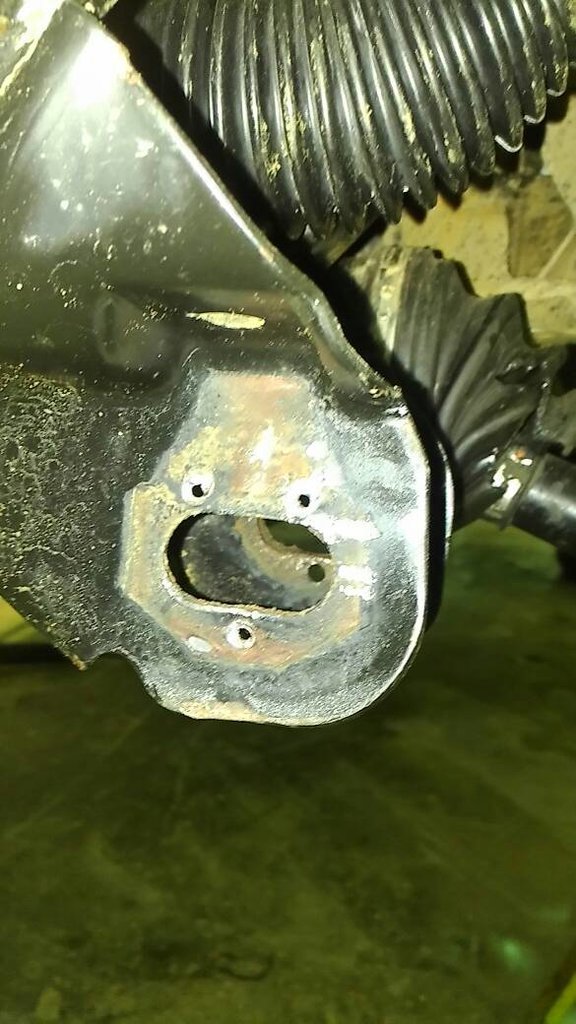

    08 sport
    ATM6969420 series
    Got my cam tabs removed last night then realized that the gas for my welder was out :mad: needless to say bottle will be filled today and this small project should be finished up tonight

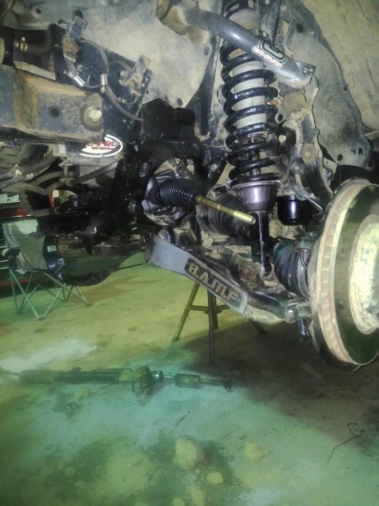

    Off to the alignment rack!

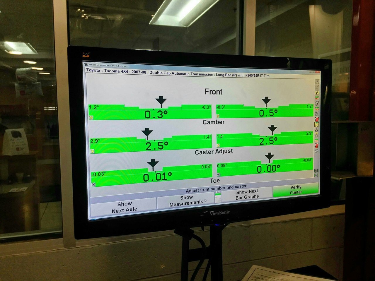

    Alignment numbers!

    Man I wish I could get my caster that high. Best I can get is 1.2

    Those new cam tabs helped out a lot, Todd said it was his easiest alignment by far

    I might need to get some new ones. I don't even have that much lift and can't get my numbers above 1.2 haha

    It was a simple install but between my bent tabs, my worn out rack, and a bent rack n pinion bolt my alignment was horrible before I replaced every thing. Now it's perfect and I have a little over 2.5" on my front coilovers
