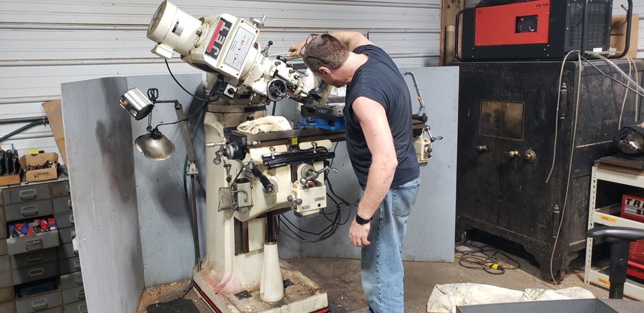

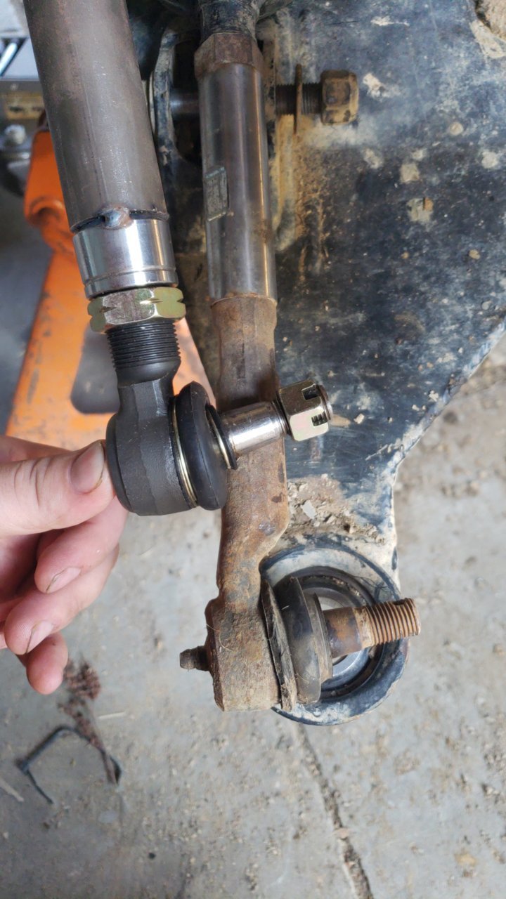

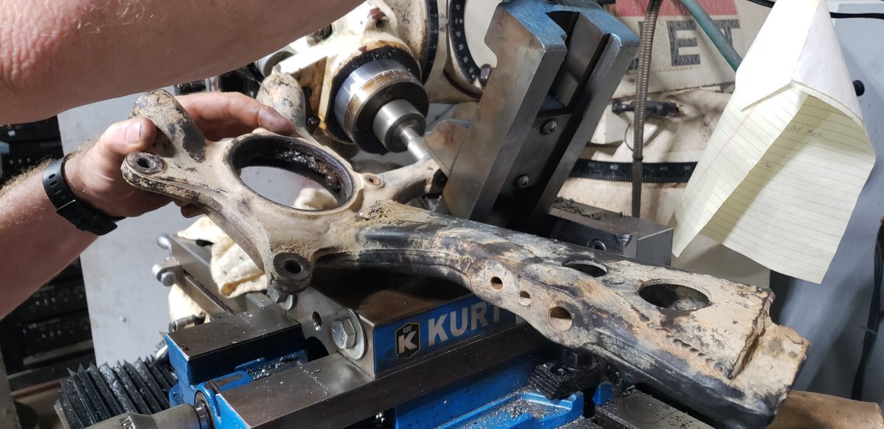

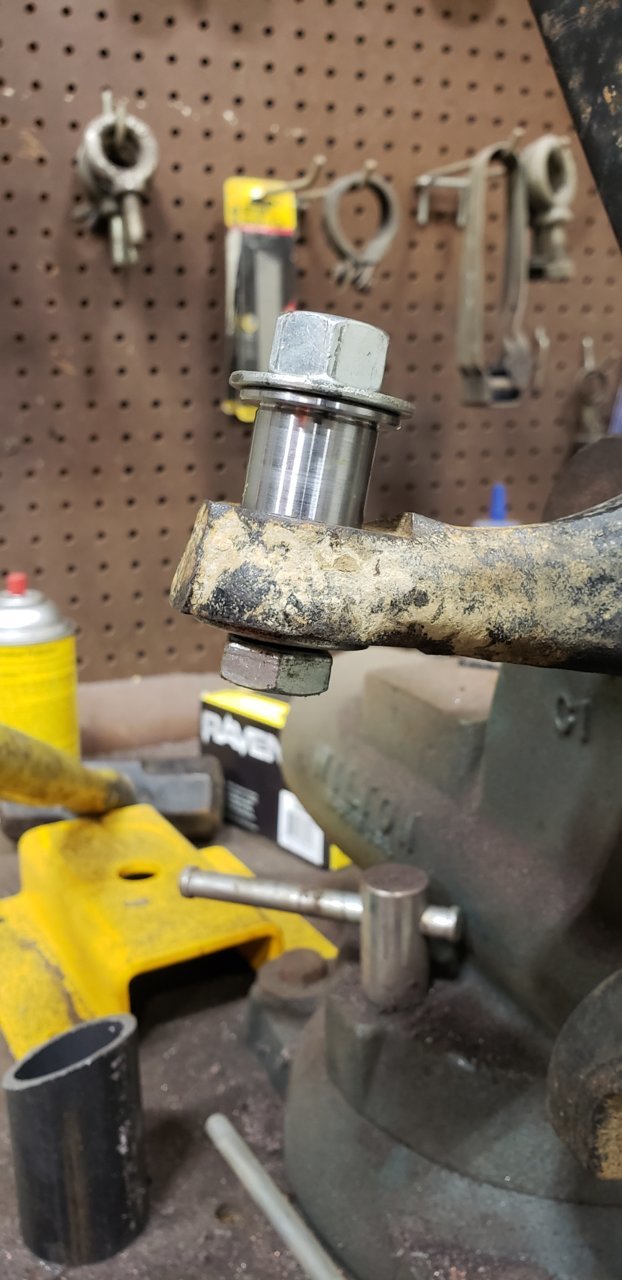

    Also working on a new tie rod set up. Using camburg clevis ends for the rack side, I used 3/4 heim adapted to 1.25x.120 wall Dom tube to another tube adapter and fj80 tie rod end. Of course there is a different taper between the two ball joints. To fix that my dad and I milled the spindle out to .850 and I'm going to have a machine shop make a bushing that will press into spindle and match the new taper.

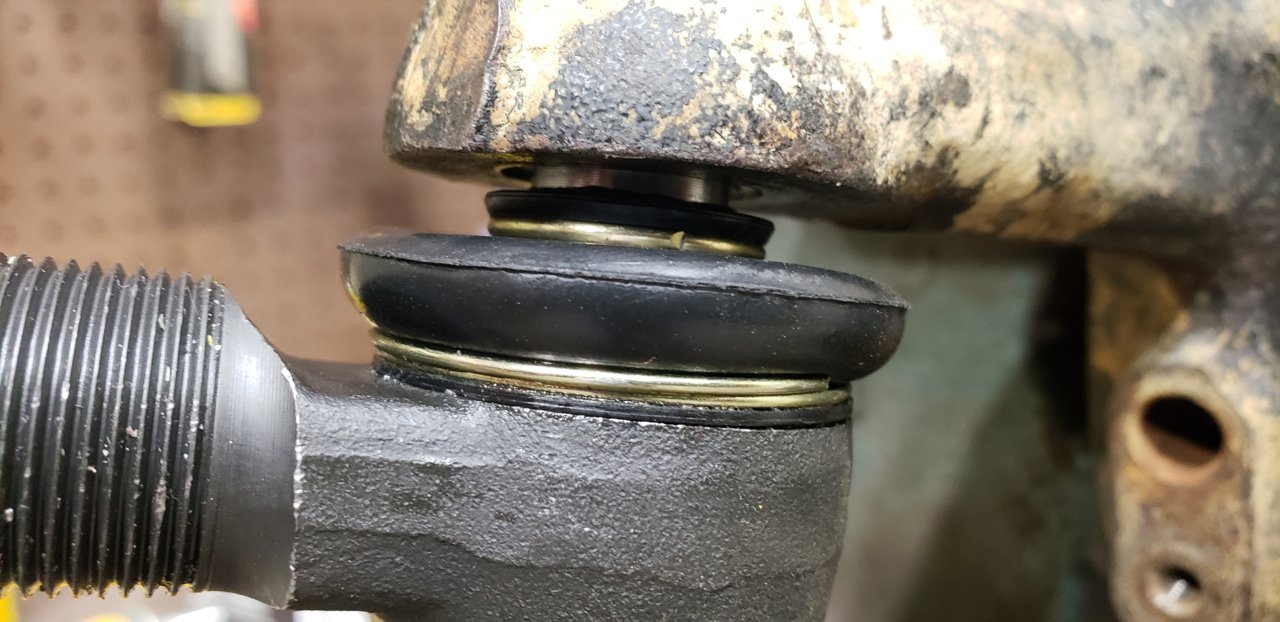

    So update on the steering. It's basically finished and waiting to go together this weekend.

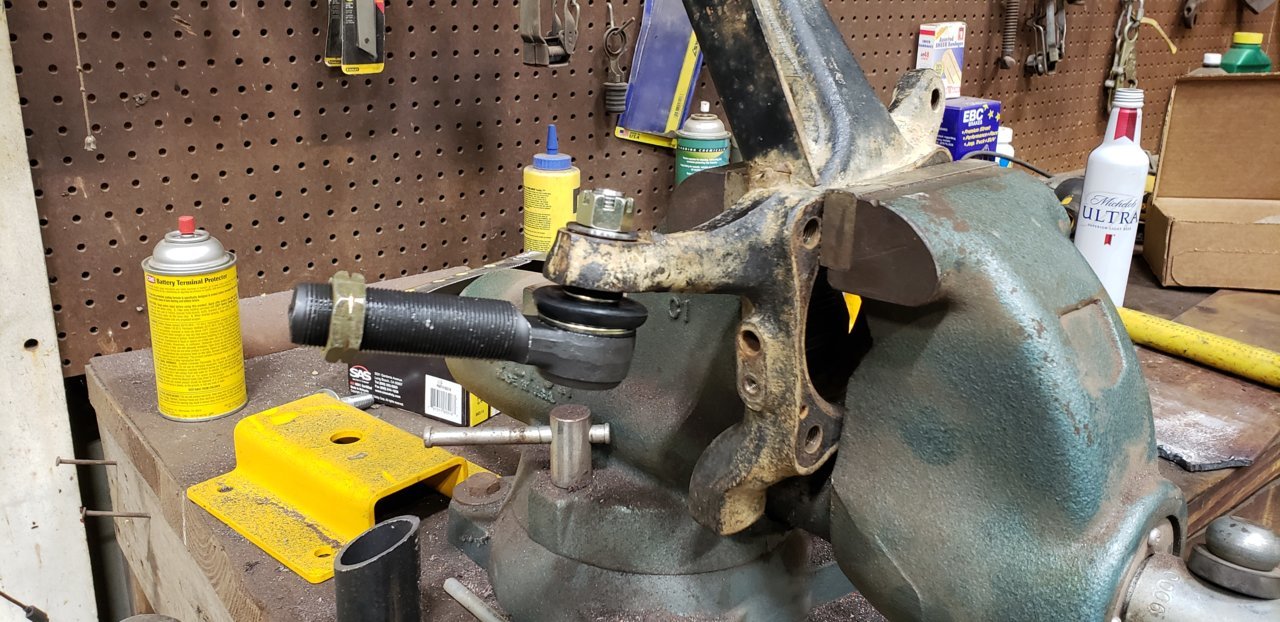

    Had the shims made today and came home to install them. Here is the ball joint fully seated.

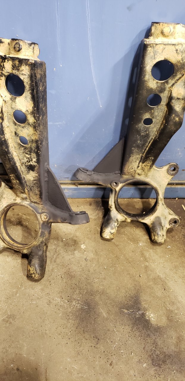

    Then I decided since the spindle was off might as well add some more gussets!
    Do I'll show finished product this weekend.

    That is super beefy fella, holy moly!!!! Could you throw us a comparison pic? New outers vs old outers.

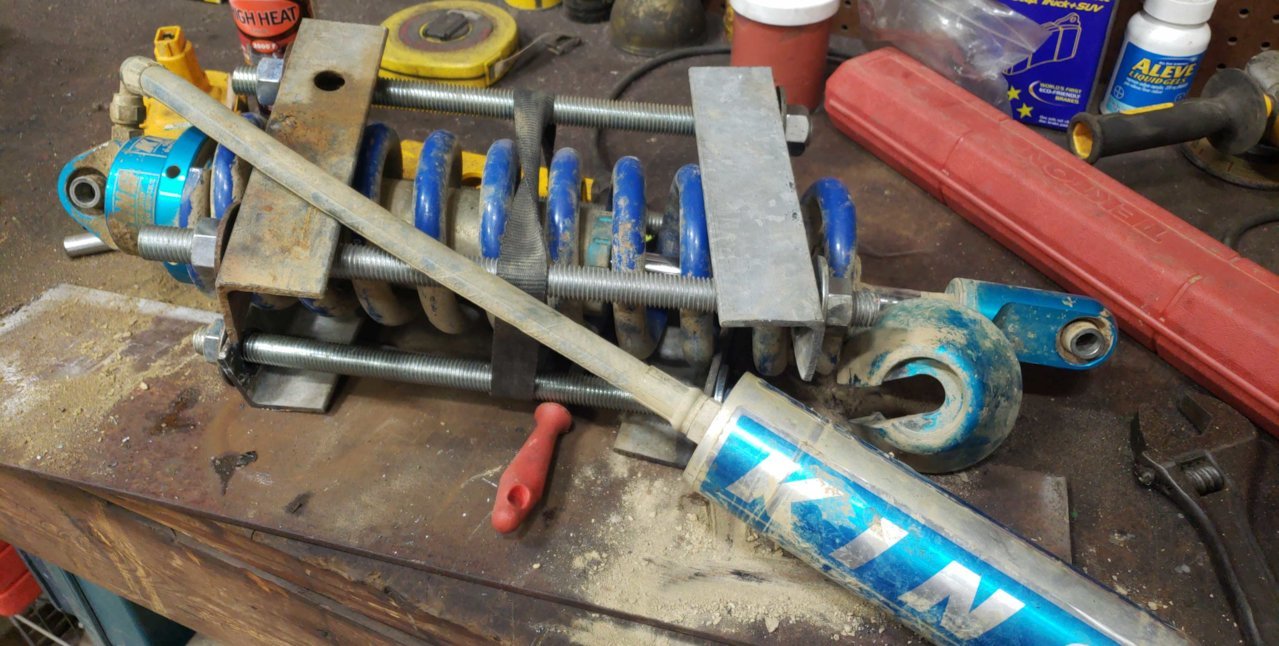

    Some more good shit. Got my lower uniball put in and then took the shocks off and made a spring compressor!

    Looks waaaaay better than the parts store rentals. Haha

    It is haha I never really got nervous using it like I did when I used the parts store rental

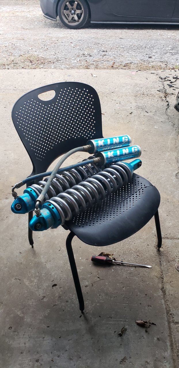

    Got the new coils installed. Hoping with the new coils, new lower uniball installed, and new tie rods this thing handles like a new truck. Time will tell here shortly! 20180921_181834.jpg

    Got tie rods tig welded. Had to order a tap to clean up the fj80 threads, and that should be here Friday.
