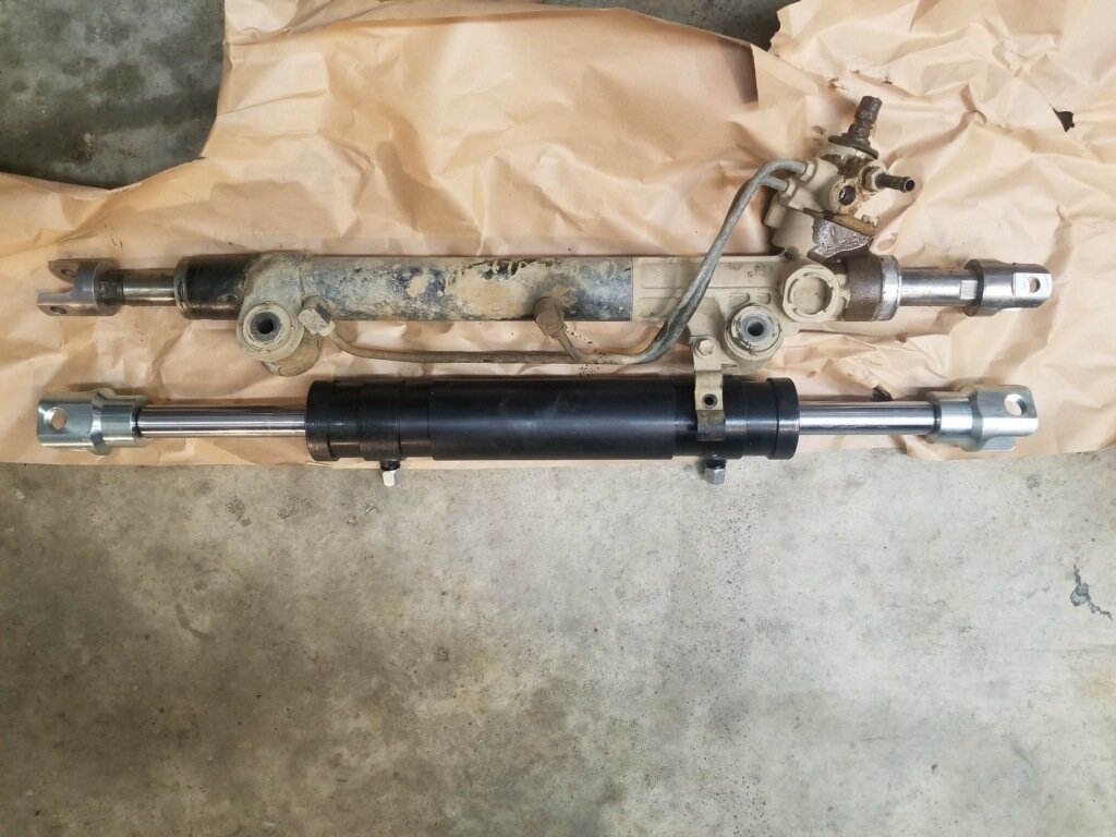

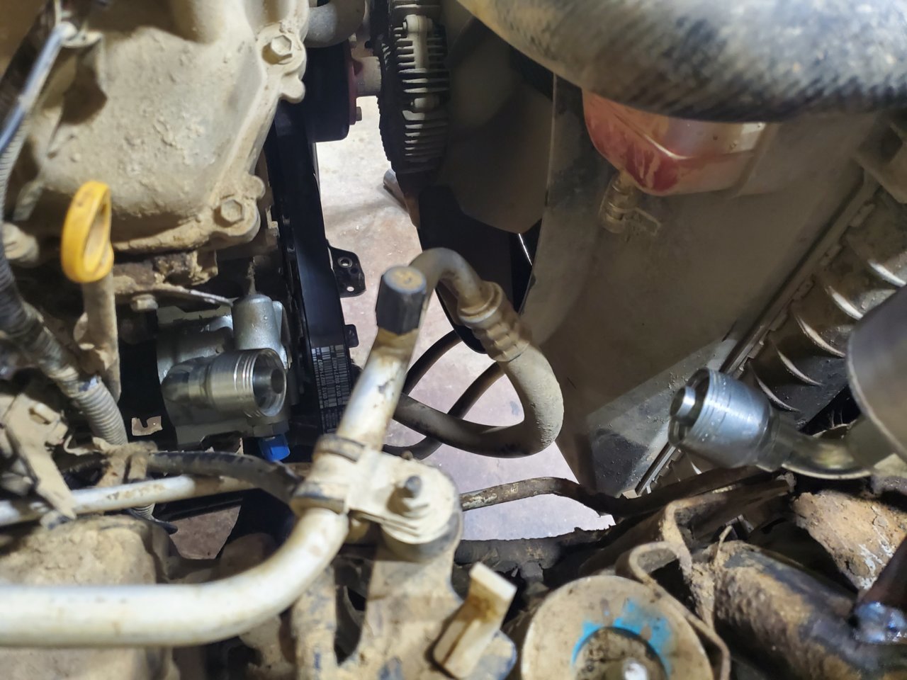

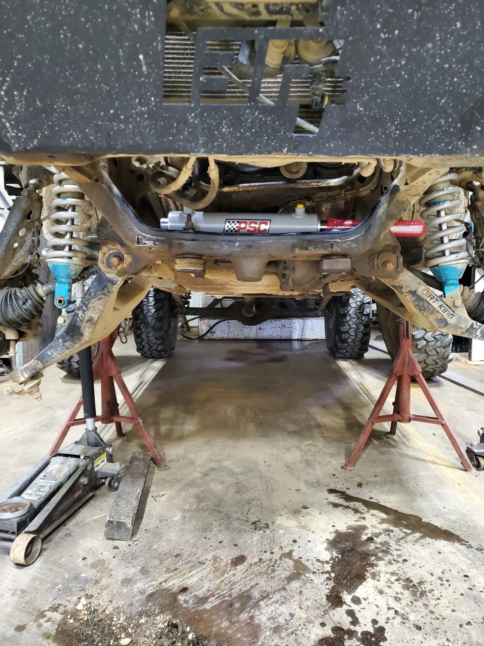

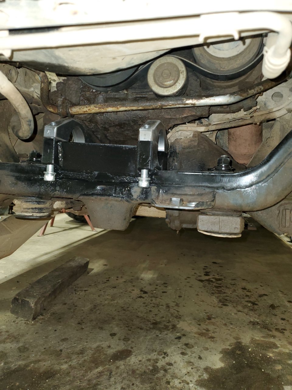

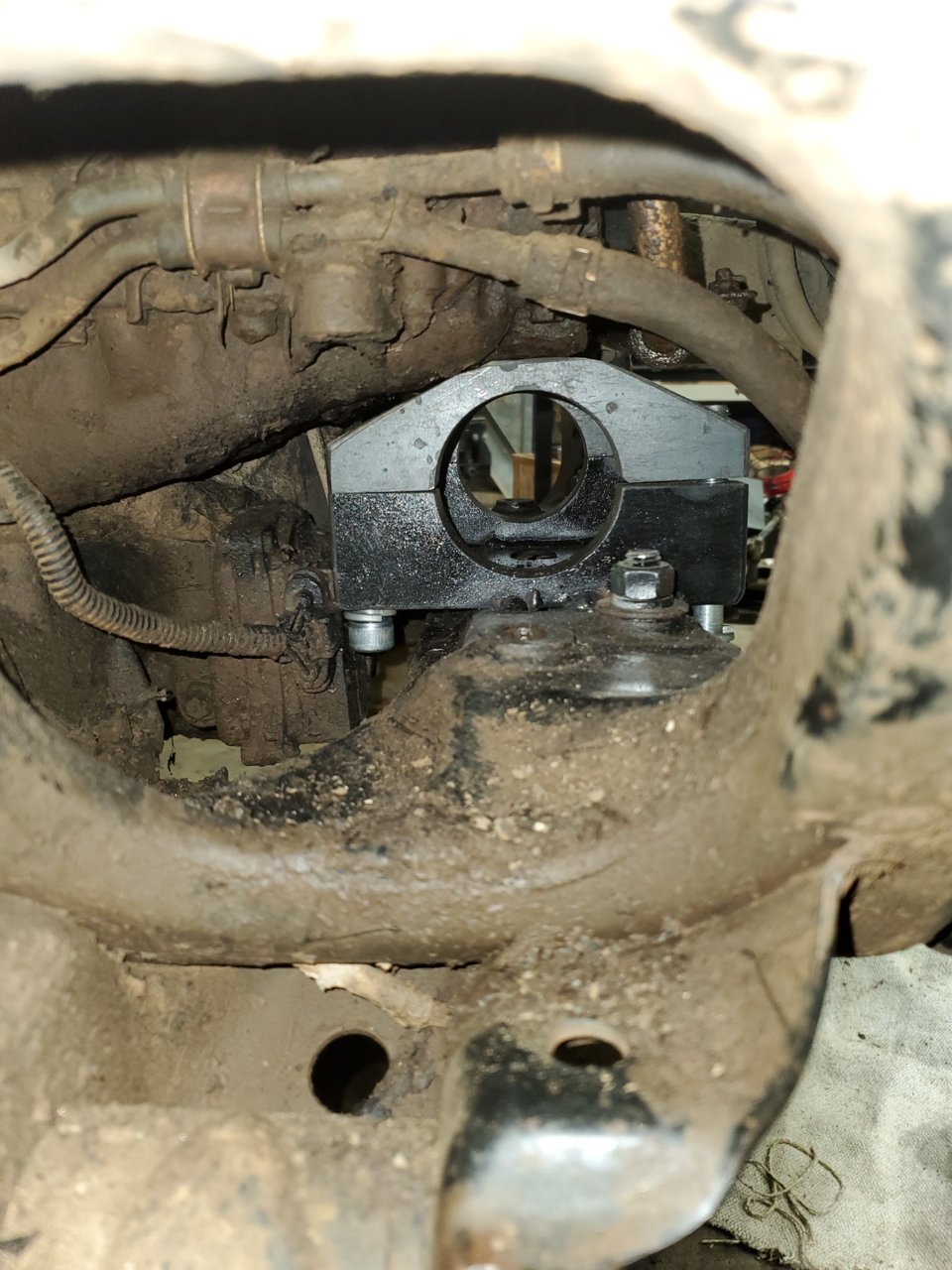

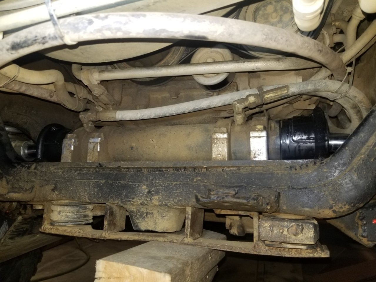

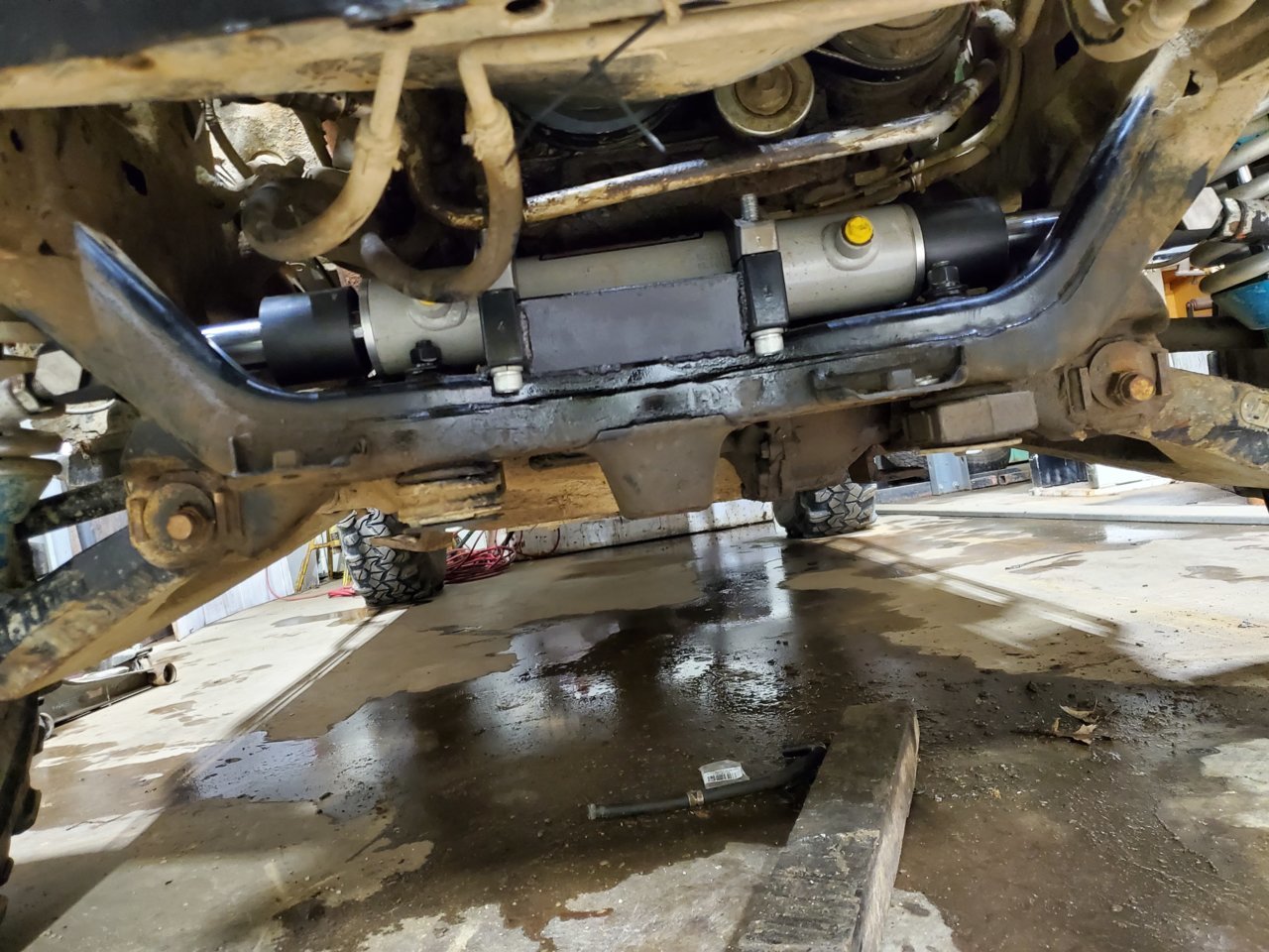

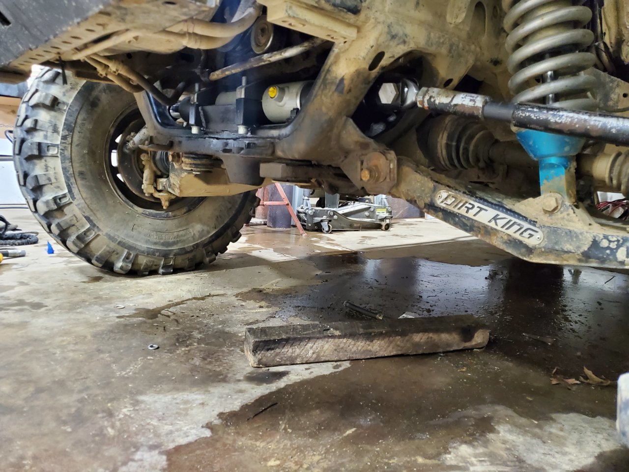

    Psc 10" ram
    https://www.polyperformance.com/ste...ulic-double-ended-10-stroke-steering-cylinder
    Clevis for the ram
    https://www.polyperformance.com/psc-steering-clevis
    Power steering pump
    https://www.polyperformance.com/ste...uty-ps-pump-for-gm-jeep-suzuki-toyota-sp1200x
    Power steering pulley
    https://www.summitracing.com/parts/...MIitmLnZmB6AIVkICfCh3vOwqkEAQYASABEgI-3_D_BwE
    Power steering reservoir
    https://www.polyperformance.com/trail-gear-reservoir
    Orbital valve
    https://www.polyperformance.com/trail-gear-orbital-steering-control-valve
    (I went with 100ml because the ram has to be limited to a 6.5" throw)
    Orbital valve to toyota spline adapter (steering column)
    https://www.polyperformance.com/trail-gear-steering-columns-3-1-4-8-3-4
    Inline filter assembly
    https://www.zoro.com/zoro-select-hy...MI_9Lf0pqB6AIVip6zCh2IEwyVEAUYASABEgKN3fD_BwE
    https://www.zoro.com/zoro-select-fi...MItYqs7ZqB6AIVzMDICh3r5AM3EAUYASABEgKVBvD_BwE
    Other parts include:
    Delrin or some sort of bushing for limiting throw of the ram
    Hydraulic hoses (I had a local marina make them for me)
    This is the parts list that I am running on my set up. The psc ram is a very tight fit and I'm not going to guarantee you will make it fit so there is another ram option that I will list below.
    https://www.polyperformance.com/ste...rock-assault-double-ended-ram-and-clevis-kits
    The difference is the ram and shaft diameter. The trail gear ram has been in my buddies truck for a little over a year now and the only issue we had was the shafts wanting to bend under stress so we hard mounted the delrin bushings to the frame and that has eliminated the issue. (The shiny black parts)
    You can see how close the length is to oem but it didnt offer enough support before the modification to handle the stress.
    The tc psc power steering pump is almost a direct bolt in. I had to add 3/16 shim on the back of the top bolt to make it a snug fit. As for the pulley I haven't found a 7 rib to fit it in a 4.5 diameter. So I used the 6 rib and pressed it on so all the pulleys align towards the front of the vehicle. Now I run a factory length 6 rib belt. I also made my own ram mount out of steel and welded it to the cross member.
    20200303_190909.jpg 20200217_171715.jpg 20200216_182140.jpg 20200216_182152.jpg
    I ended up removing even more metal from the top of the clamps but never got a final photo before I installed the ram.
    As I wrap up the install I will take photos of how I mounted everything and update this post.
    Also if you plan on tackling this project these are not the only things you will need. The tie rods will have to have a heim inner. So now you need to upgrade the tie rods. Here are my parts list for that.
    https://www.ruffstuffspecialties.co...ff&Product_Code=34SET&Category_Code=34REPARTS https://www.ruffstuffspecialties.co...&Product_Code=TRESTAND&Category_Code=TRESTEER https://www.ruffstuffspecialties.co...ff&Product_Code=7818TA&Category_Code=TRESTEER https://www.ruffstuffspecialties.co...Product_Code=125X120DOM&Category_Code=DOMTUBE
    https://www.ruffstuffspecialties.com/catalog/REAM.html
