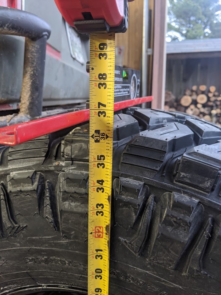

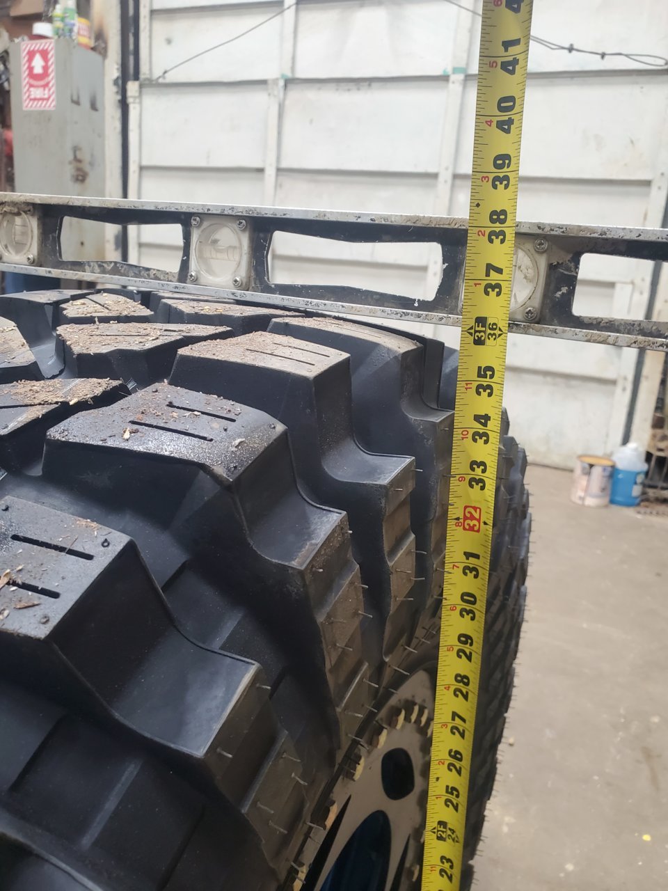

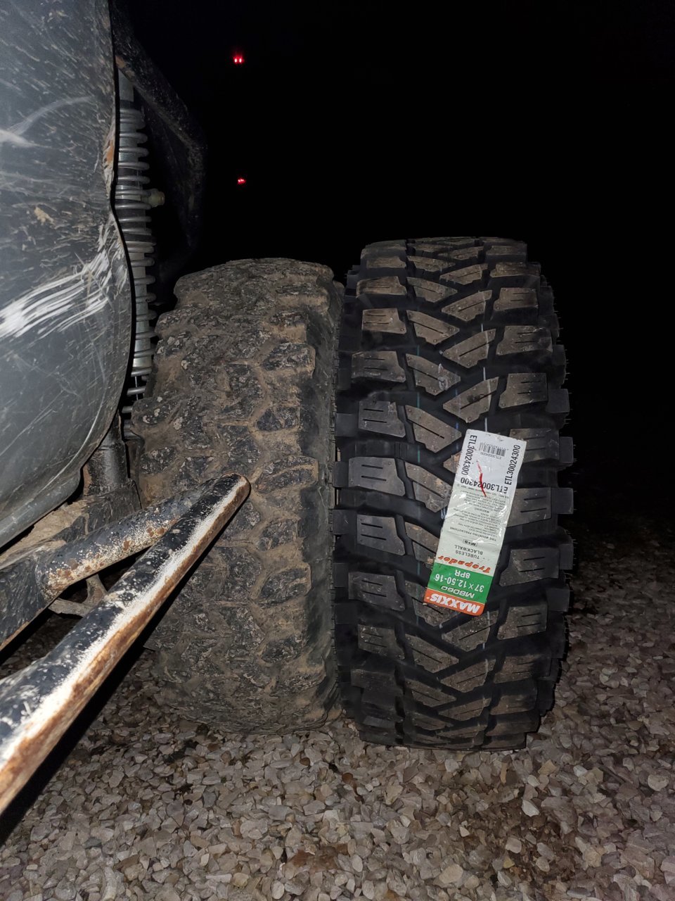

    Rolled it up next to the 36" tsl that is aired up to 32psi as well with the weight of the truck on it.20200316_203205.jpg

  7. Mar 17, 2020 at 3:36 PM
    #1107
    tetten
    tetten Cynical Twat Waffle
    Nov 2, 2014
    #141581
    2,504
    Andy
    Socal
    That's a full inch smaller than the industry size? I thought maxxis made their tires closer than that?
  8. Mar 18, 2020 at 4:17 AM
    #1108
    Robertocritser
    Robertocritser [OP] Well-Known Member
    Jul 21, 2010
    #40524
    7,216
    Levi
    KY
    08 sport
    ATM6969420 series
    Not sure?

  11. Mar 19, 2020 at 4:35 AM
    #1111
    Robertocritser
    Jul 21, 2010
    #40524
    7,216
    Levi
    KY
    08 sport
    ATM6969420 series
    I'm not upset about the undersize, being bias ply they dont squat much when aired down. I'm very happy with how much width I have gained though.

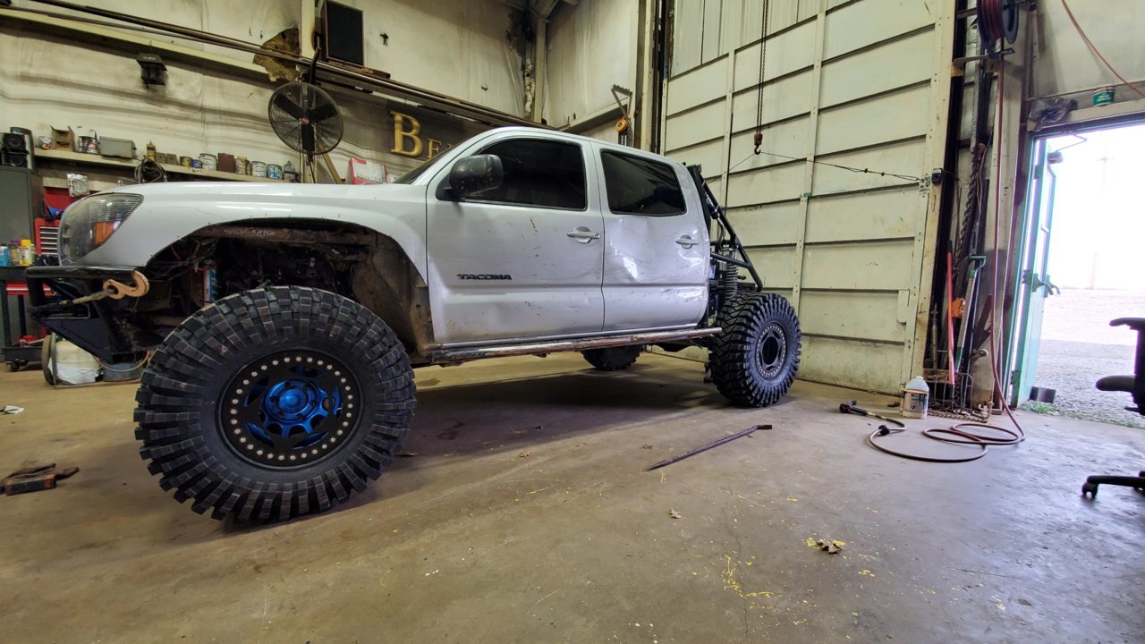

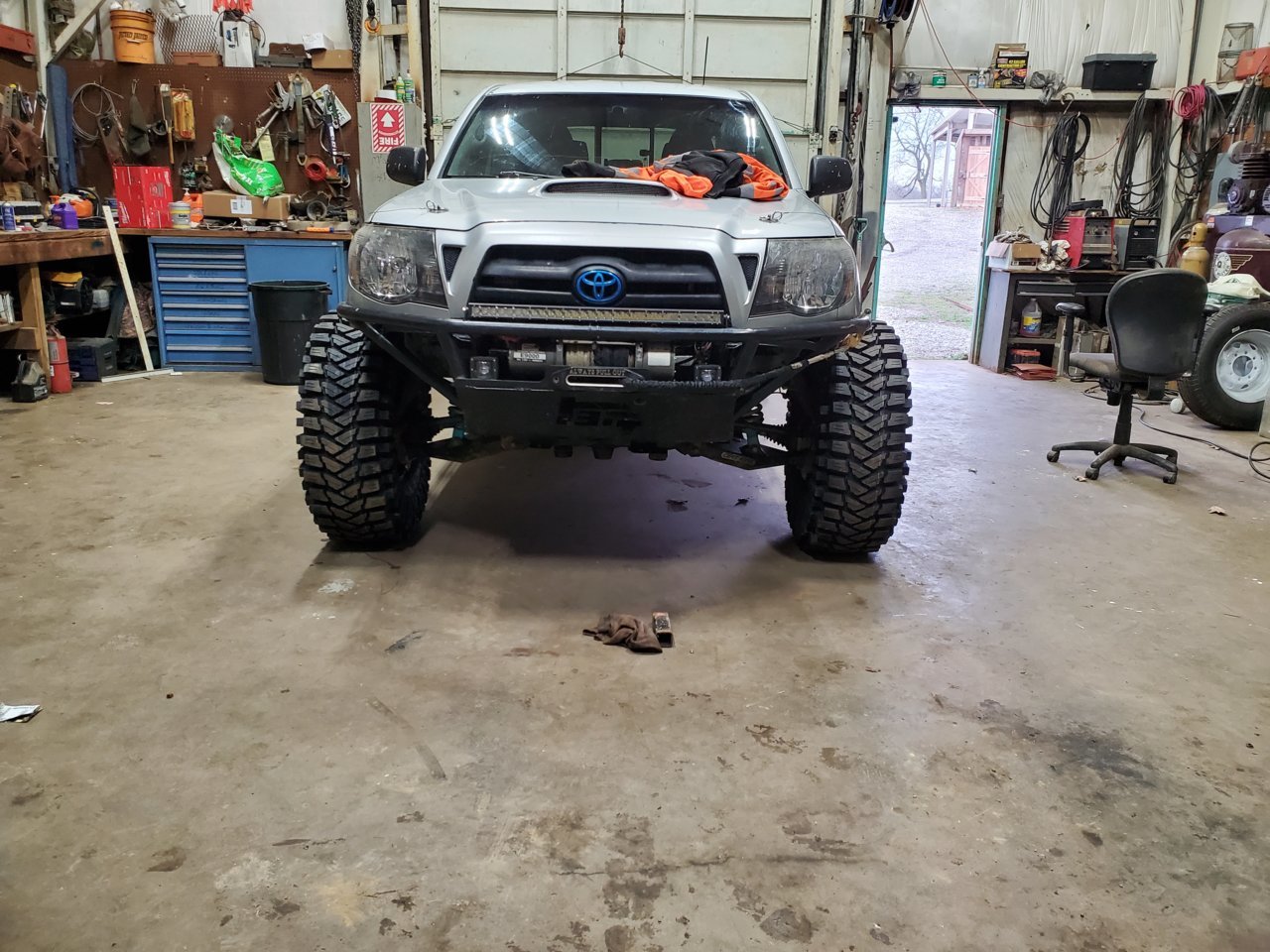

  14. Mar 23, 2020 at 6:28 PM
    #1114
    Robertocritser
    Jul 21, 2010
    #40524
    7,216
    Levi
    KY
    08 sport
    ATM6969420 series
    Have to get larger wheel spacer for the rear. Knowing howI procrastinate I'll wait until a trip is planned and then order it a month in advance only to get it the night before haha.

  16. Mar 23, 2020 at 8:47 PM
    #1116
    totmacher
    totmacher automotive hypochondriac
    Sep 7, 2009
    #22430
    4,735
    Daniel
    TN (memphis-ish)
    Toyotas
    Cut & broke off stuff. Prolific ziptie and tape usage.
    Why not just get a bigger axle?
    Any reason besides spacers being cheaper?
  17. Mar 24, 2020 at 4:04 AM
    #1117
    Robertocritser
    Jul 21, 2010
    #40524
    7,216
    Levi
    KY
    08 sport
    ATM6969420 series
    Wider axle is going to end up around $2500 while the spacer will be less than 200

  20. Mar 24, 2020 at 11:29 AM

    Is it possible you could fab your own axles? If you found a donor 2nd gen axle to test with of course. Reususe basically everything but inner shaft? Like cut the outer tubes, weld in tube extensions midway on each side, reinforce full length, then just have to buy/find longer inner shaft.
    Seems like you have the tools and skill to make it happen.
