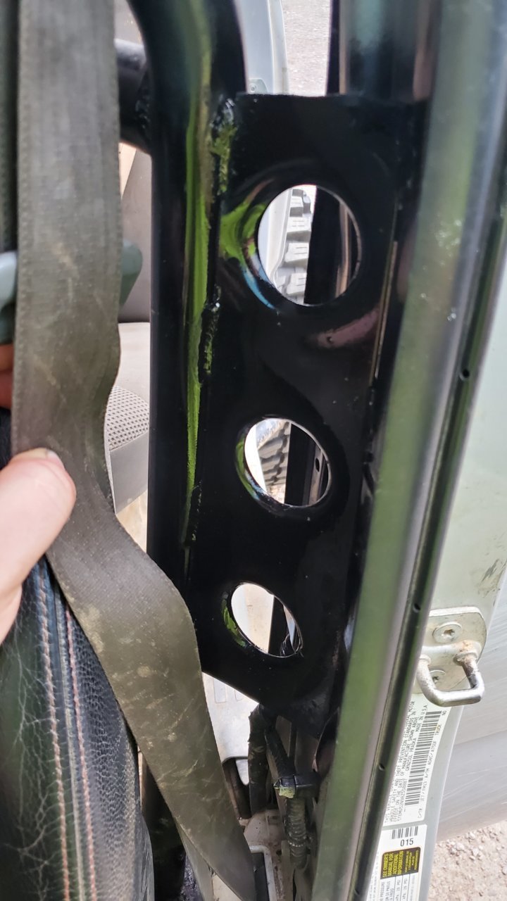

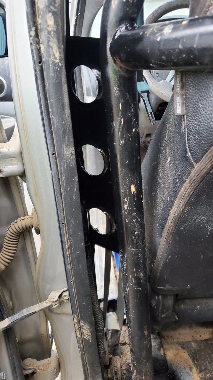

  9. Apr 21, 2020 at 9:02 AM
    #1129
    Robertocritser
    Robertocritser [OP] Well-Known Member
    Jul 21, 2010
    #40524
    7,216
    Levi
    KY
    08 sport
    ATM6969420 series
    I added some b pillar gussets last night to the cage. Also did the dimple dies on the cheap. Ended up using a 1 3/4 hole saw and then a 36mm socket with a piece of tube on the bottom to made the dimple. A little more practice and I think I can get them to look almost perfect.

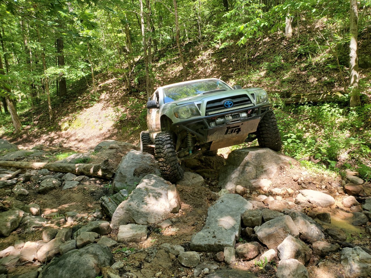

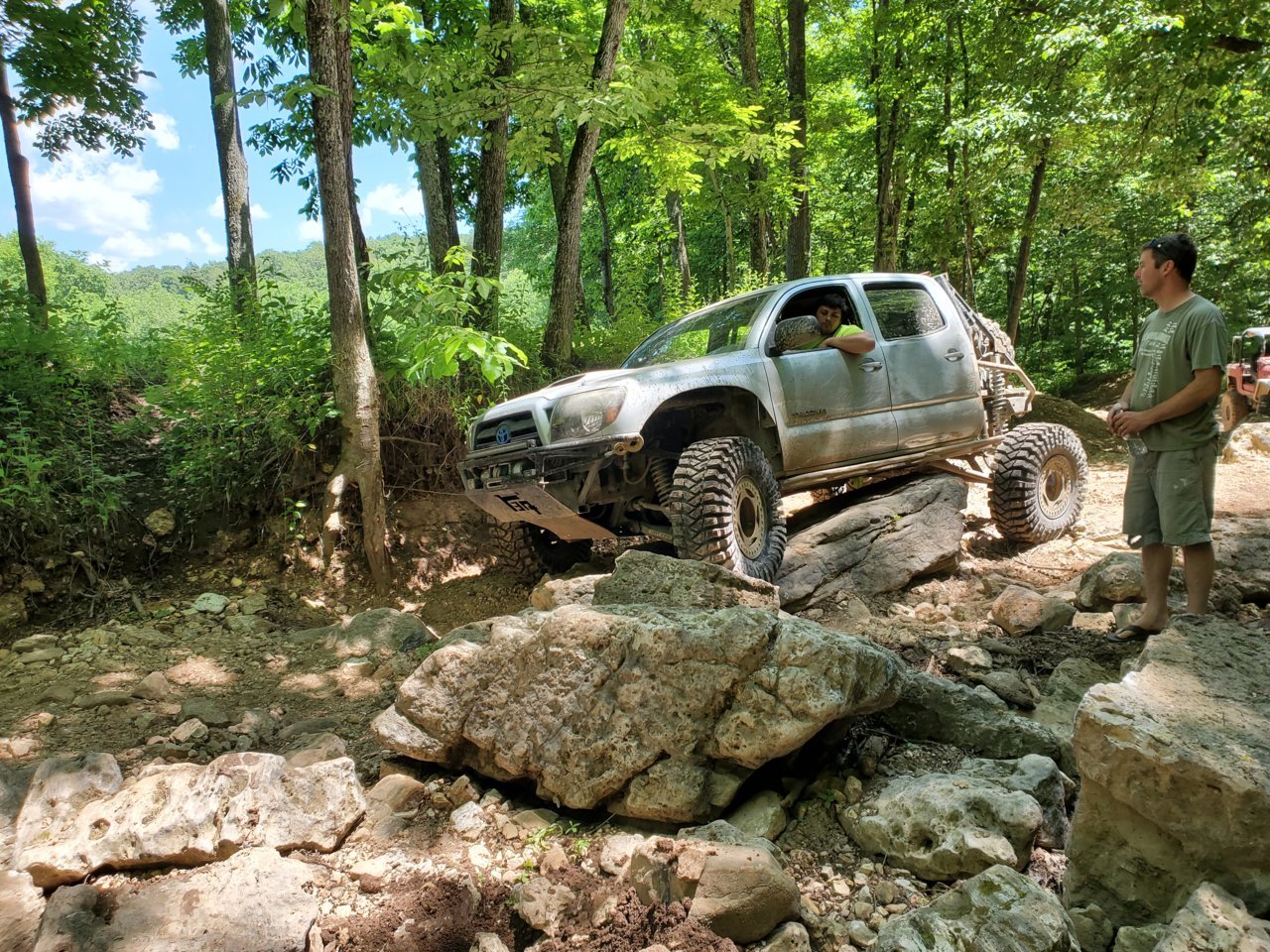

  15. Jun 17, 2020 at 3:28 PM
    #1135
    Robertocritser
    Jul 21, 2010
    #40524
    7,216
    Levi
    KY
    08 sport
    ATM6969420 series
    Hit a few trails at flat nasty with a group from Chicago. Had a blast and the park is pretty bad ass. My drive shaft is a little worse for wear and a few new dents on the body but nothing major. The full hydro was amazing. Aired down to 6 psi in the front and was able to turn with one hand while the locker was on. Makes wheeling all day long enjoyable now haha. Also Connor blew up his Detroit locker in his front axle and made for an interesting Sunday.
