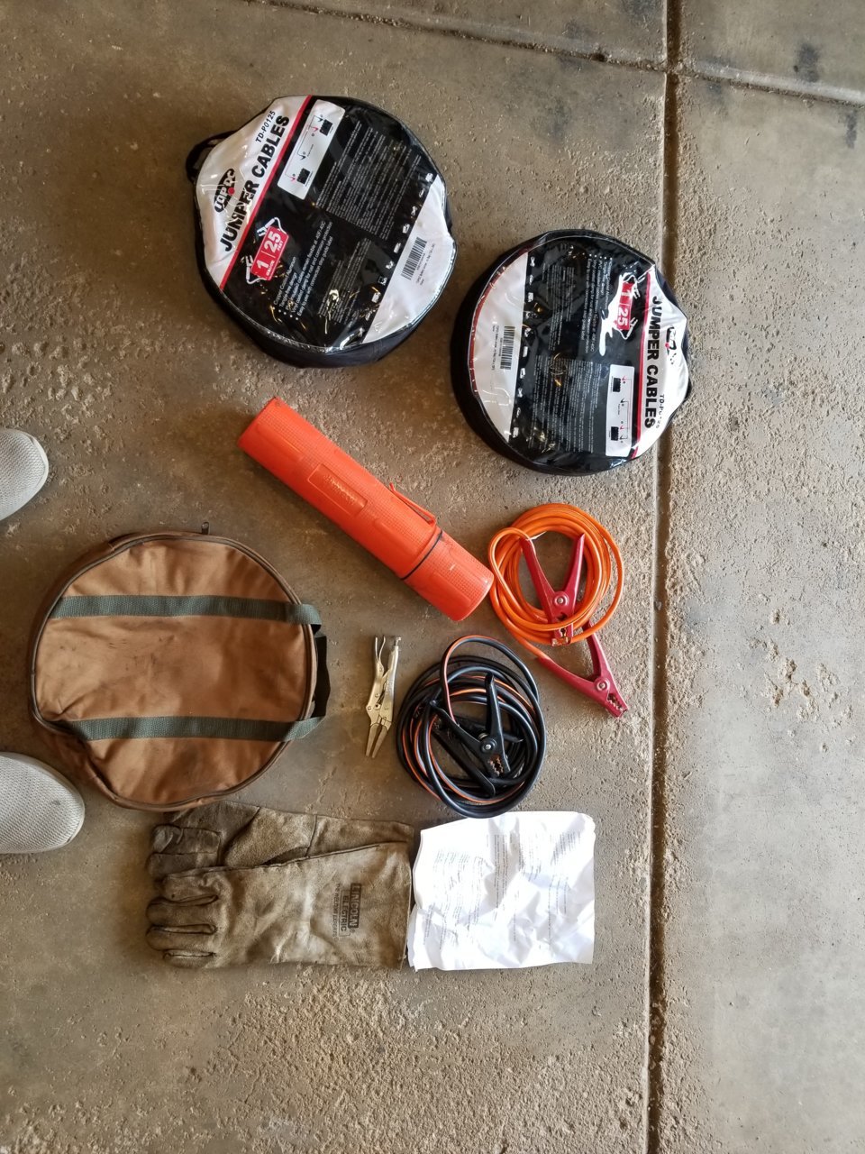

    Here is my welding kit:
    It consists of 3 sets of jumper cables, 1 set separated, that's your welding leads. I have a small needle nose vice grips that is used as the electrode holder, rod holder and gloves.

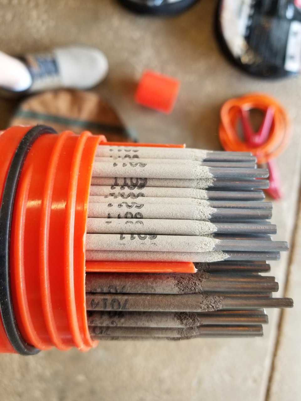

    The rods I carry.

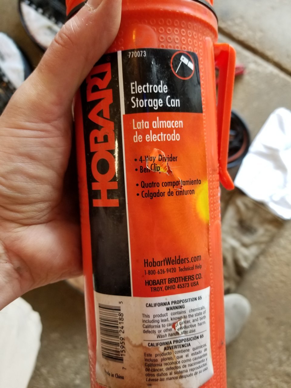

    Water proof rod holder. I got everything off Amazon.
