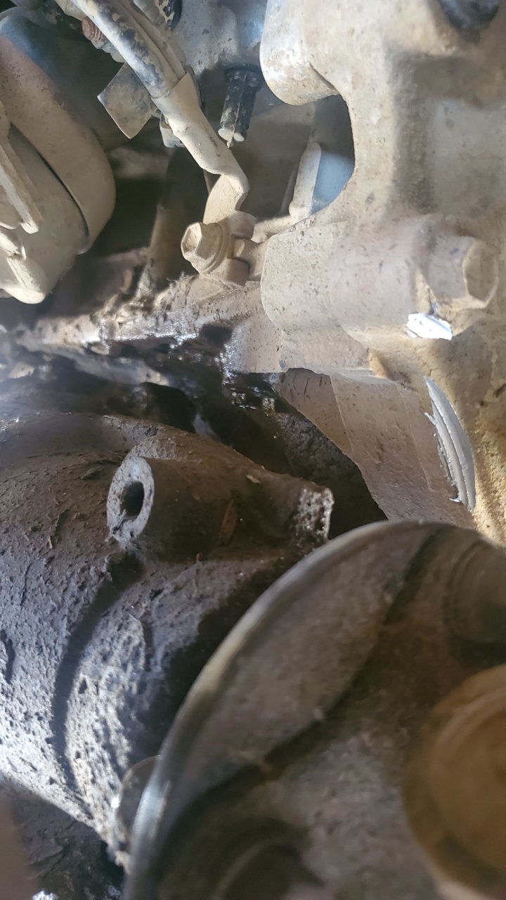

    I think a combination of the frame and the mounting washer broke.

    oh yea that's fun... had that happen to me on hells revenge coming down from the hot tubs... nasty sound. found the ground aluminum on my skid plate that led me to the break... ratchet straped the diff in place, disconnected the front driveshaft and drove out in 2lo the rest of the way.. had my buddy fix the mount that the bolt ripped out of and now it's stronger than factory. what a pain tho.. no oil leak for me tho

    I'll do the same. And weld the block and see how it holds haha
