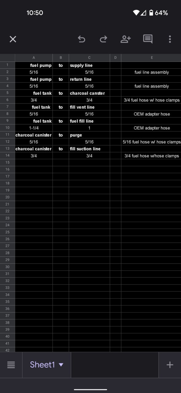

    You might have to zoom in on it but that will have the hose or fitting sizes you'll need.

    About 90 percent is. You will have feed and return then a power supply for the pump.

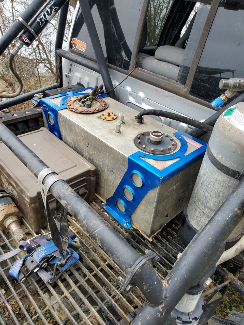

    Just looked through old pics and this is about everything I used. My adapter came from motobilt as well as my fuel cell and mounting brackets.
    next time I do it I’m going with a jaz cell though

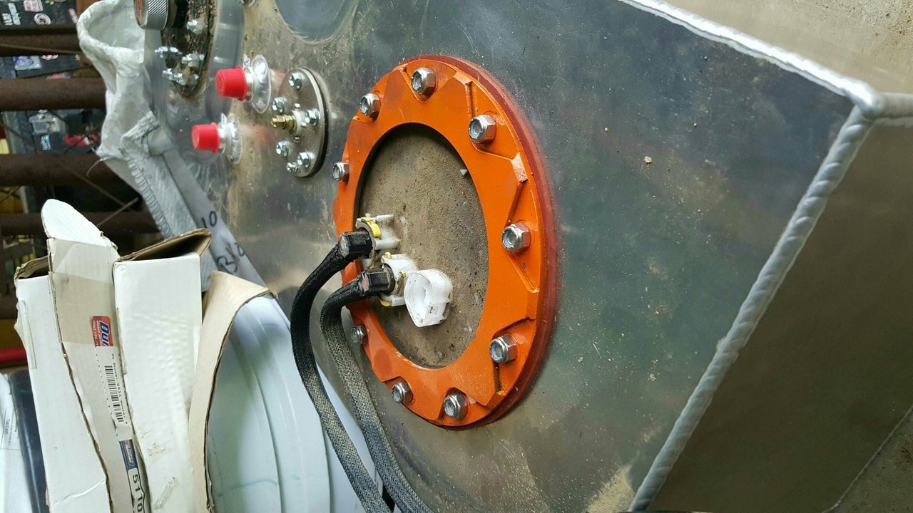

    Do you have any more info on this? Motobilt has a 15 gallon jeep cell that keeps their factory pump. The flange is 6” like our taco pump and the depth is 12”. Our pumps range 9-12” with the spring range. What’d you do to get your pump to work with the RCI? I already picked up the RCI and had rather make that work if possible

    The one in the pic is 19 gallons. I had trimmed the factory sender to work the TJ sender adapter and the pump fit inside that tank really well. I also went ahead an bought a non oem sender and swapped a walbro pump into it as well as a better filter externally. This kit specifically: https://urdusa.com/urd-2010-toyota-4runner-fuel-pumpfilter-upgrade-kit/
    didn’t know they still had it but it’s a pretty sweet upgrade if you’re getting into that type of thing. I’d also look into a jazz fuel cell.

    Do you remember where you got the ring on eBay by any chance? Also, what’d you do for a muffler/exhaust?

    Motobilt sells that same ring

    I cut a hole in it and had a flange made to bolt my pump in it.

    I just ordered the ring and bracket from motobilt. Thanks for the help, one less puzzle to solve :fistbump:

    Not sure if it’s on the Motobilt description but there is a permatex sealant if I recall that is fuel safe and is meant to go between that ring. Goop it up real good.
