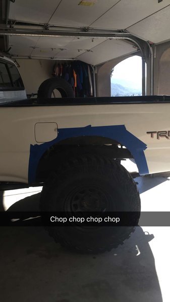

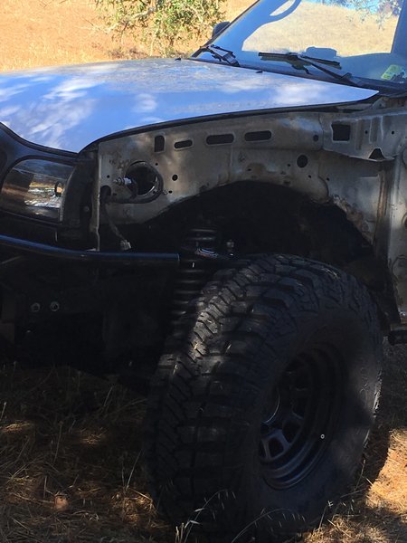

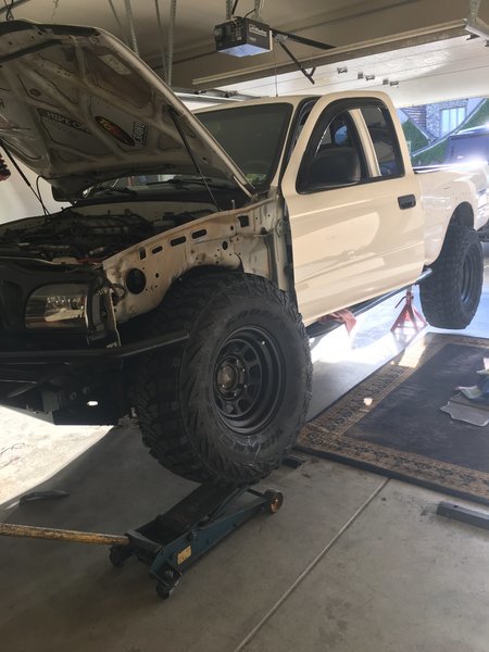

    Its an tedious process for sure!
    Alot of cutting, jacking the tire up, turning to lock, checking, rinse and repeat.
    And Im also running the 315 75 16. I haggled the tire dealer down on the price, showed them some numbers I found online and negotiated myself a set of 5 Goodyear MTR's.
    They are a great looking tire for sure and they'll get me down the trails I'm trying to hit this summer!
    Ill get some better pics of the actual cuts tomorrow to show you how were handling it.

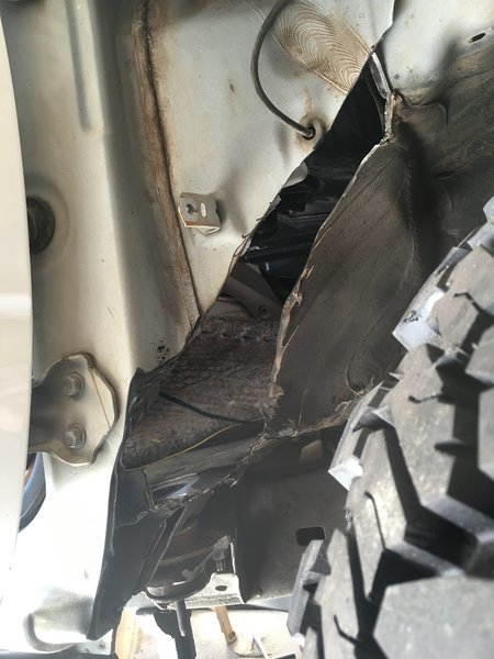

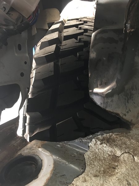

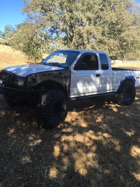

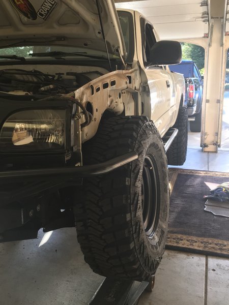

    Well I think all the cutting for the Tub is done!
    Passenger side came out alot cleaner than the drivers side. Im going to try and put a thicker plate over the cab mounts. I took a decent amount out of it now I want to reinforce it some.
    Both sides are pretty even as far as how deep into the cab I ended up cutting. And im still thinking the tire will rub the plating a bit after its all done!
    Should be rolling tomorrow for a test run if all goes well

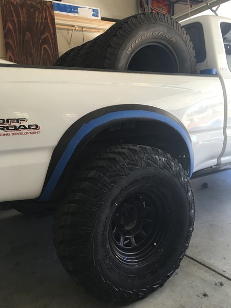

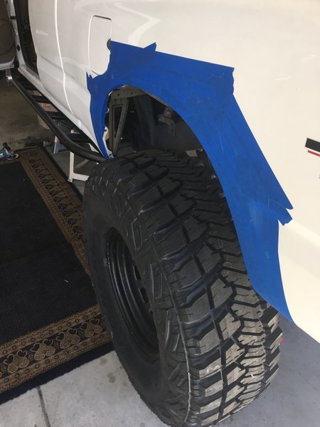

    Trying a little something with the stock flares. See how much of them I can keep. Going to cut them a bit and drill holes in the stock snap pin positions and mount them kinda like bushwacker style with some bolts and rubber washers. I saw a few guys do it with their 2nd gens and it turned out nicely
