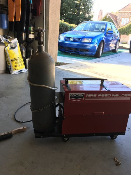

    In other news my neighbor is awesome.
    Lets get this shit show back on the road

    Now thats a good neighbor! Nice Jetta too

    Its actually a pretty fun car to drive. Soo tempting to put some racecar parts in it but theres no way I can afford two projects right now :help:. The money fairy hasn't come around in a while.
