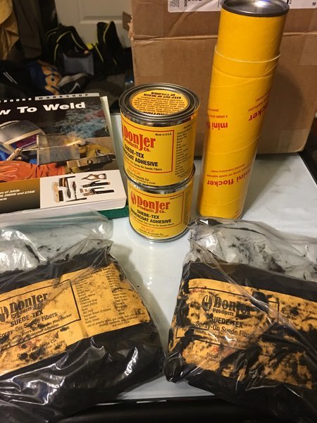

    Preview of cheap winter mod numero uno. (Plug the welding for dummies book. I am a newbie at best, trying to get to amateur status)
    The plan is to flock my ugly brown dasboard with this kit. I bought it a while ago. $50 or something like that.
    I got the idea from these guys I watch on the youtubes
    https://m.youtube.com/watch?v=Z2BnfI8LLAk
    If done right it looks absolutely incredible.
    Kit was bought here
    http://www.flockit.com/index.php/prod
    Ill be doing a proper writeup once I get it done. Gott clean up this Build/BS thread

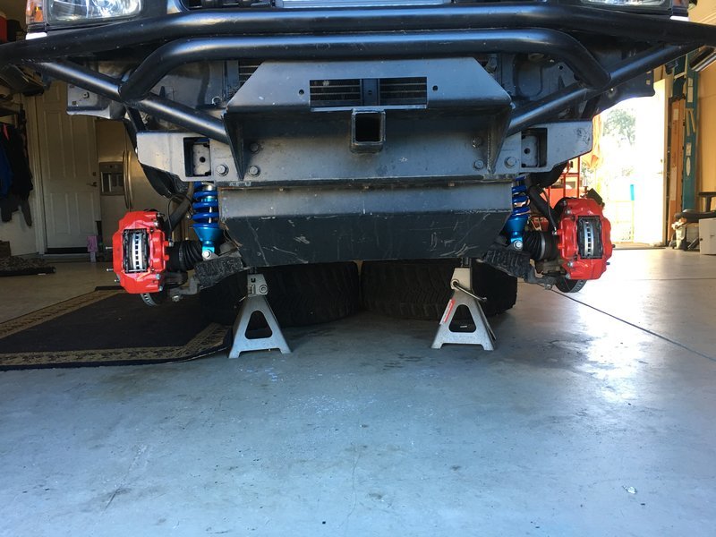

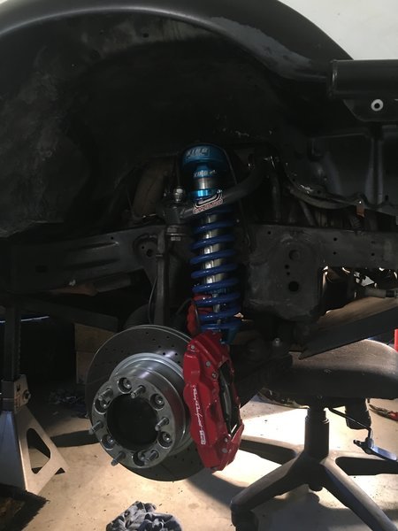

    Well I almost got this big girl back together. But my lower coil bolts were looking sketchy so I got some coming in tomorrow from Toyota with fresh washers and nuts too.
    It looks pretty though.

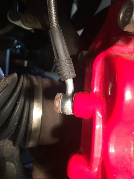

    Rob do you have the Wheelers SS front brake lines?
    I have the Extended SS lines from the guy here on TW that sells them wondering if I will have any issues with connecting them to my Tundra calipers?
  6. Jan 13, 2017 at 4:09 PM
    #206
    Robmonster117
    Robmonster117 [OP] Well-Known Member
    Sep 29, 2013
    #113490
    1,963
    Robert
    Gilroy
    02 ext. cab 4x4
    Truck parts
    Yea I have the wheelers. They connected without issue straight to the caliper. Im not sure how yours are built but if the ones you got are connector to the fluid bot (eyelet) you should have an issue. The threadings for tacoma to tundra brakes are the same.
    (This eyelet thing)^ I cant remember technical terms

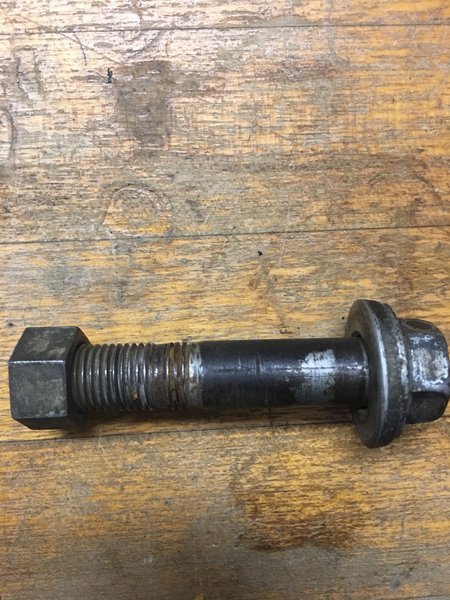

    Yup mine look just like that...but heard you may have to drill hole in the bolt that threads into the caliper, the one securing the line
  8. Jan 13, 2017 at 4:13 PM
    #208
    LogCabins
    LogCabins Well-Known Member
    Apr 30, 2014
    #128878
    2,310
    Robert
    Oahu
    99 SR5 3.4L 4WD
    Wheelers sends a bolt and washers with their lines that have the hole in it already...guess I will find out when I take my current ones off

    Oh gotcha yea its a special bolt thats how the fluid goes to the caliper unless your caliper is a different design. If you got the 13WLs should be the fluid feed bolt style
  10. Jan 13, 2017 at 4:22 PM
    #210
    LogCabins
    Apr 30, 2014
    #128878
    2,310
    Robert
    Oahu
    99 SR5 3.4L 4WD
    Yup got the 13wl's....wonder if I can get the bolt at Oreillys or somewhere.....just want to have my ducks in a row :D And thanks!

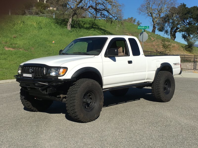

    The maiden voyage of the
    ss leaky bucket
  15. Jan 14, 2017 at 12:29 PM
    #215
    Robmonster117
    Sep 29, 2013
    #113490
    1,963
    Robert
    Gilroy
    02 ext. cab 4x4
    Truck parts
    Holy mother these ride like a cloud!
    Ride height is all set up I'm sold on getting kings in the rear too. Just got to pair them with a good leaf pack. But I wont do leafs till after bumper/ tiregate

    Did you have to put anymore pre-load in the springs?

    Just a tad, 1/4 turn per side just to sit it level. They had it set pretty close to the height my leaf springs are at
