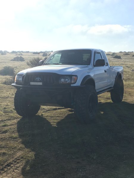

    Went out shooting in the hills. Was a good chance to test the kings on the washboards. All I have to say about that is the front was planted and perfect. The rear was comparable to that of an untamed horse. I need to do my rears badly:bored:

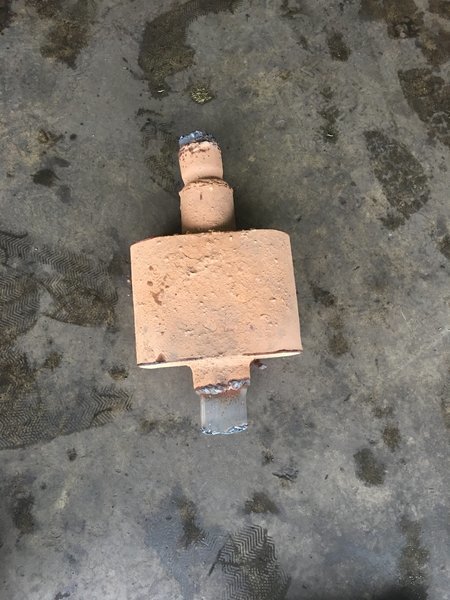

    Getting the new muffler put on
    LogCabins and BYJOSHCOOK like this.
  7. Jan 18, 2017 at 10:56 AM
    #227
    Robmonster117
    Robmonster117 [OP] Well-Known Member
    Sep 29, 2013
    #113490
    1,920
    Robert
    Gilroy
    02 ext. cab 4x4
    Truck parts
    Mini flowmaster for reference
