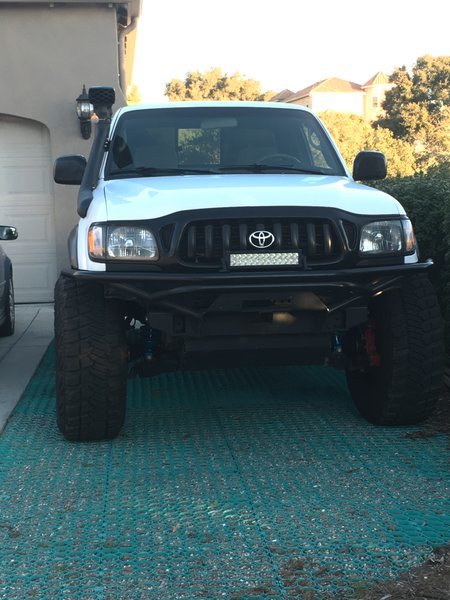

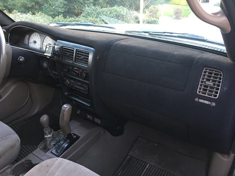

    Snorkel application was a sucess.
    Interior/ Dash mod also complete. Some noticeable blems here and there but overall very happy with it!

    Looks good rob!

    Nice work, Rob!
    I've heard that the Wotefusi snorkels have a section of duct between the fender and the air box that is pretty flimsy. Did you notice that?
    Robmonster117[OP] likes this.
  9. Mar 11, 2017 at 7:51 PM
    #269
    Robmonster117
    Robmonster117 [OP] Well-Known Member
    Sep 29, 2013
    #113490
    1,963
    Robert
    Gilroy
    02 ext. cab 4x4
    Truck parts
    Thanks fellas!
    And yea I did notice that jason I scrolled through @alee891 and @Squeaky Penguin 's builds and I ended up doing the same thing he did, unbolting and rotating the coupler through the fender and cutting the stock intake tube to size and using the supplied rubber and hoseclamps to mate them together worked really well after some finagling.

    Tacomaless
    Brett's method is ideal. I ended up coiling a thick metal wire and placing it between the air box and snorkel (inside the flimsy Wotefusi pipe). It's held up just fine for the last year and no issue of the intake collapsing.
  12. Mar 12, 2017 at 12:07 PM
    #272
    Robmonster117
    Sep 29, 2013
    #113490
    1,963
    Robert
    Gilroy
    02 ext. cab 4x4
    Truck parts
    Yea I was looking at the two options and I felt this was the best for the long term but Im glad the coiled wire is working out. That method doest make it easier to water proof the whole section too. I glued some new sealing trim to the stock slip joints but Im not sure if I got a complete seal. I dont plan on using my truck as a submarine though so I think it should be fine!

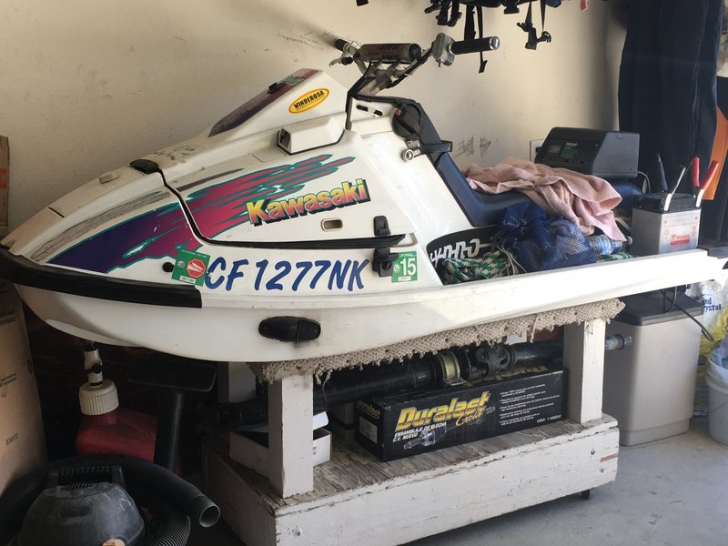

    Long time no posty TW!
    Schools done for the semester and I have to kick it into gear to prep the truck for shenanigans this summer.
    Priority 1 is to solve my ps pump and get the truck rolling again.
    Then its just a matter of gear/ storage and maybe a leaf pack swap if money allows.
    I also need to makes some carpeted runners for the bed to take my jetski on lake trips
    Tis lovely day for a power steering repair

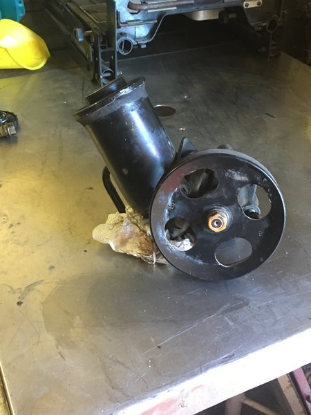

    New PS pump has been ordered. Went with napa as opposed to a oem. Dealer quoted me 500+ and I almost had a heart attack. Great thing is Napa didnt core charge me so I can break down this one and possibly see about a rebuild. Still have no Idea what went wrong but theres definitely something broken in there, I hear rattling when I shake it.

    Pump has been replaced!
    Shes back alive and kicking. Steering feels amazing actually, old pump was definitely fatigued from its age.
