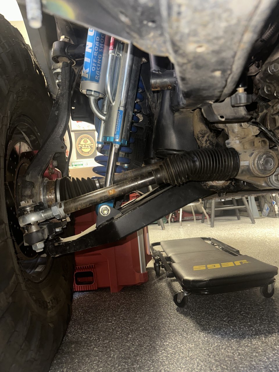

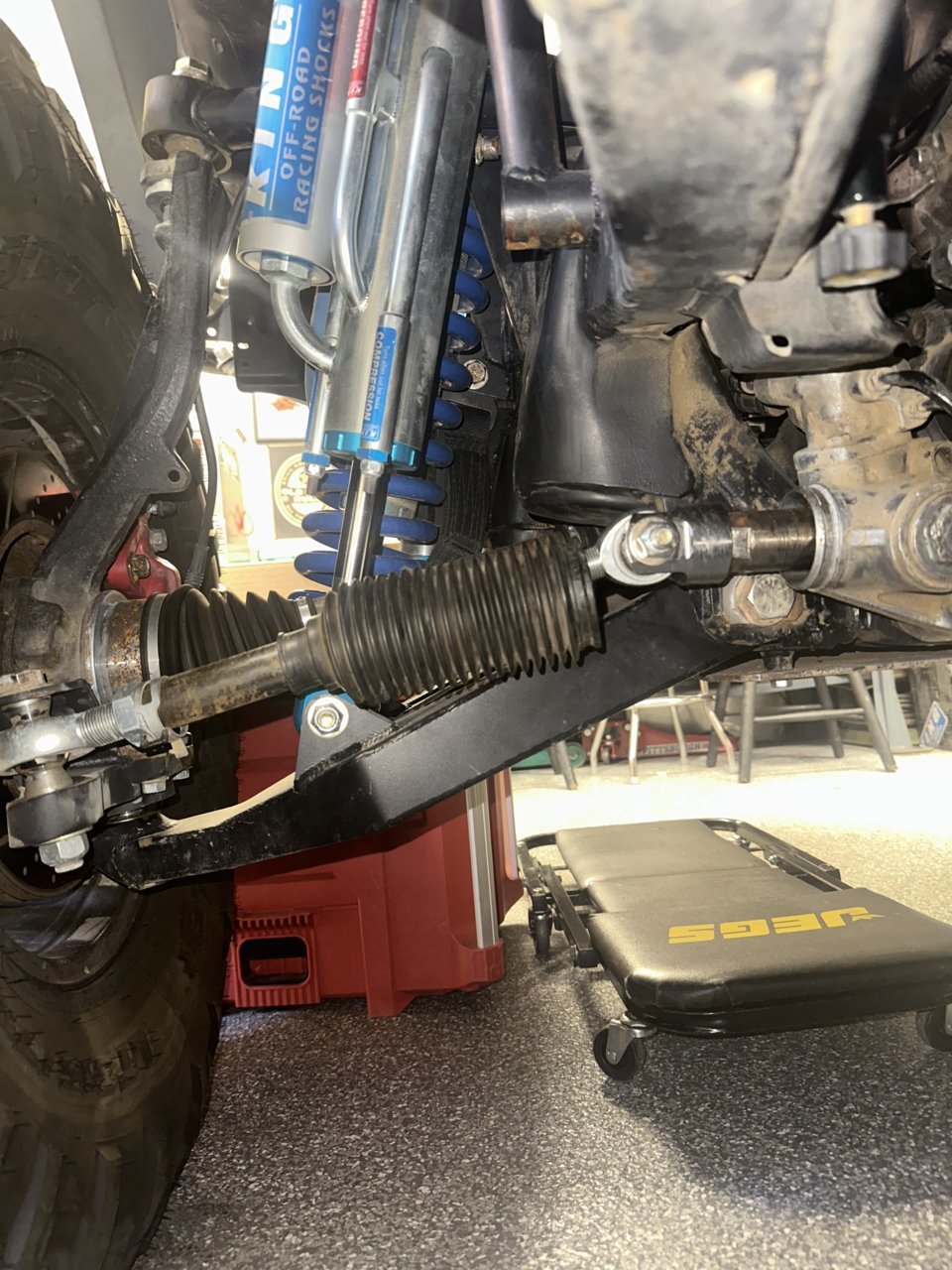

    Can you post a pic of the tierod boot setup?

    @cynicalrider Here you go!
    It stayed on tight with just a ziptie holding the inner lip on the rack. Able to conseal the inner heim and keep it nice and dirt free.

    Dang I never expected it to be able to conceal the inner heim and not tear the boot. Thats awesome and great to know. I've never bent tie rods since I mostly do slow speed crawling but it's great that this beefy solution exists and can be protected.

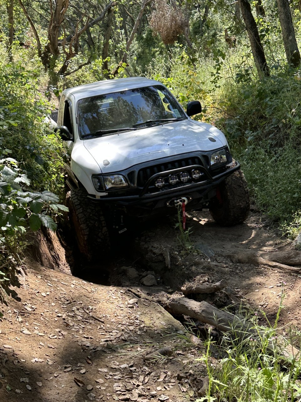

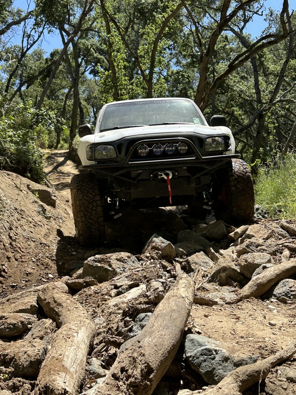

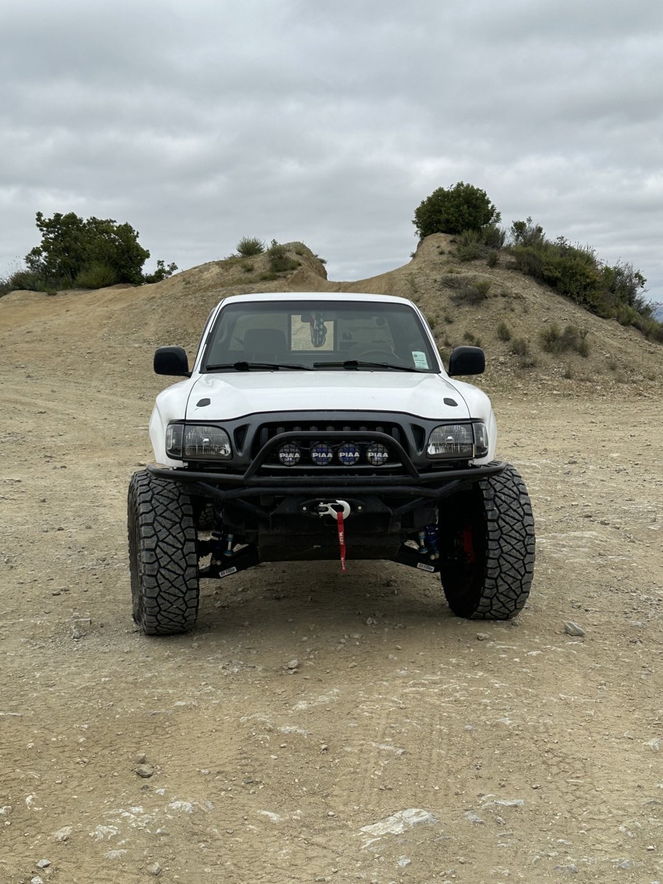

    tomorrow we get a little fresh air

    Which trail is that in the last two photos? Doesn't look familiar to me, but it could just be that I've hit it in the other direction.

    Not sure of the name. Its behind the camp grounds up toward the heights. Its one of the ravines that snake down in between the main roads

    Ah, I think I know where you're at, in that case.

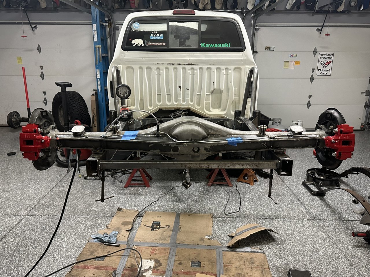

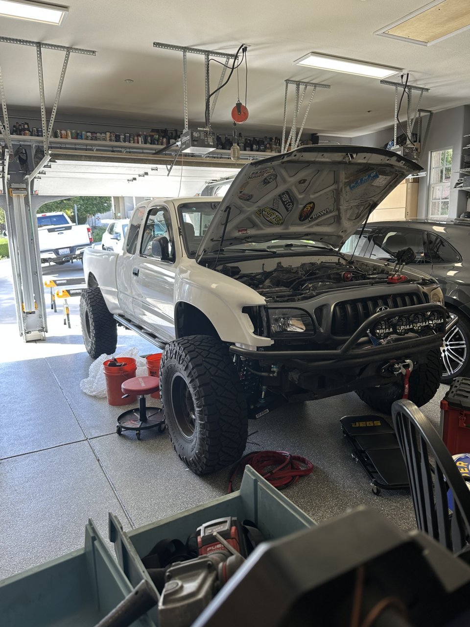

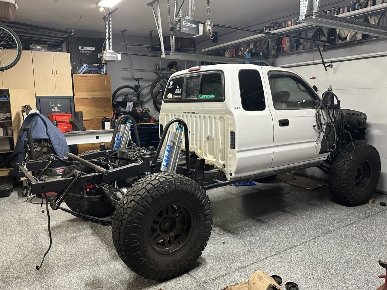

    Well, No 4wd for the foreseeable future…Quite annoyed and confused on how to resolve this easily.
    Short version: Front Differential is shifted ~3/4” in toward the driver side.
    Passenger side destroyed two CVs last wheeling session at flex/droop. All other Measurements driver vs passenger are equivalent.
