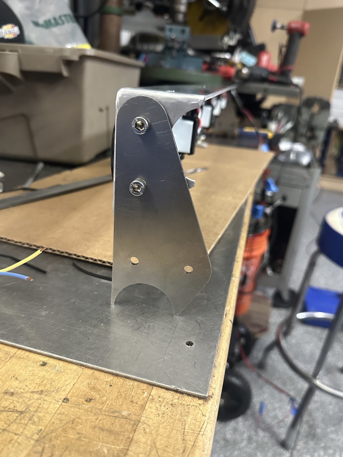

    In prep for dezert szn & hammers:

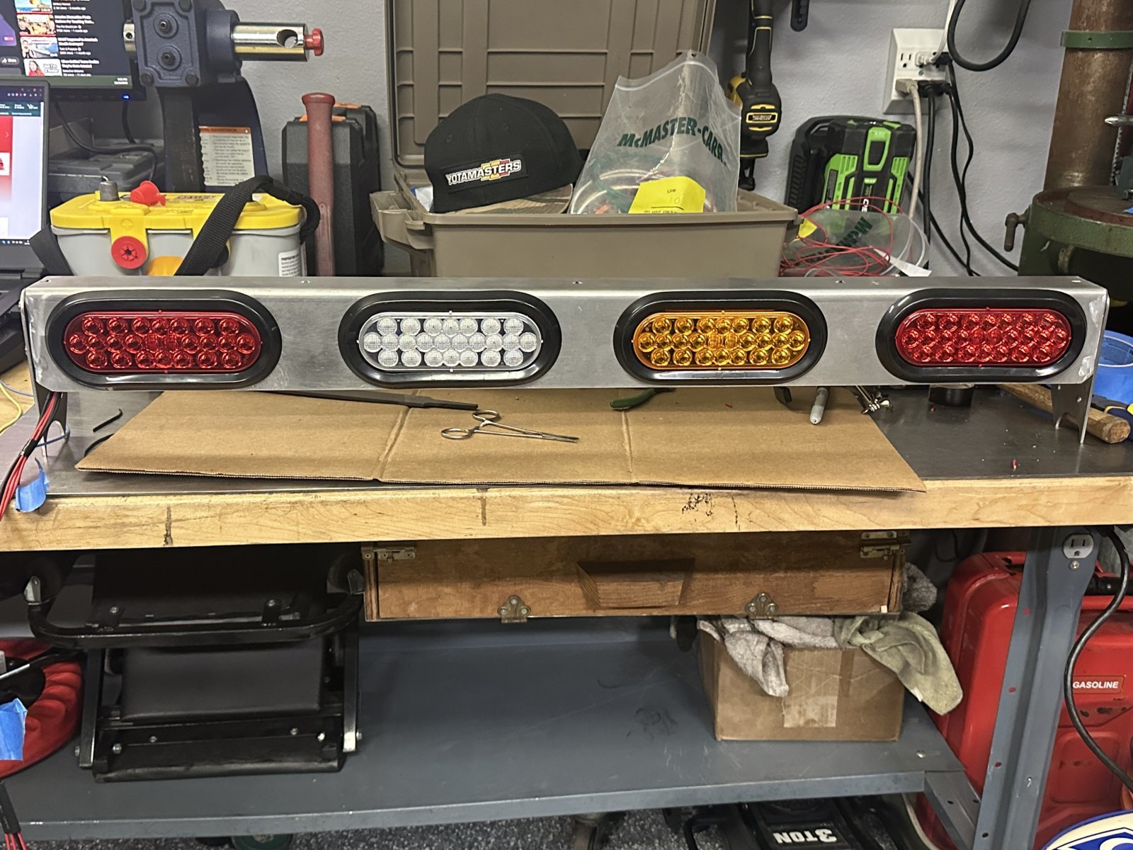

    I made a custom chase bar housing that uses 6” oval leds. Added a programmable flash pattern module to the white & orange.
    Might test the waters if there is interest in producing more

    2000 Tacoma SC 2.7 4x4 5spd
    where does it mount to?

    I made these first brackets to fit to a 1.75 tube bar either welded on vertically or horizontally pointed backward.
    I need to get opinions but maybe I need to make a generic bracket for users choice to cut, bend, weld or bolt wherever they prefer
    For me, i will be putting it on the cross tube I have for my rear shock hoops. Next year it will move to a new bar at the roof line when the cab cage is complete

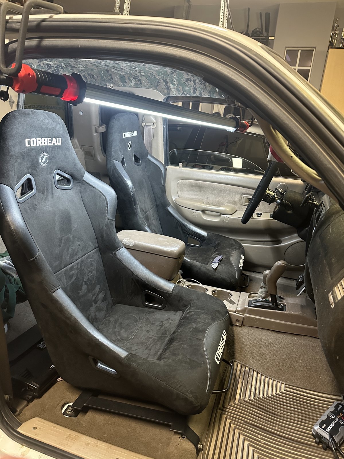

    One more piece of barf brown interior removed :bananadance:

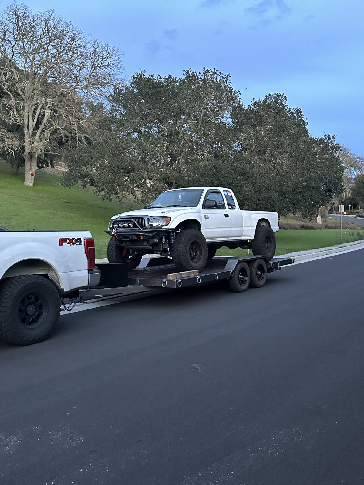

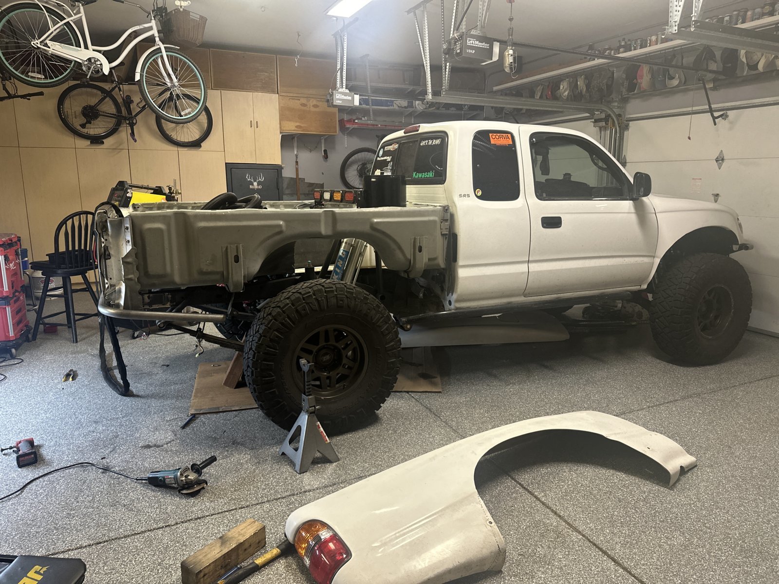

    Aint this a familiar sight :anonymous:
    knocking off a rear bumper. Trimming fiberglass. And possibly finishing my rack saver in time for Ham-town
    Pitter patter

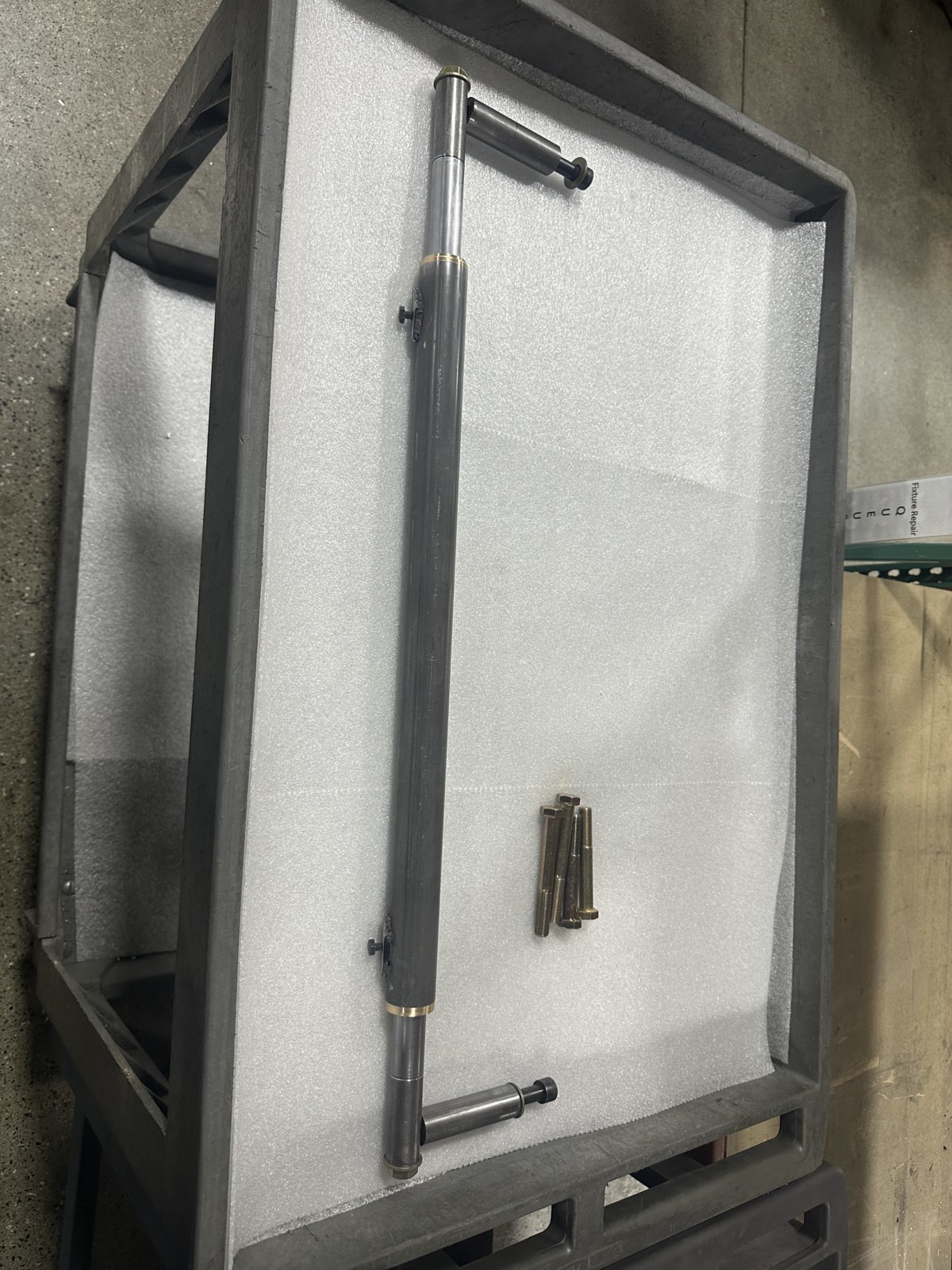

    Rack-saver Install tonight
    Heres the machined Bits all finished.

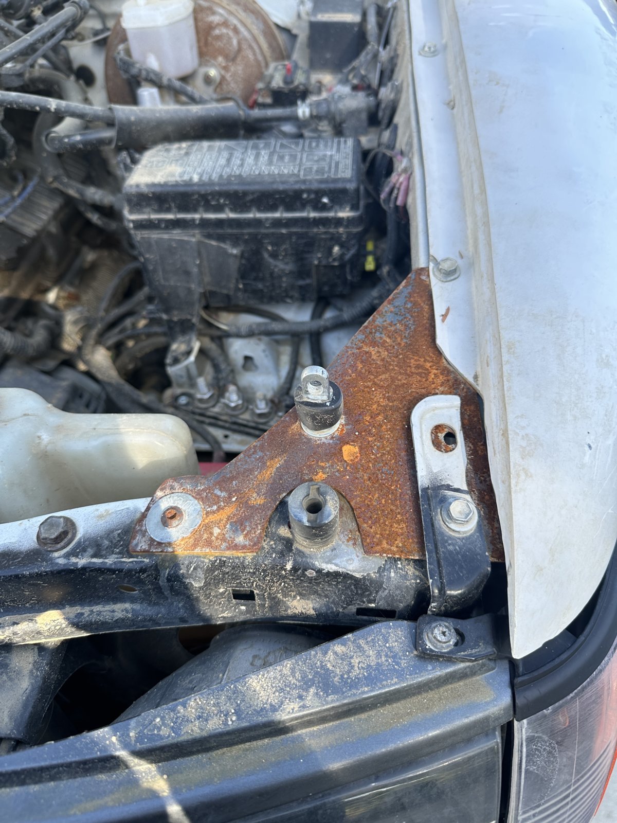

    How did you do the pins for your Aerocatchs

    I made a lil bolt in corner plate/ gusset between the rad support and the front fender mounts. Ill see if I have some pics to share

    I made tabs to bring them back off the radiator support, and get a flat area of the hood.
    Still need to reinforce them by making a piece that goes from the tab over to the fender.
    But ran out of day light. They're adjusted and everything, I'll just feel better with those reinforcements... also need to tack the tear in the radiator support on the driver side lol.

    Bit rusty now because I forgot what paint is:bananadead: but heres my take.
    Corner gussets with some thik-ish sheet and use existing bolt holes
    I installed the latches first then lined up the holes and drilled for the pins after. Easy adjustments after that

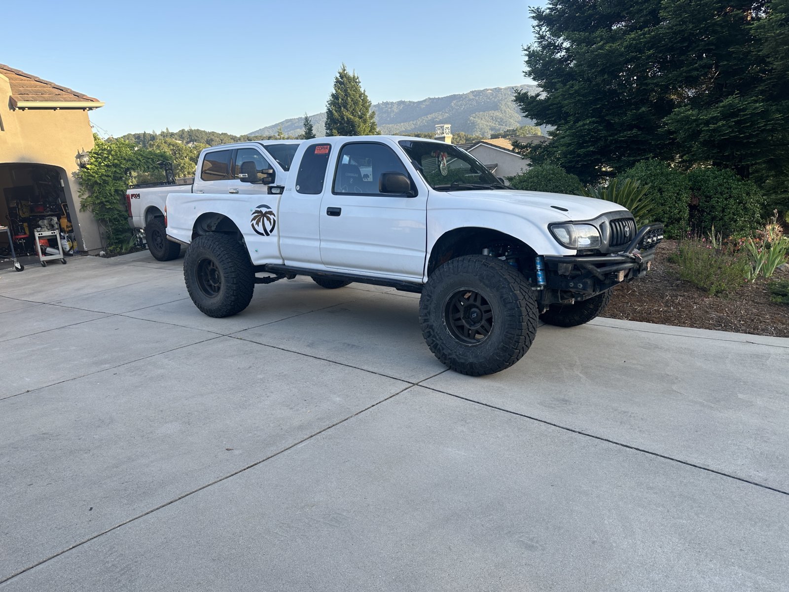

    out for a stroll, think I smoked my leafs already.. got some serious squat

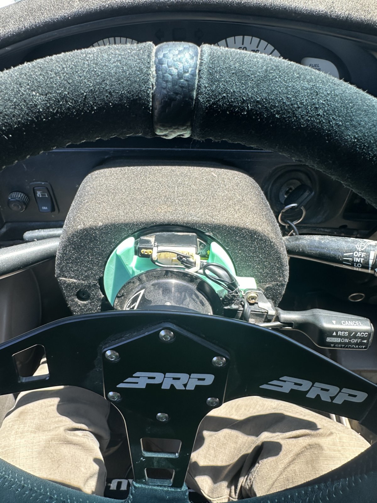

    3D printing is the tits

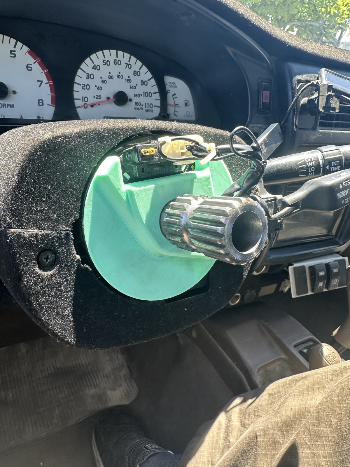

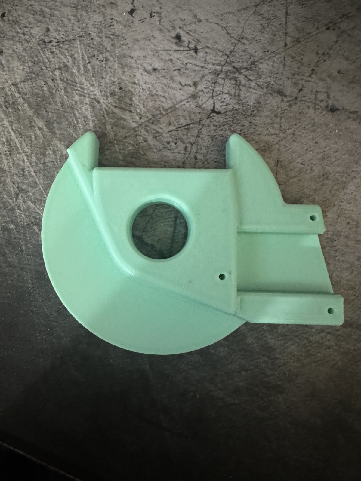

    Quick design and print. And now my turn signals work properly, auto turn off with the clock switch, and my cruise control is back
