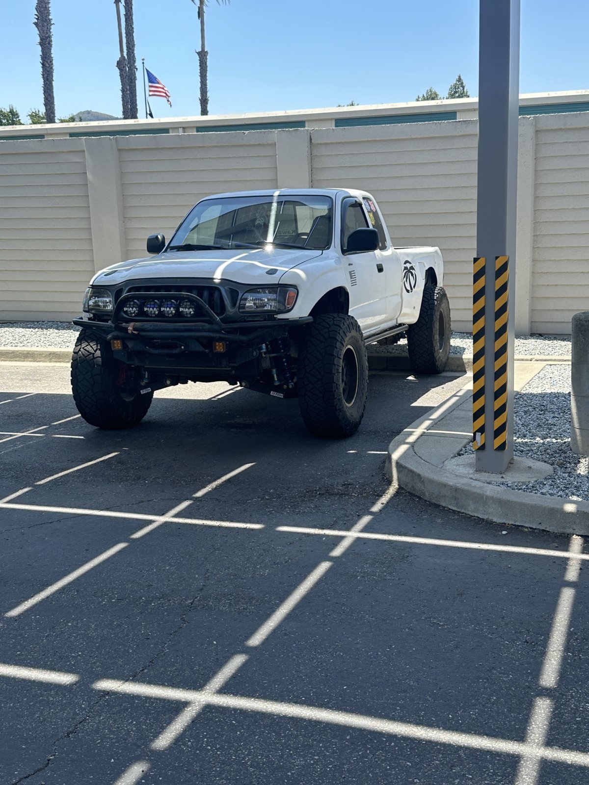

    Not how I prefer to fix it but shes got 4wd. Just in time for some camping:notsure:.
    the true solution would be alot of work, that may be made worthless if I somehow find 2 more cylinder in the near future:p

    soooo how'd you fix it?

    had to suck-in the alignment to the max and move limit straps up and remove ~2.5” of down travel to keep the cv inner joint in the cup, kinda lame. But I kept the other strap points down low when I wanna go 2wd yeet mode

    Damn 2.5 is a lot. That sucks

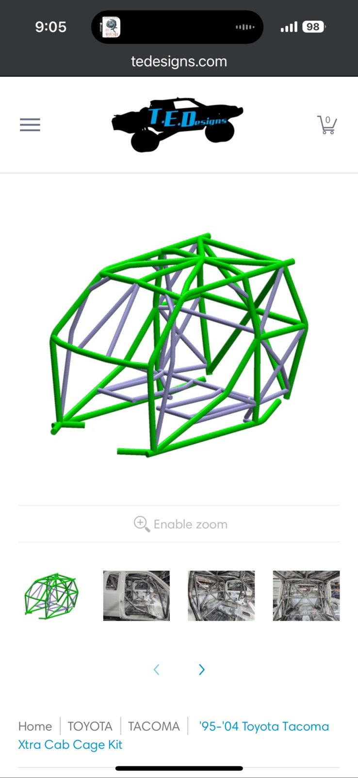

    TEDesigns Finally made a 1st gen cage :anonymous:
    Going to be ordering this bad boy in the next month or so

    Interesting Idea
    im sure if you asked them nicely they can mod (or tell you how to mod) the xtra cab one for the dblcab. My friend has their cab cage in his ranger. it went together like butter & toast. I was using their ranger cage as reference to design mine. Then they go and make it easy for me and release this thang

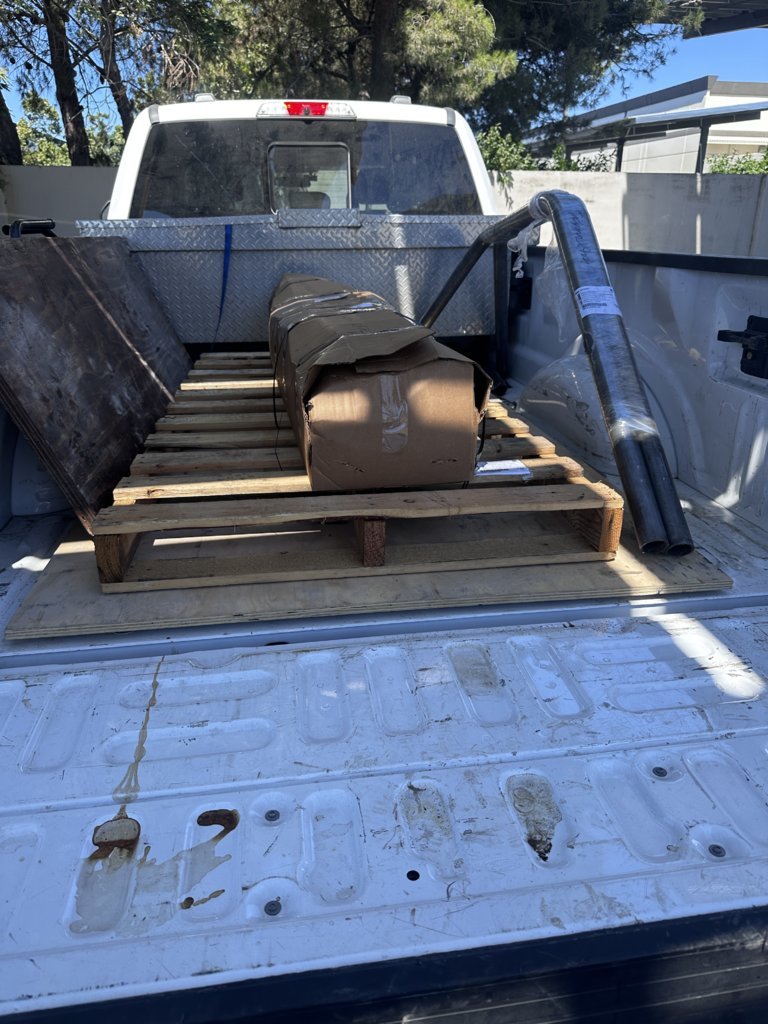

  14. Aug 21, 2024 at 12:37 PM
    #514
    Robmonster117
    Robmonster117 [OP] Well-Known Member
    Sep 29, 2013
    #113490
    1,963
    Robert
    Gilroy
    02 ext. cab 4x4
    Truck parts
    Cage acquired. This should be interesting.
    side note: 8ft bed on the 250 is the smartest decision I’ve ever made.
  15. Aug 21, 2024 at 1:35 PM
    #515
    essjay
    essjay Part-Time Lurker
    Nov 29, 2018
    #274276
    3,311
    Concord, CA
    2011 Tacoma SR5 (V6/AC/4WD)
    Internal or exo?
    edit: Nevermind, I see the post above with tbe example photo.
