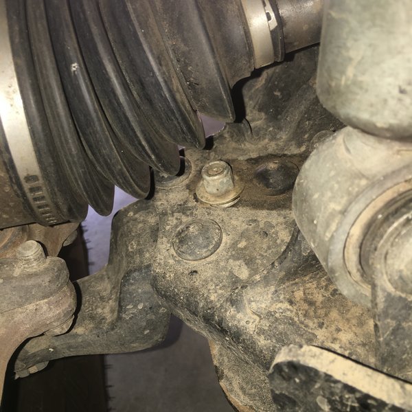

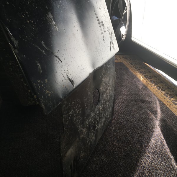

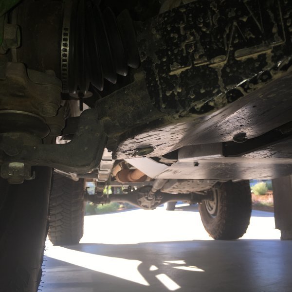

    Alright I couldn't find the other pictures I had. My mac is screwing up lately. So I took a couple while i was mashing my skidplate back into shape lol
    Right inbetween those three studs that hold the lbj cup there is a circle hole on top and bottom. Drill straight up from underneath and be sure to step up your bit sizes in small increments, otherwise you're going to be drilling for a long time and probably burnout your bits. I think the largest size at the end was a 3/8 bit
    And the skid carnage.
    Rock definitely beats steel

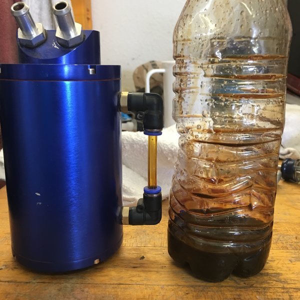

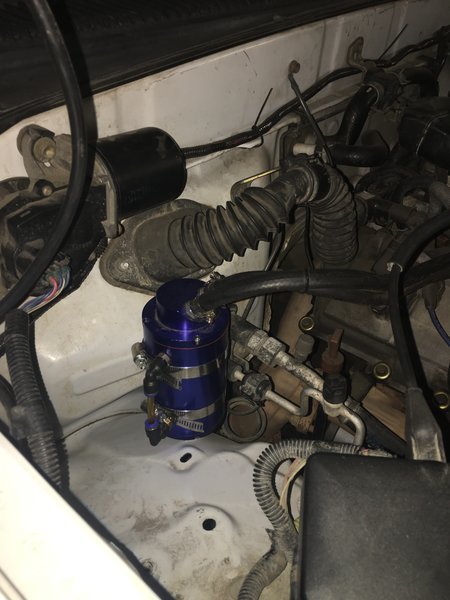

    Finally had a productive day got a few odds and ends done for the truck.
    1st
    Relocated and emptied my oil catch can. I drilled two small holes and riveted two band clamps to the firewall. Looks much cleaner than my Original brackets and bolts jig.

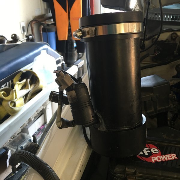

    02 ext. cab 4x4
    Truck parts

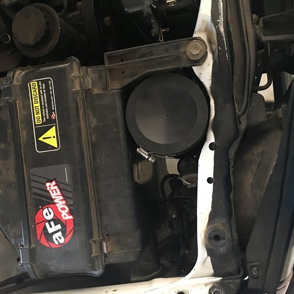

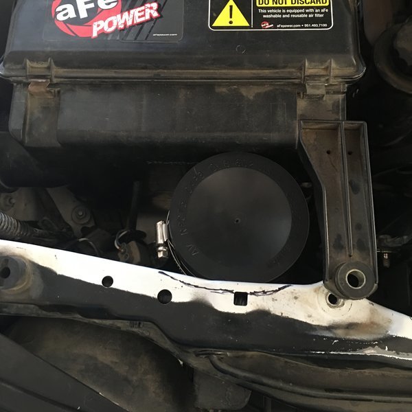

    2nd
    I finished up my windshield washer resi.
    Please exuse the fact that it looks like an IED...
    Materials used:
    -3" abs pipe cut to lengths unkown (I can pull it and measure if anyone is curious.
    -3" abs end cap for the base glued on using abs pipe sealant.
    -3" rubber endcap for the lid.
    Final volume is just over 1liter. Not too terrible at all.
    And for mounting hardware.......
    Good-ole velcro! :rofl:
    I tried making some metal brackets but they were flimsy and complicated.
    So I opted for a pad of velcro on the base of the reservoir to hold it in position and stop any rattling.
    The top rubber lid acts as a good rattle buffer and the fit in the small space is so snug it hardly moves at all.
    When all was said and done it fit perfectly under the lip of the radiator support. But for easy access I trimmed the metal a tad.

    I'm gonna straight up steal your washer reservoir idea, Rob. Plan on me bugging you for details soon.
