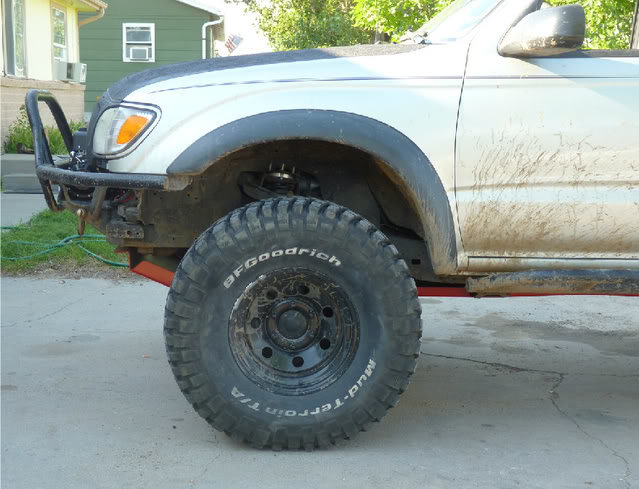

    They are actually made by Pro Comp... You might want to give them or Wheeler's a call and see if they can be had in the same style you're looking for. The only difference might be the BS, but I'm not sure.

    From what I can tell, the Wheeler's 4" BS is the only one of the two that they identify as being able to clear the calipers, not the 4.5". IIRC, the Pro Comp wheels being sold by Wheeler's is a special run because it's set up specifically to work/fit perfectly with Tacomas with the larger calipers.
    Also, 3.75 is recommended because the Series 52 wheels don't appear to be available in 4" so 3.75" is the next best thing.
