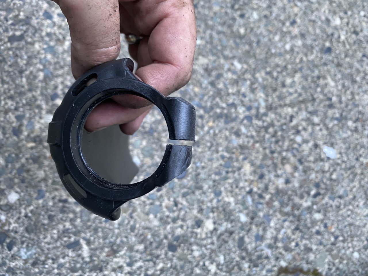

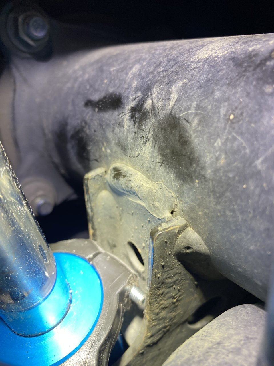

    Byw these don’t fit great on the right rear. I installed one tonight and had to grind some material off the pinch bolt area of the guard. It hits on the stock shock mount and wouldn’t clip into the grove without material removed.

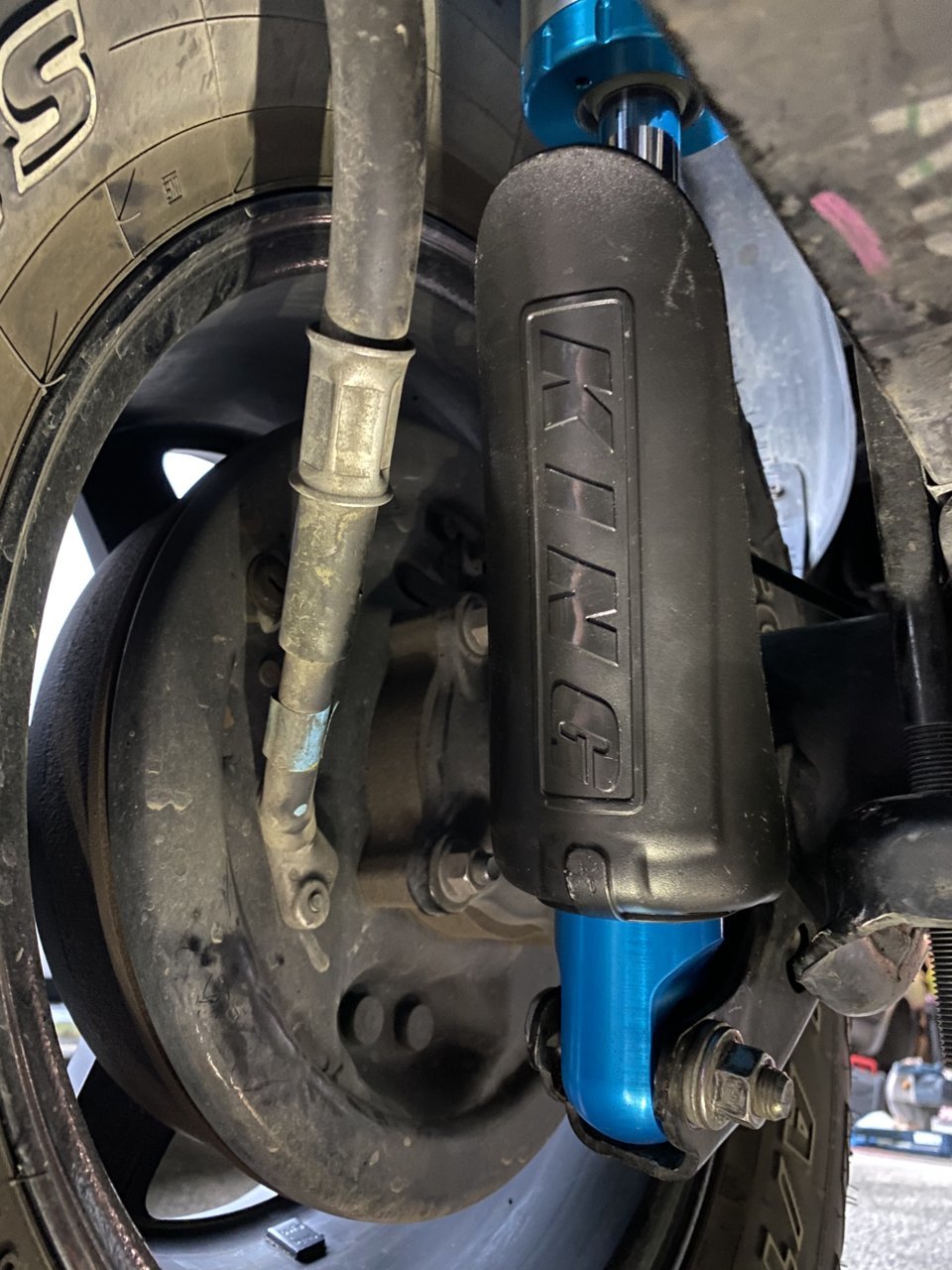

    installed the cali raised skids with my 5160s over the weekend.

    Those look decent! How was the install?

    very easy. The bottom bolt used to hold the shock in goes through the guard to hold it in place.

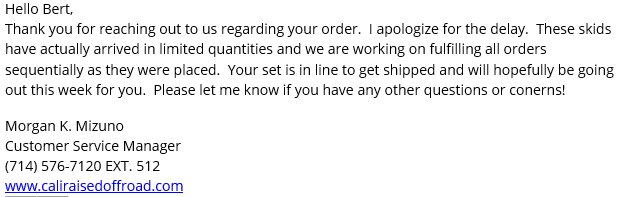

    Still waiting... Here's the response I got last night...

    Why does it look like that shock reservoir is missing it's end cap and is empty?

    It does but that's how they arrive from Bilstein. I believe some people have found a way to cap(sleeve?) the ends. Might have to search around the forum for that.

    No bumpstop? Assuming this was mid-install...

    He apparently put on some Timbrens
