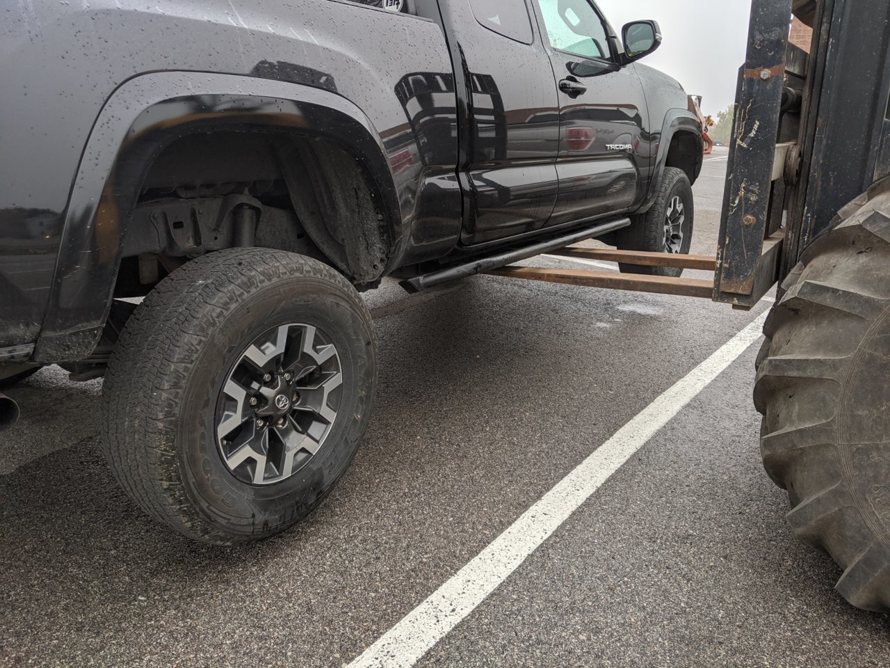

    I've got RCI angled, keeps too many people from mucking about on the truck too.
    If you don't get step plates (many manufacturers offer them) deff put 3M (or similar) traction tape where you step.
    Also, factory/manufacturer powder coat. It's worth the coin.
    Another point, make sure what you're getting has either angled or rounded endcaps so you don't hang up between the slider and your tire.
    Final point, sliders are worth it. Here's me changing a tire, using the sliders as a "jack point"
