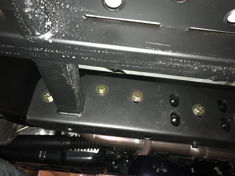

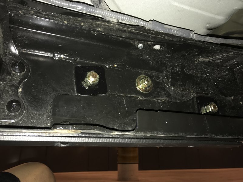

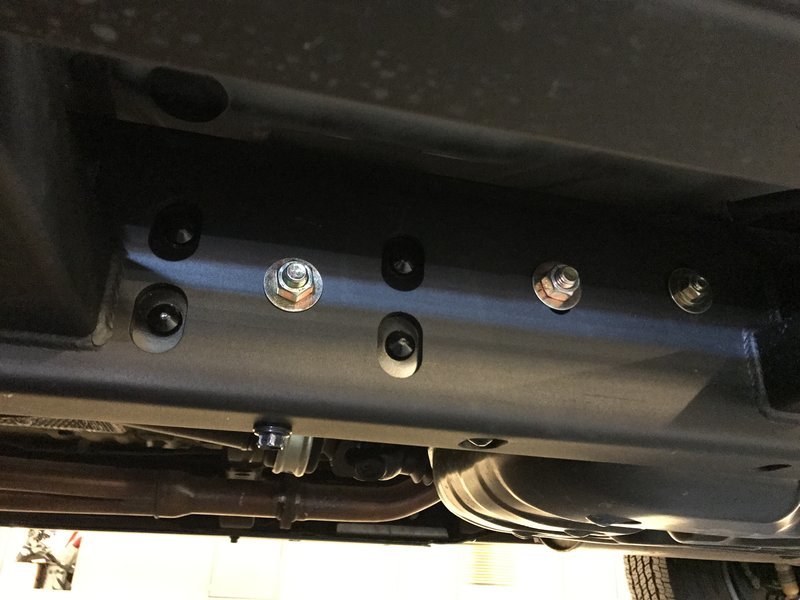

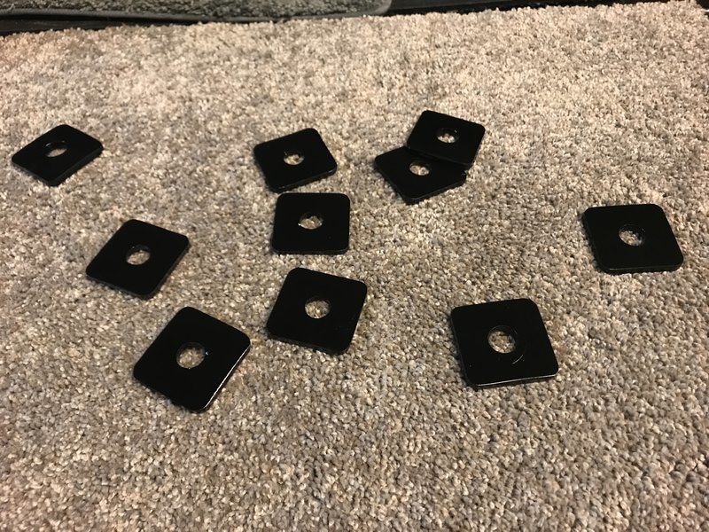

    So, i put 3/8in bolts in the smaller holes and then took all of the 1/2in bolts with heavy duty washers out and painted them. Sliders didn't move, i also didn't move the truck until the next day after i put the bolts 1/2in bolts and painted washers back on. To create more space with some of the electronics i decided to point the bolts out on the driverside while keeping all the bolts facing in on the passenger side...had to fight OCD, but i think i'm okay. ¯\_(ツ)_/¯ Now to get more rubber grommets so lines don't rub against bolts.
    Painted heavy duty washers:
    Installed:
    Outside drivers side:
    outside passenger side:
