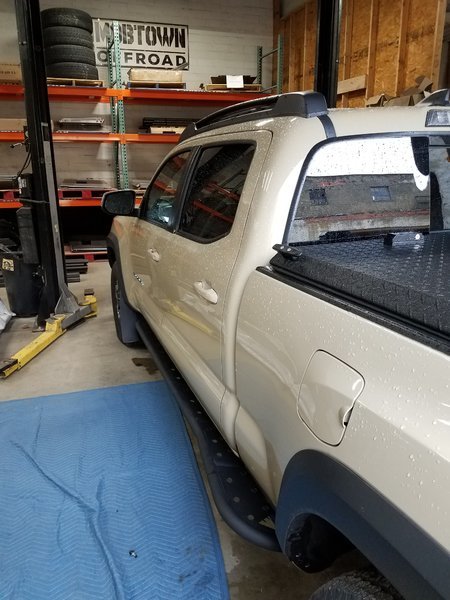

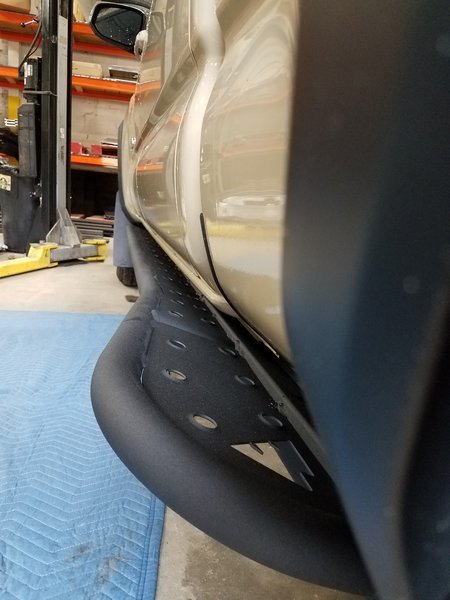

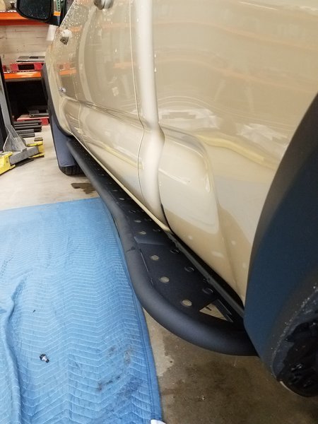

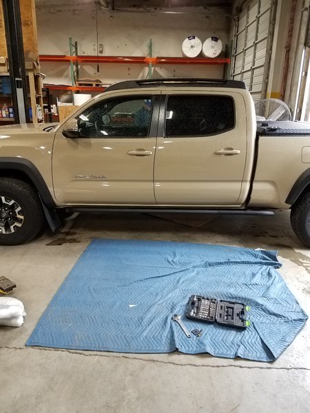

    @Mobtown Offroad Great thread OP! I've been tossing around the same question and researching like crazy for bolt on sliders and this photo of the DCLB with fill plates solidified my decision. The clincher for me is that you've got Hawaii roots. Can we put together a group buy? What's the shipping to Las Vegas, NV zip code 89117?
