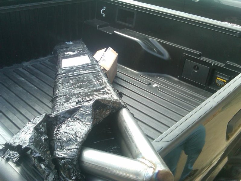

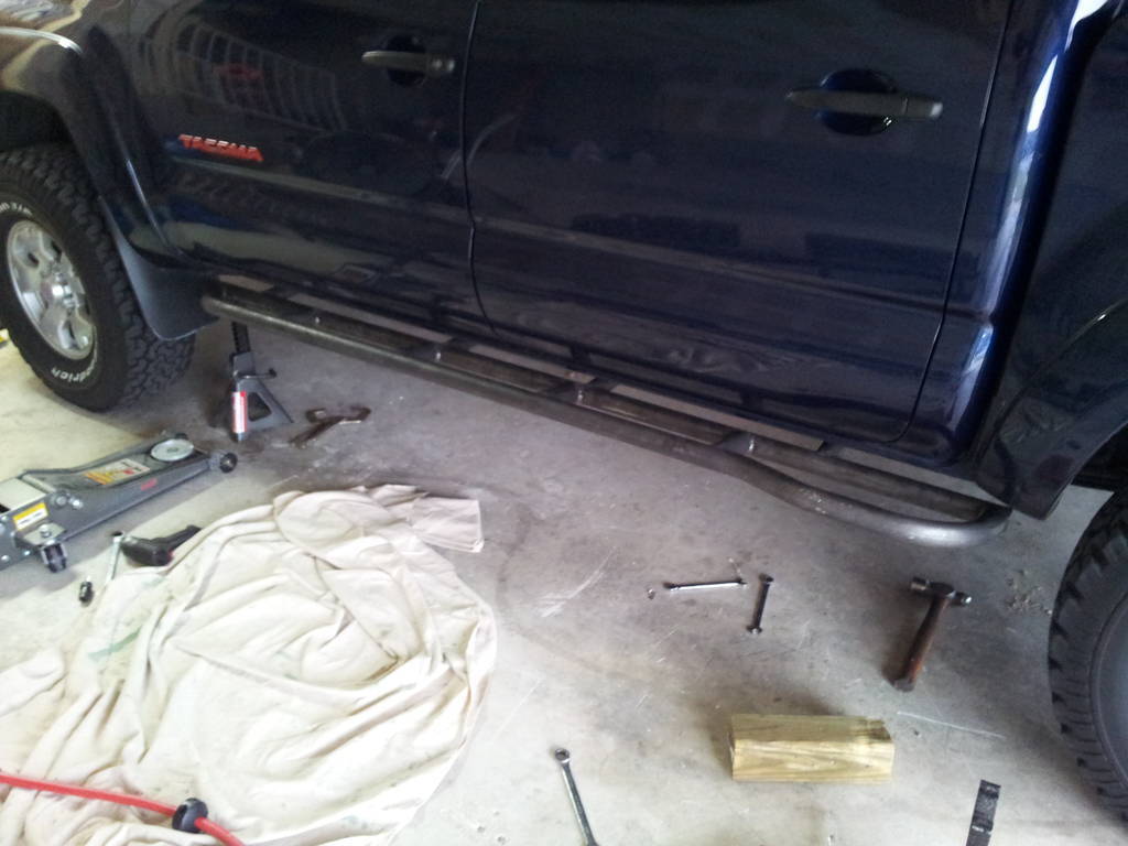

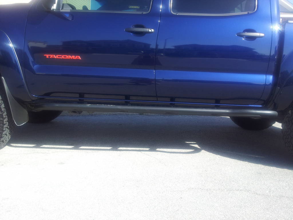

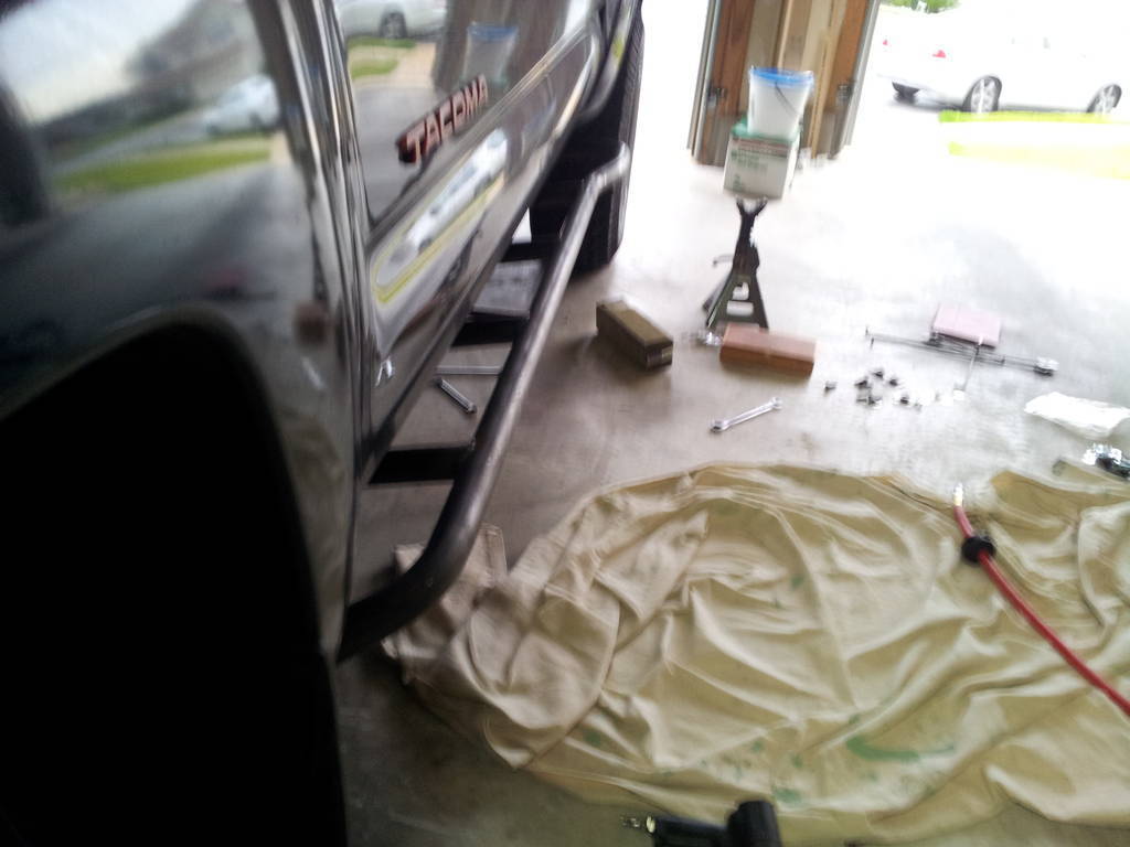

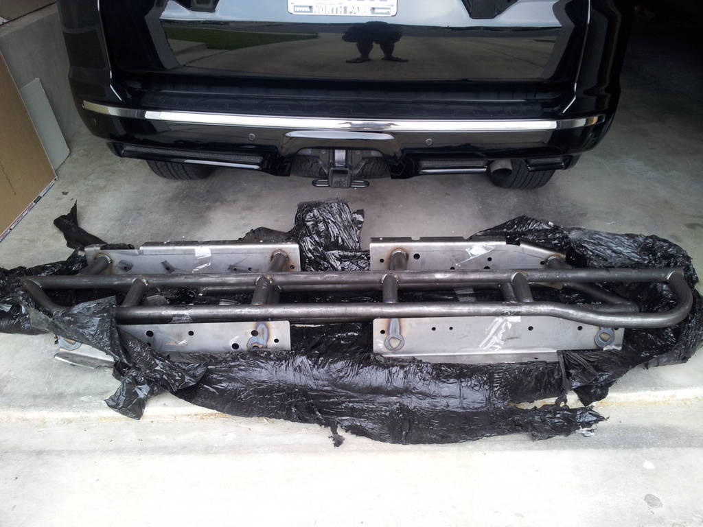

    Got my sliders painted and installed
    Arrival
    Test fit
    Painted and installed
    Thanks Adam. Many compliments on them

    Nice job!
    What did you use for paint?
    Adam recommended POR-15 primer and topcoat.
    When I get mine (2012 AC) I will probably put an additional coat of bedliner for rock chipping and traction when standing on them.

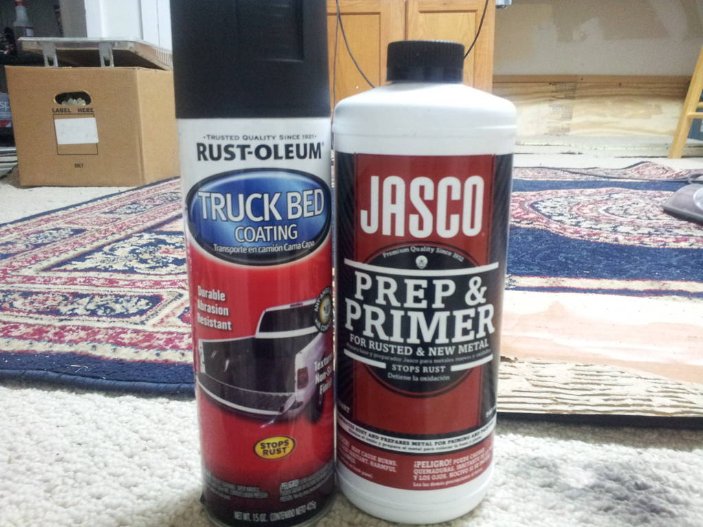

    Below is what I used to clean and paint the sliders. I also used a black metal primer which I did not have any more of. All of the paints were purchased at Lowes. After I cleaned the sliders with the Jasco I wiped with a white towel and it left no marks or dirt so I know it worked well. I sprayed 3 coats of the primer and bed liner. People think that they are powder coated.
