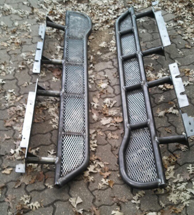

    I need some assistance with the bolt-on version install... :
    How exactly do they mount (anyone got underside pics?) Biggest confusion are the backs/plates with the rods welded to them (2 short, 2 long) - is to reach near the front of the frame while you bolt them?
    Drilling is for the smaller black bolts on the bottom side, am I correct?
    :/ wish there was a schematic for this :/
    they ARE pretty sturdy, and a pain to move around.
    Thanks

    The two longer legs are for certain trucks that need a longer leg. All 8 leg kits we recommend the rear leg be mounted far enough back that it actually attached after the frame starts to make it's taper up over the rear axle. The leg doesn't need to be much longer there but it is shipped long so you can trim it to fit how you want it to be mounted.
    Yes the nut plates with the rods attached are to slide up into the inside of the frame rail at the front, where it is boxed. A tip, when you tighten those, let them rest against the frame so the action of tightening the bolt also tightens the rod against the frame. This will keep it from rattling.
    You'll need to drill one hole on the side of the frame, at the back, and 4 of the bottom holes. There is a bolt that goes up through the frame and through the transmission cross member. You'll need to remove that bolt and drill out the nut, or rethread it to 3/8x16.
    If you have any other questions feel free to give me a call.

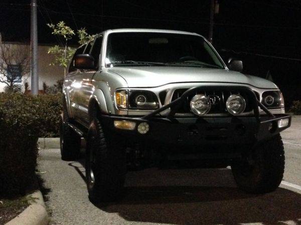

    Pics of mine 4x sliders...

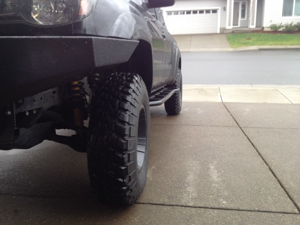

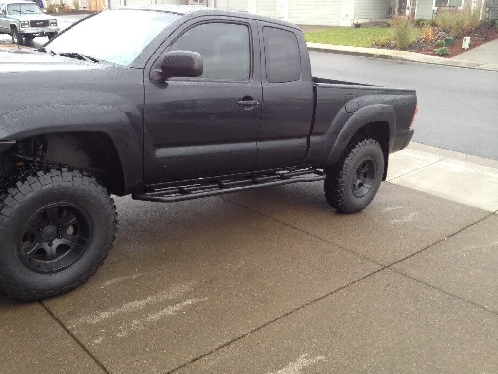

    After selling mine to a friend and buying them back I was able to get them welded on this past weekend. Thanks Adam for a great product at an awesome price
