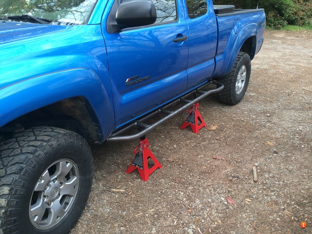

    Got mine today. These things are freaking beefy. They are goo a look food when welded up. Here's a preview of them on jack stands. 9u9abage_9f5afdf19e878117066710574be7a2d008991e56.jpg

    Even after a double post and reading a few times I still don't understand you! haha

    Going to look good. The phone always decides to replace with the wrong word it cut sentences down. And I'm not sure why tap a talk double posted.
