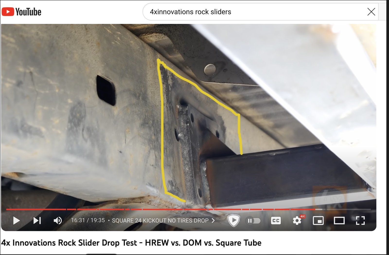

    Question about reinforcing the mounting plate for weld-on sliders (in my case, for a 2014 Tacoma Access Cab):
    This screen shot is from your Youtube demo where you dropped the vehicle 24" onto a rock, and the immense leverage permanently bent the frame of the vehicle inward.
    Would you offer an option for larger, full-coverage mounting plates for an additional cost? For example, like something shown in the screen shot? (See the yellow outline for an approximate updated mounting plate footprint.)
    Particularly if the plate is extended upwards towards the top of the frame, the frame C-channel gets extremely stiff as it approaches the 90º turn at the top, and this area would be ideal for absorbing extremely heavy hits with less, possibly no, damage.

    Please email me directly so we can talk about what you'd like and I can get you a quote for the custom plates. Adam (at) 4xinnovations.com
