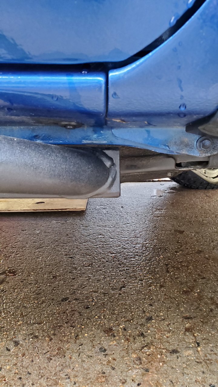

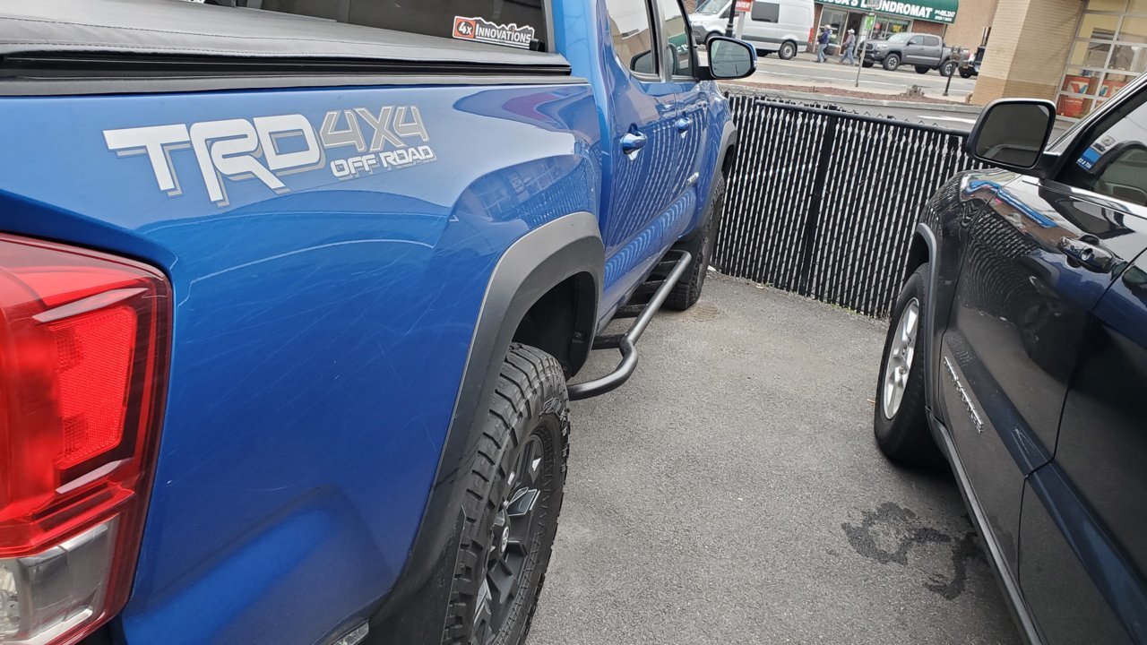

  6. Dec 23, 2021 at 6:44 PM
    Brownmatthall
    Brownmatthall Well-Known Member
    Jul 7, 2020
    #333712
    4,640
    Saratoga Springs, NY
    2016 TRD OR DCSB
