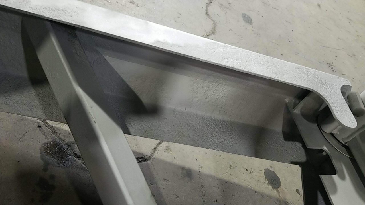

    I'll share a line-x/prep horror story. Local guy line-x'd his front and rear Pelfreybilt bumpers and didn't prep it properly. The line-x flaked and chipped.
    I ended up purchasing the rear bumper because it was a hell of a deal. To not fuck around, I had them sandblasted and powdercoted professionally. They sent pics after sand blasting and the bumper was pitted pretty bad:
    Left untreated and due to poor prep, eventually, the elements would have eaten through.
    Just take your time and prep it properly. Keep and eye on everything and touch up as needed. Remember, 90% of a paint job is prep.
