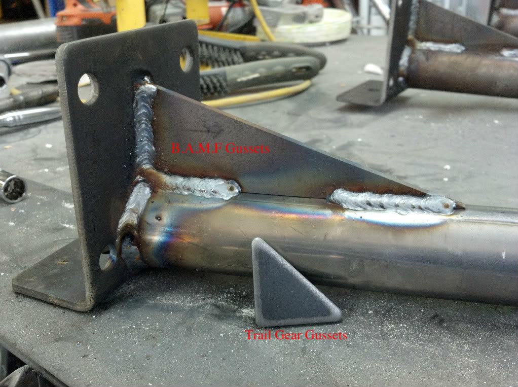

    You also would have to buy the frame plates and gussets for that kit they do not come with them and here is a shot of the TG gussets compared to the vendors on this forum.

    Although the weight of the 2.0 / .120 square is 30% heavier than the 1.75 / .120 round tubing..
    Obviously the square hybrid tubes are going to be stronger, but maybe the extra size and weight is just over-kill. If 1.75 round allows the truck to be jacked up, more strength seems unnecessary.
    If you think about it the weakest point of the sliders are the mounting welds and the gussets, and the gussets for all the sliders are 3/16 plates, so it's the same. Bending any kind of steel sliders is going to be nearly impossible unless its a major wreck...
    And IMO the thicker sliders look to bulky and ugly.. When I buy mine I'm probably going to go with the cheaper ones because I really just want them to step up on and protect my sides from other drivers throwing their doors open..
    And if I do my occasional light off-roading, I'm sure they'll still protect my sides from rocks and debris..
    Although I'm not a 4wheeler so I wont actually be sliding down a giant rock wall...
    OP just think about how you're going to use them and what kind of strength to weight ratio your truck will require and factor in how much you want to spend ya know?

    Yeah but jacking up and dropping down on to a rock are two different things The Hybrid slider is a far better design then full round tube.
    and if you look at the picture above not all 3/16th gussets are the same.
