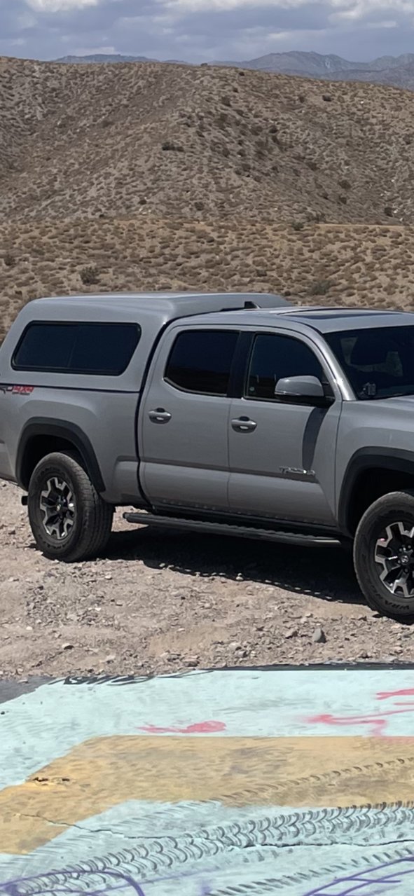

    Hey, It looks like my rock sliders are sagging towards the rear, is this normal? and sorry for the poor photo as well

    Are they tied into the frame or just bolted to the cab like side steps?

    Bolted to holes in the frame

    Is the other side like that?

    Yeah but maybe like a half inch higher, I made sure all the bolts where tight.

    What brand are they?
    Mine have a steel plate that is bolted and runs alone the bottom of the frame and I can jack the truck by them.

    Cali Raised Off Road brand, thats what I am thinking maybe I forgot a plate but honestly the directions from Cali Raised were pretty poor for the long bed model could have used more pictures.

    They shouldn't bend down or up.
    Not normal, maybe someone else can chime in.

    Check the bolts holes on both sides? Have a heavy something on the one side momentarily? Maybe enough to push them down a bit in the bolt holes?

    It's this a photo after install or a photo after bashing on them?
    :cookiemonster:
    Maybe take them off and see if your brackets are parallel

    I just purchased some never installed Mobtown sliders and mine look the same. I can't figure out how to seat them completely against the frame. I've undone the front bolts, jacked up the rear, jumped up and down on the front trying to level them out and can't figure it out. Hopefully someone has a solution here!

    Are there holes for adjustment? Looks like its slipped down unless someone big stepped on them and bent it

    On mine there is about an 1/8" gap between the slider and the frame in the rear. It's like the channel that seats against the frame is too narrow at the bottom.

    Given that sliders are designed to take the weight of the truck slamming down on them...that would have to be a very large person

    I have Cali Raised Offroad sliders installed myself few weeks ago.
    Just went and took measurements.
    My passenger side rear is about 0.5cm lower than driver side rear. I thought I did a good job of leveling.. but guess not.

    Or not tight enough bolts? I just didnt know if there was adjustment in them or they have a fixed location

    I can't speak for CaliRaised but mine came with a frame plate/captured nuts that went inside the frame rail to accept the slider bolts. There wasn't any room for adjustment but again these were different sliders
