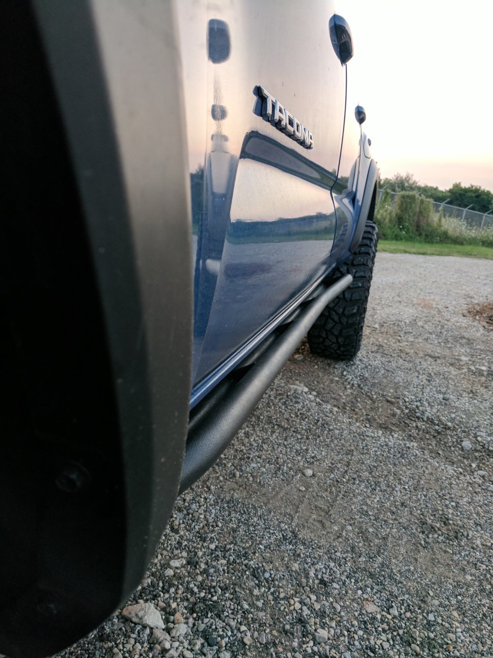

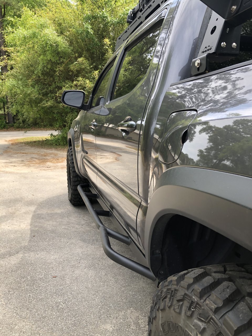

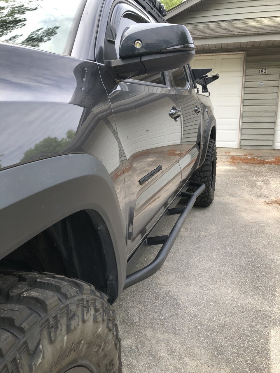

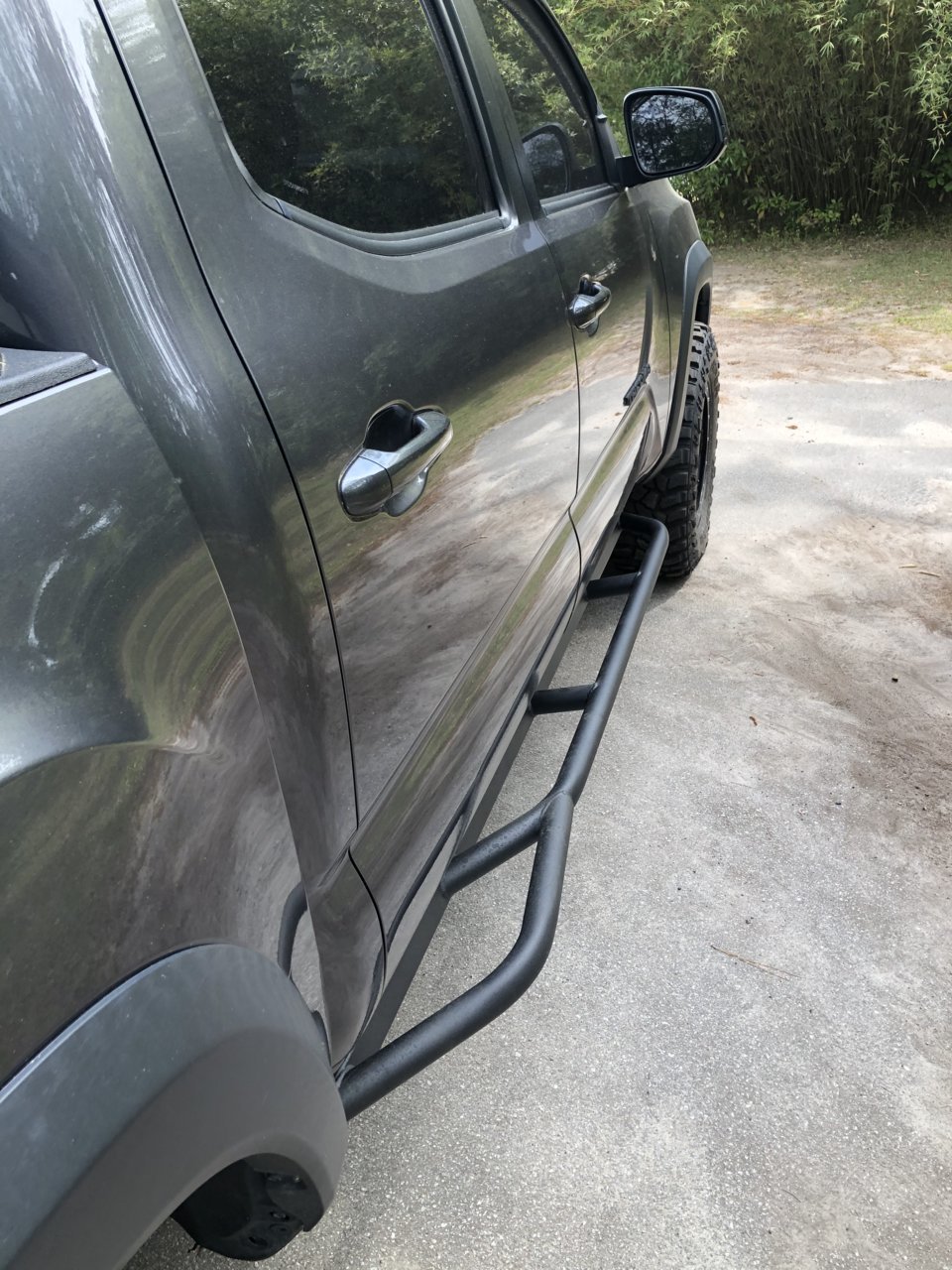

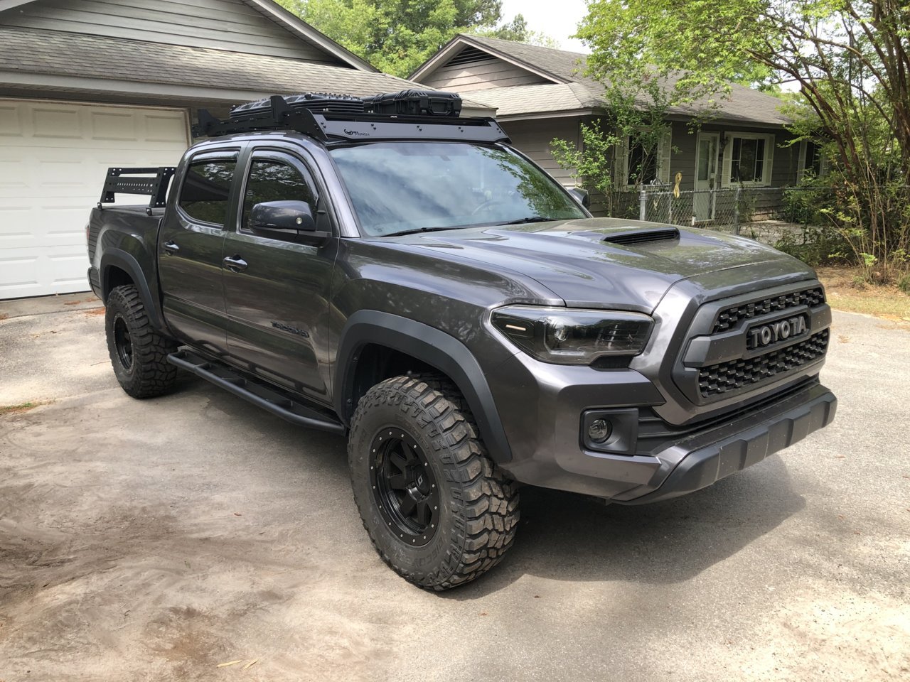

    Here are my SOS Concepts sliders. I use them as a step as well. The wife if 4’8” and has no problem getting in and out.
    No shots with the door open but maybe these will help.

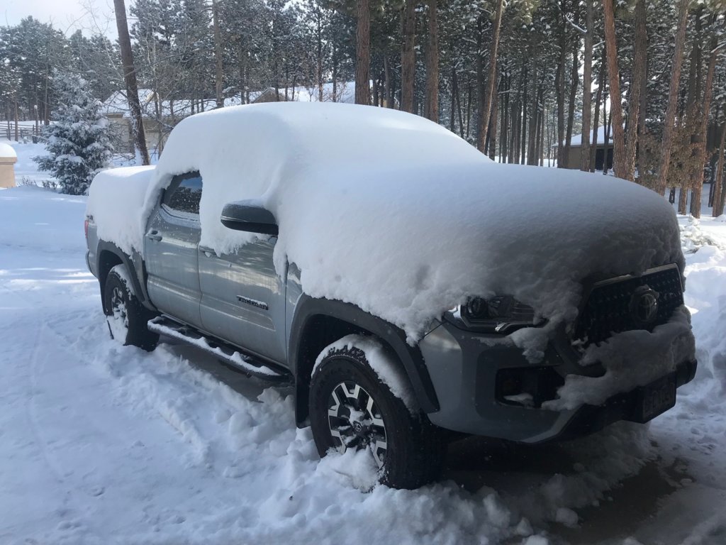

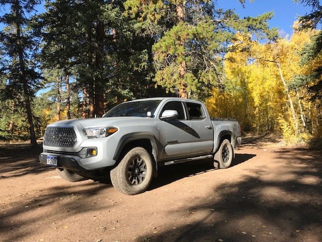

    Not sure how else I can show this but it works for us with dogs and Wife getting into the truck.
    The nice thing is with the "kick out" is when wheeling, some rocks get pushed away from the Tacoma. To each his or her own, BUT the kickout I have and the angle works great for the type of wheeling we do.
    Just my 2.5 cents.
    If you are looking for the "BEST" off road setup then tuck the sliders up close to the frame.
    You will get a TON of responses that the way I did it was "WRONG" ....however, I wheel the truck every weekend on mild trails and when it gets "Crawly" My sliders keep me safe!

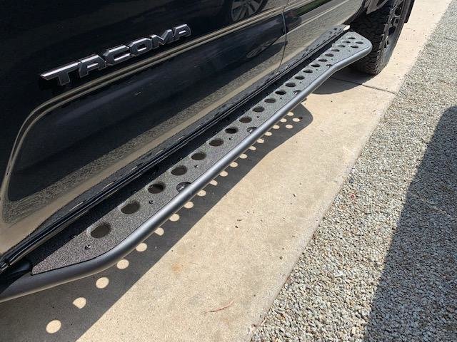

    I liked the design of All Pro Apex, being very tight to the body, bolt on, high strength DOM, the lightest DOM slider option, and offering a full top plate step. Looks clean and highly functional. I realize mine is a 2nd Gen, but it is the same product for 3rd Gen.
    Thread: https://www.tacomaworld.com/threads/all-pro-apex-bolt-on-sliders.450494/
    Install pic:

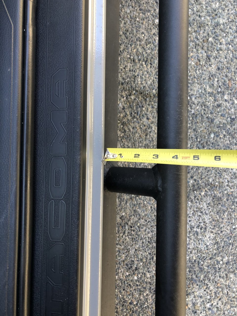

    Thank you guys for the input. Thanks msgs350 for the measurement photo that's exactly what I need to see to make my decision.

    Awesome! Most folks do not show the "Plus/Minus" with the kick out OR the lower degrees on the sliders.
    For US.....we have never seen an issue on the trail. Period.
    Yes....2 inches in a "TIGHT" area we had to take another line. Literally backing up a foot. Then moving forward a but,
    Honestly, the rear "kickout" has prevented us from certain types of damage.
    Works for us.
