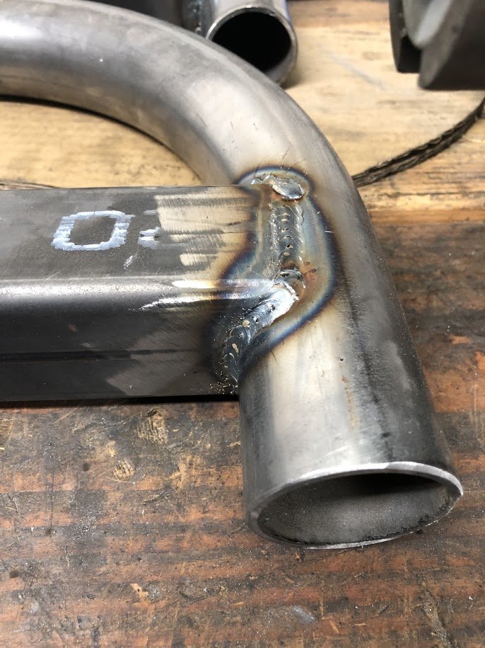

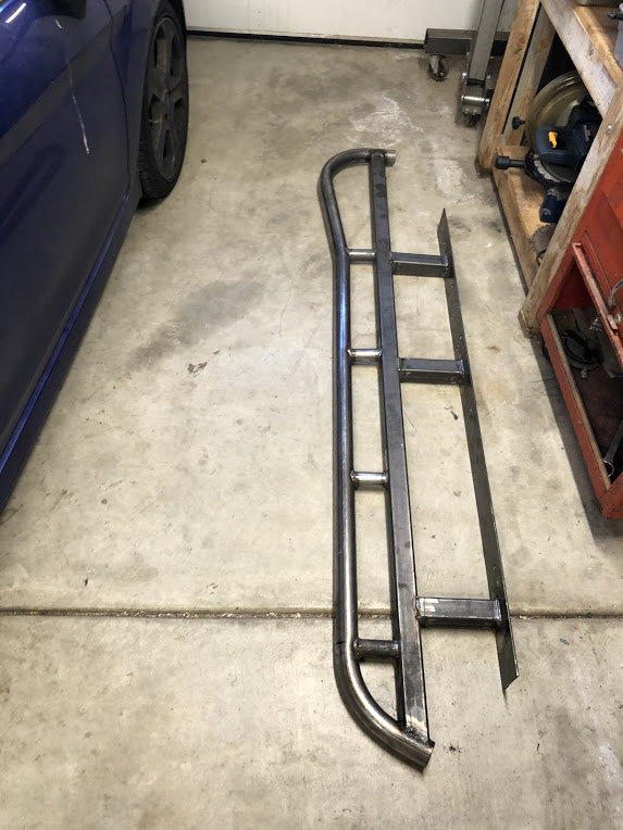

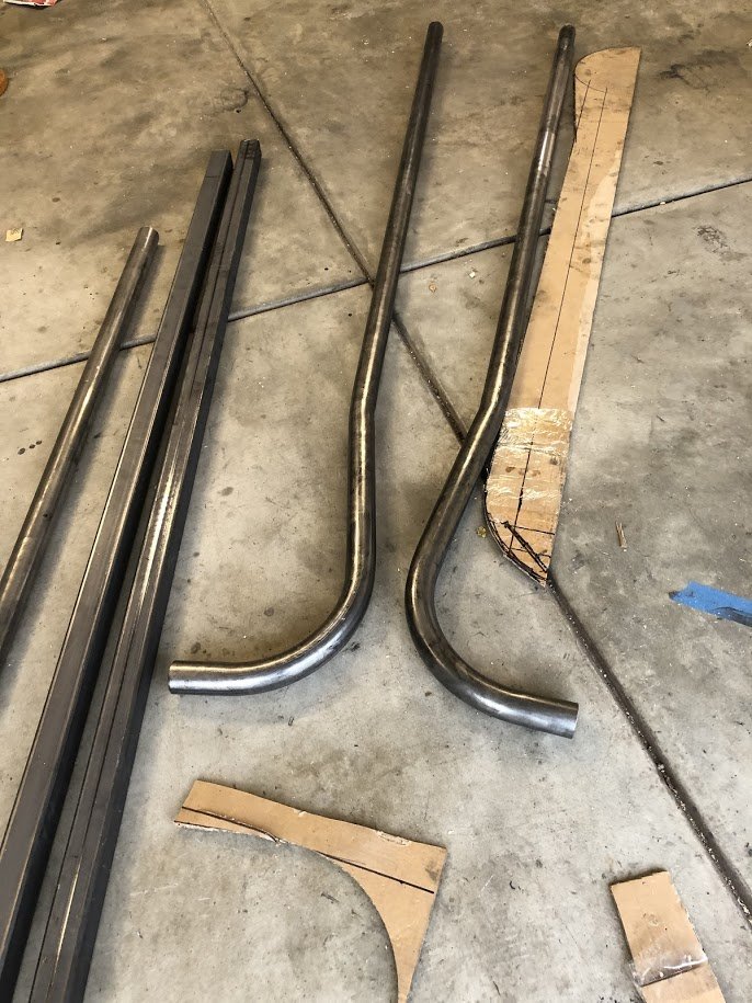

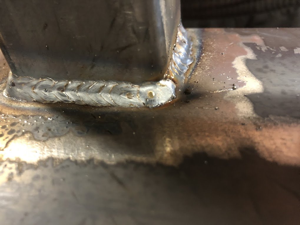

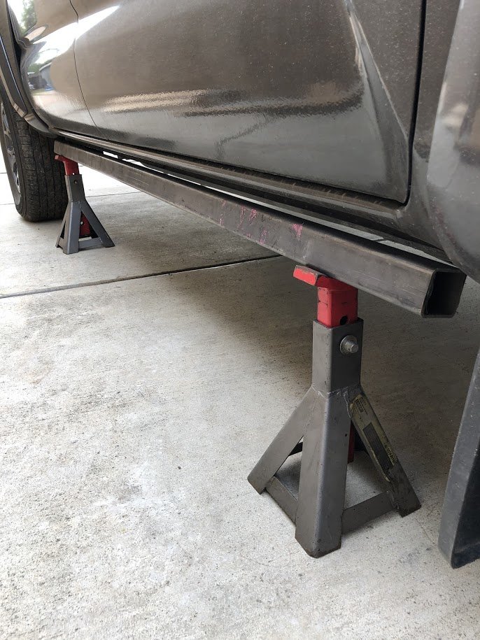

    If you have them custom fabbed up you can build them to your liking. I made my own (I have all the fab tools anyways) and I built them to be 0* and stick out about 4.5" in order to act as a step. I also made them a bit longer than most so it goes tire to tire. I also used 2" main tube for aesthetics. I don't really like the look of 1.5-175" tubing on tacos for bumpers /sliders or anything else. The ratios look off I think.
    I still need to add gussets. I'm going to incorporate 2 bottom crossmembers which will be a 2"x 0.5" square tube that will bolt to both the pass and drivers side sliders (acting like a cross member). This will be in tension as the rock slider is "loaded" giving them more bolt on strength thus relieving the frame rails from some of the load. The cross members will also act as mounting points for a skid plate.

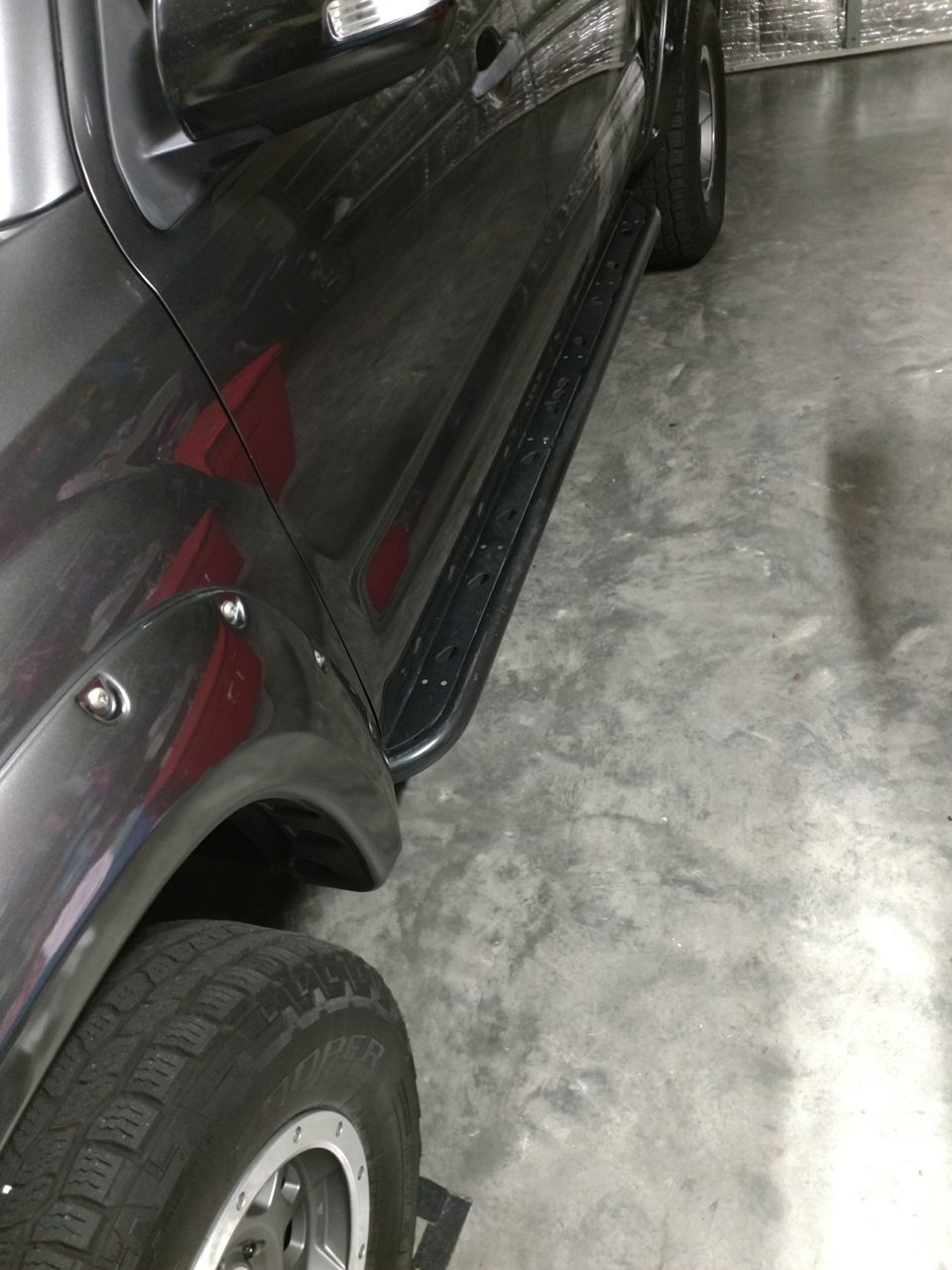

    I hunted for a used set. Took two years but a local guy sold me his Slee Off-road Zero degree sliders with fillers for a fantastic price.
    My kids love them. Malls fear them. Tire rotation is much easier. IMG_20201012_152315810.jpg

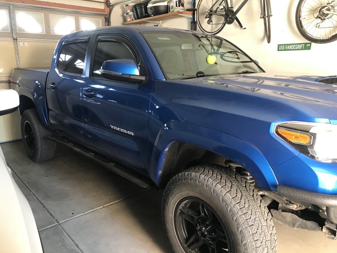

    I got these OCF sliders on Amazon for 800.00 shipped. They can ship them by UPS since they are 2 piece and are bolted together. Light weight, about 100 pounds all together. definitely not what I would use if I was actually rock crawling. they have saved my rocker panels a few times on the ATV trails out in the desert. They're not the best steps but they do help me get in and can actually help me get out to an extent. I don't know if they're still on Amazon or not?
