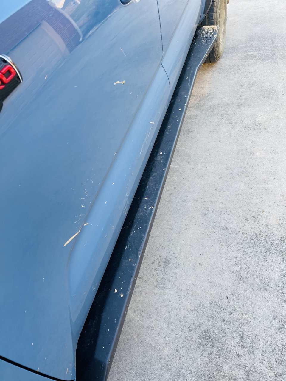

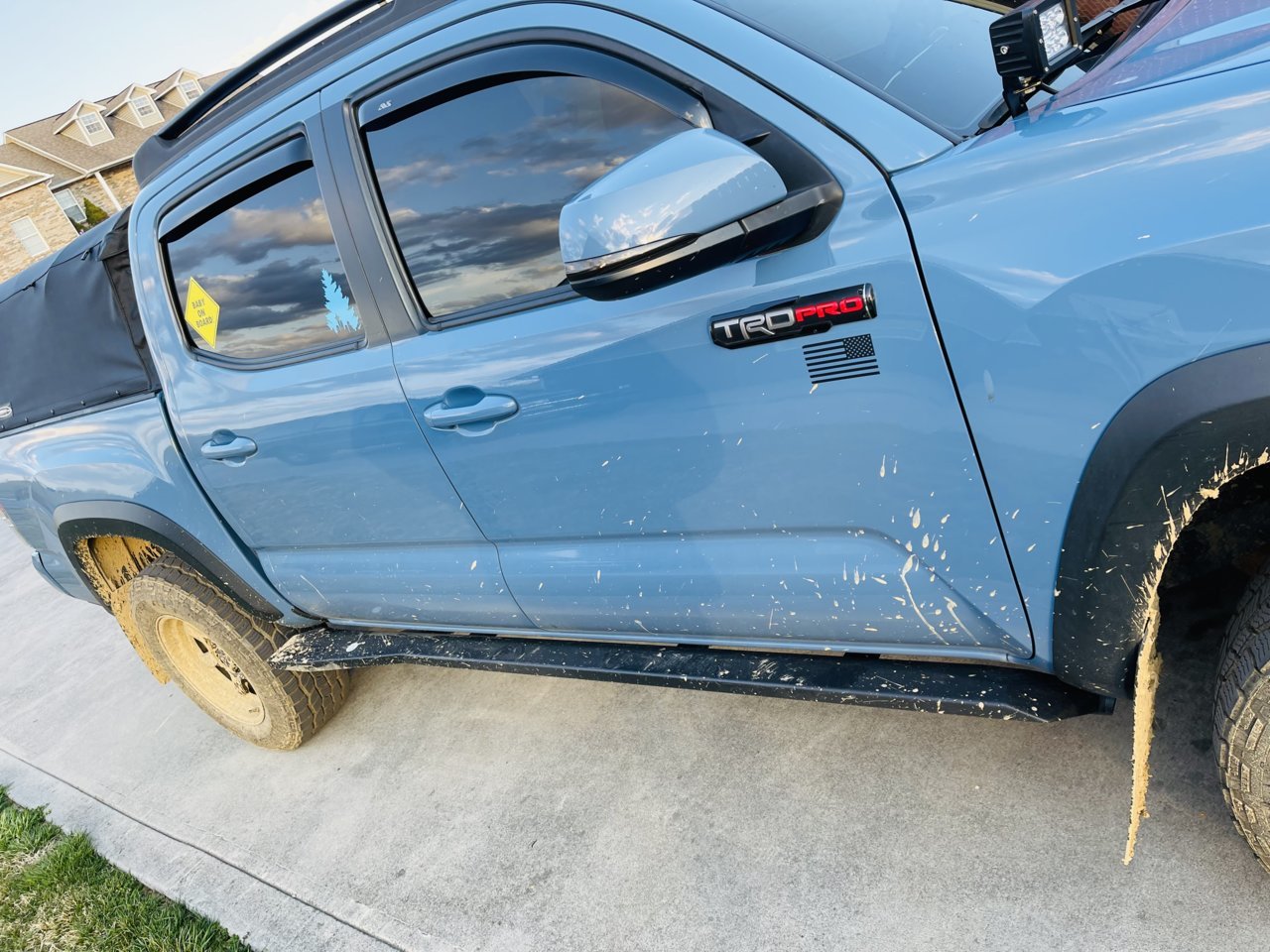

    I went with the 4WP sliders. I like the sleek look of them. They shipped super quick, were packaged well and install wasn’t too bad with just myself, a jack, and a couple jack stands. So far they’ve held up to the couple of hits they’ve taken.6673DF42-A7C5-4464-AC5D-94ABA79FCF33.jpg D79A039C-5B1D-43ED-981F-61B072EDE253.jpg

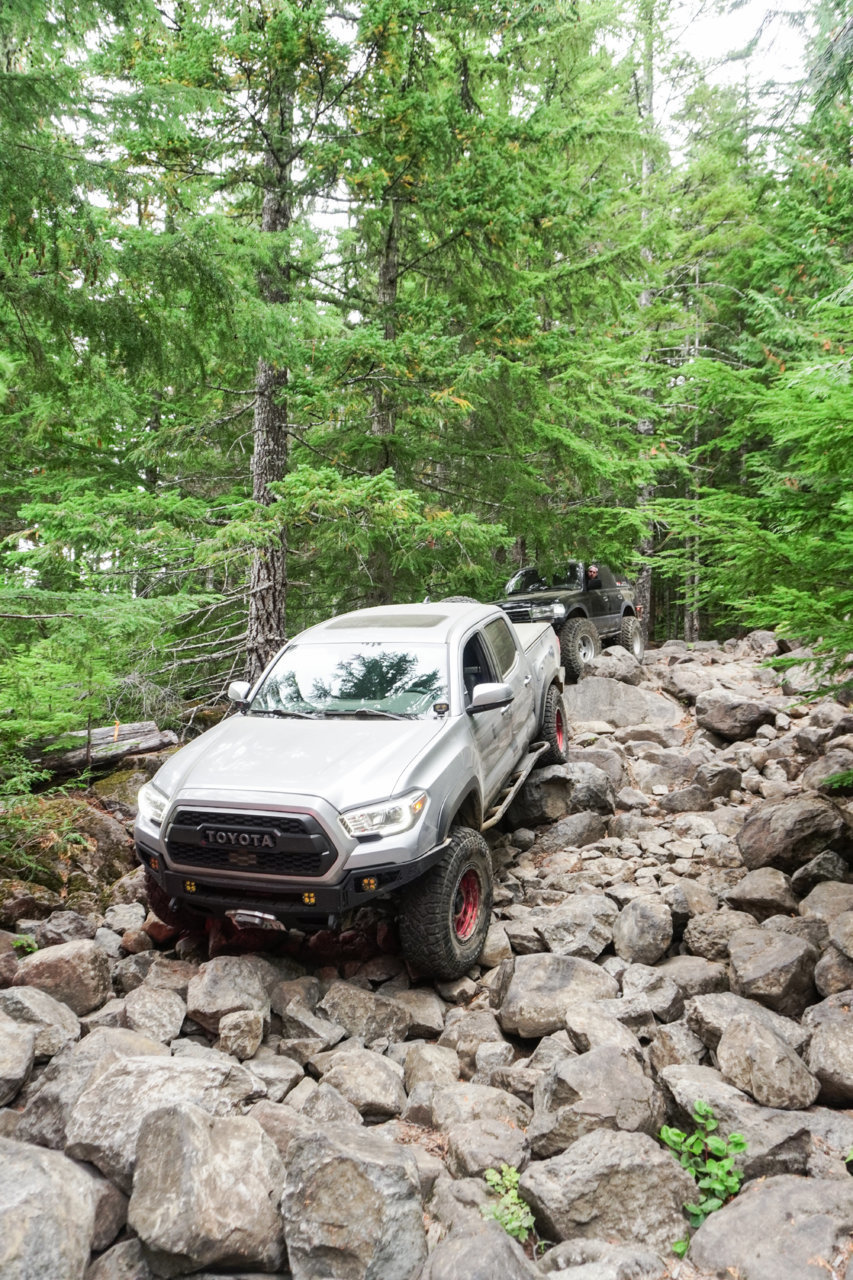

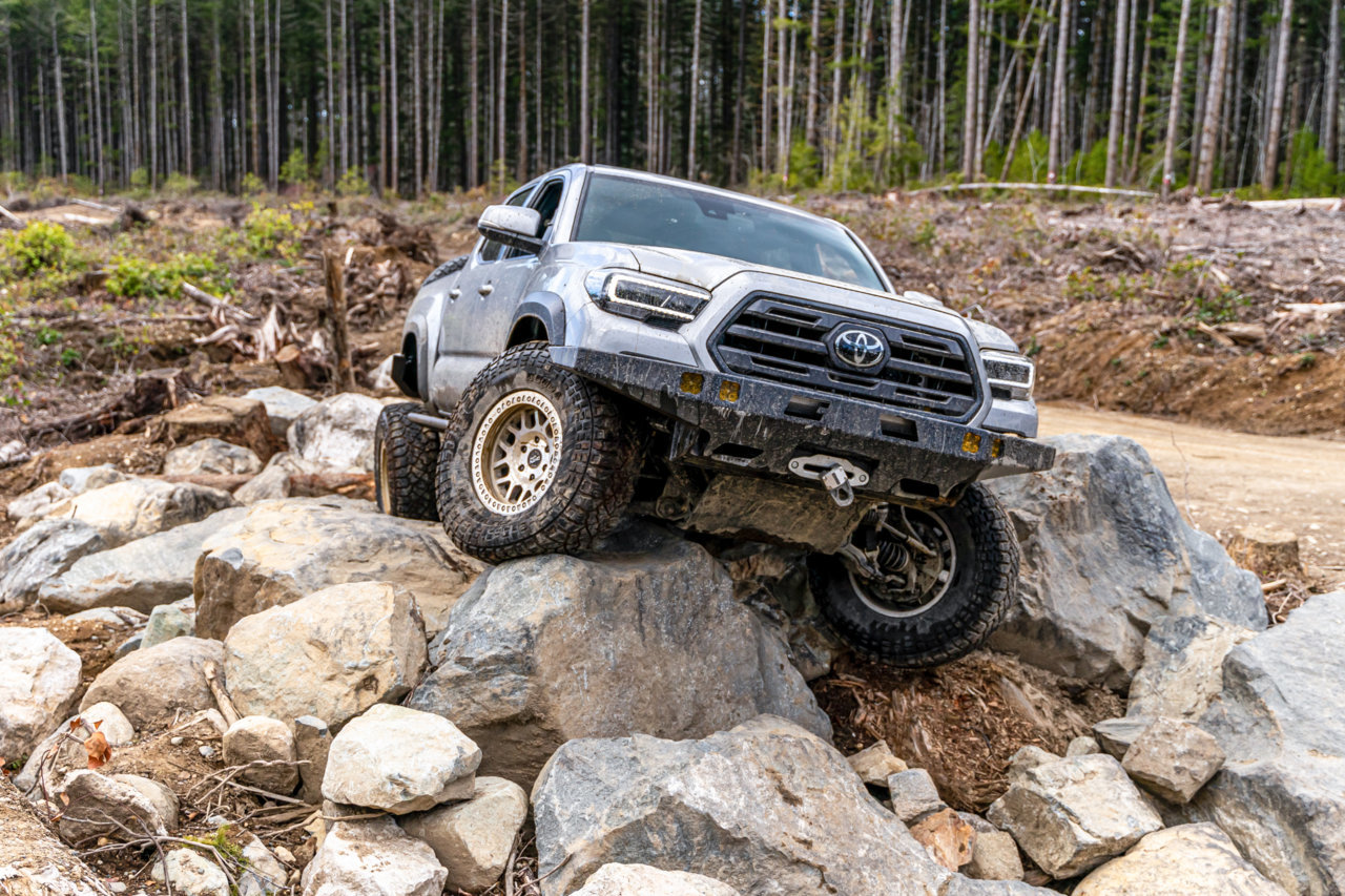

    Thanks! Little different looking now.
    As for sliders, eventually had to cut mine off and lower them since they bent up so far the kickouts wouldnt let my rear doors open. Lowered them a hair, got rid of the kickout, added a 5th leg in the rear, and tied a little standoff to the front body mount. All good now and seem a lot stronger. No kickout is a game changer and also extended the slider so nothing gets wedged between the rear of the slider, and the rear tire.

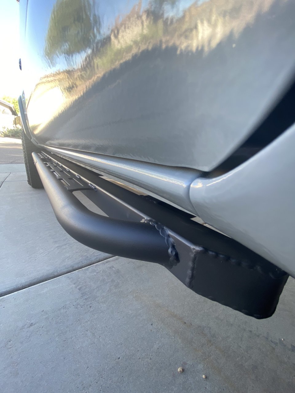

    Had a set of the @PakRax sliders installed from @state48overland and @az toypros.

    How do you like them

    Have you had a chance to test these yet?

    No sir. Hoping to do so this summer during a trip to Colorado.

    Thanks for responding. I looked at them the other day in their shop and they look great. Maybe not quite as stout as some, but they look perfect for my needs. The price is right too.

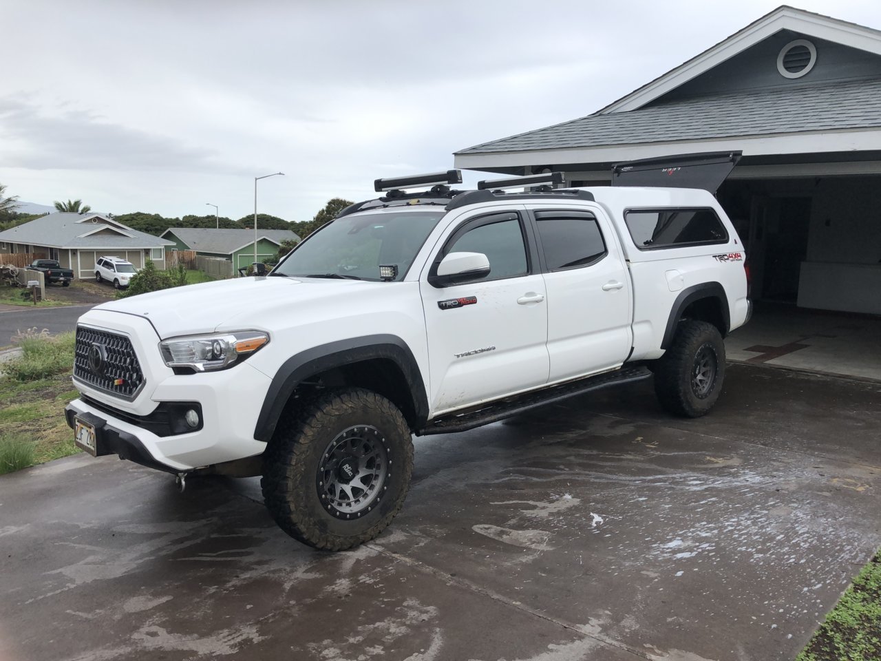

    Never , never use any type of Rhino lining for rock sliders. Impossible to keep clean, dirt, mud, will stains the rock sliders. Powder coating is the way to go.
    I scrub mines, then spray black Rustoleum engine paint. Using cardboard to protect from over spray, takes only minutes , to make look new.
    But I live on a dirt farm, endless.
    Also I have a long bed, had the rock sliders delivered to our local trucking company. Easy P/U.58D66A54-A470-4B5E-AED9-A5BEA363ED48.jpg

    My sliders stick out to where we can use as a step. This design works great for my wife and passengers. Plus car door dings are reduced. I like them too.
