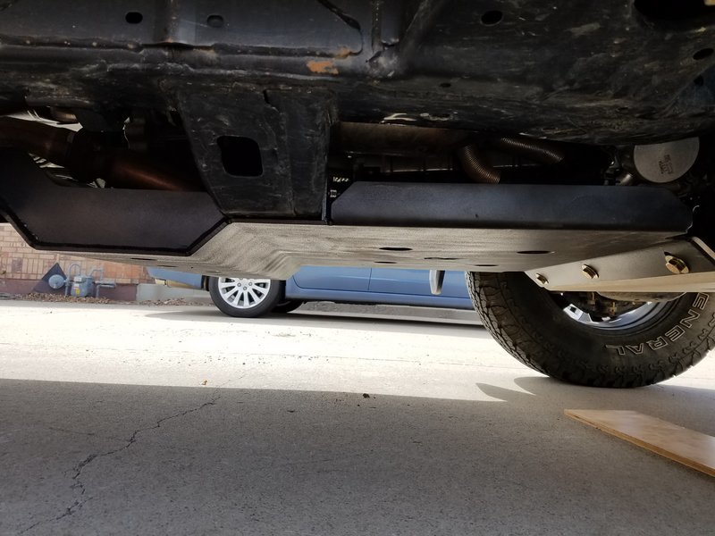

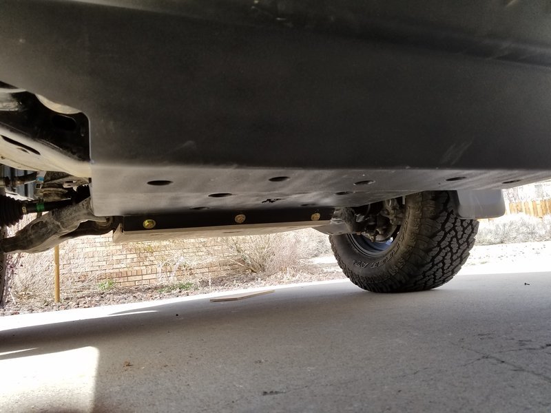

    I used the Rustoleum Spray On Bedliner that you can get in the cans at Home Depot or Lowes. Its pretty durable and has some texture to it which its nice since it covers up if you've never painted before and do a shity job at it (like me) and provide some grip if they're wet. I wouldn't go with Rhino Liner or something like that personally because theres way too much texture in it. Here is a picture of my skid with it.

    Cool. I got four cans of Rustoleum "Truck Bed Coating" spray (same thing?) thinking that would be good. Sounds like you're happy with the results... good to know. Thanks!
    (Thanks as well @Hammer16!)

    Yeah those are the same thing. I used the Rustoleum self etching primer before. A piece of advice is that it comes out very fast and its easy to put it on way too thick.
