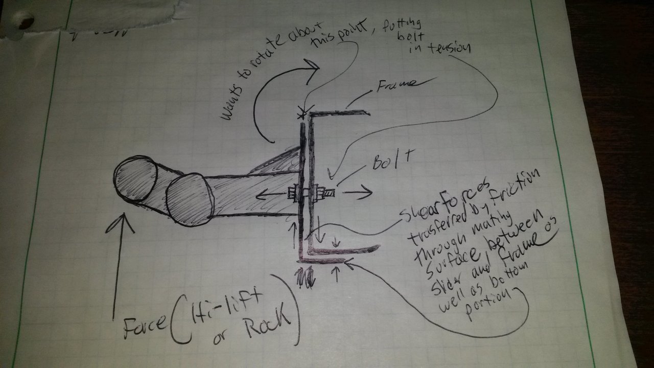

    Musubi3 Well-Known Member
    May 16, 2016
    #187108

    It's no different. This idea that weld-on is better than bolt-on is total bullshit. A 1/2" grade 8 bolt has a tensile strength of over 20,000 lbs and these sliders have 5-10 of them holding them on each side. And the shear forces don't even go through the bolt, they're transferred by friction between the mating surfaces provided by the bolt clamping force. Whether they're bolted or welded you're going to twist your frame before the slider-frame connection is compromised.

    But they would be in sheer not tensile when the sliders are being used, just pointing that out. But that being said grade 8 has a great sheer strength as well and the way I have seen all these bolt on sliders being bolted on any one of them will work well.

    The way they bolt on, there really isn't much sheer force on the bolts. That said, mine are for "oh shit" moments. I don't abuse them.

    If they get used by a high lift or coming down on rocks they will be in sheer unless you are pulling the sliders away from the truck they won't be in tensile. The clamping force puts both sheer and tensile forces on the bolt, more tensile than sheer.

    I'm not sure if I agree. I don't think the bolt should ever be in shear. Here's my thinking:

    You won't always just hit the outside bar, which is actually called a rub bar due to that's what it usually does. In your photo, there'd be no shear force, totally tensile. In reality, you could easily hit right next to the frame or the frame itself so that's where the shear force would come into play. Either way, quality grade 8 hardware with 8+ bolts on each side and you're GTG.
