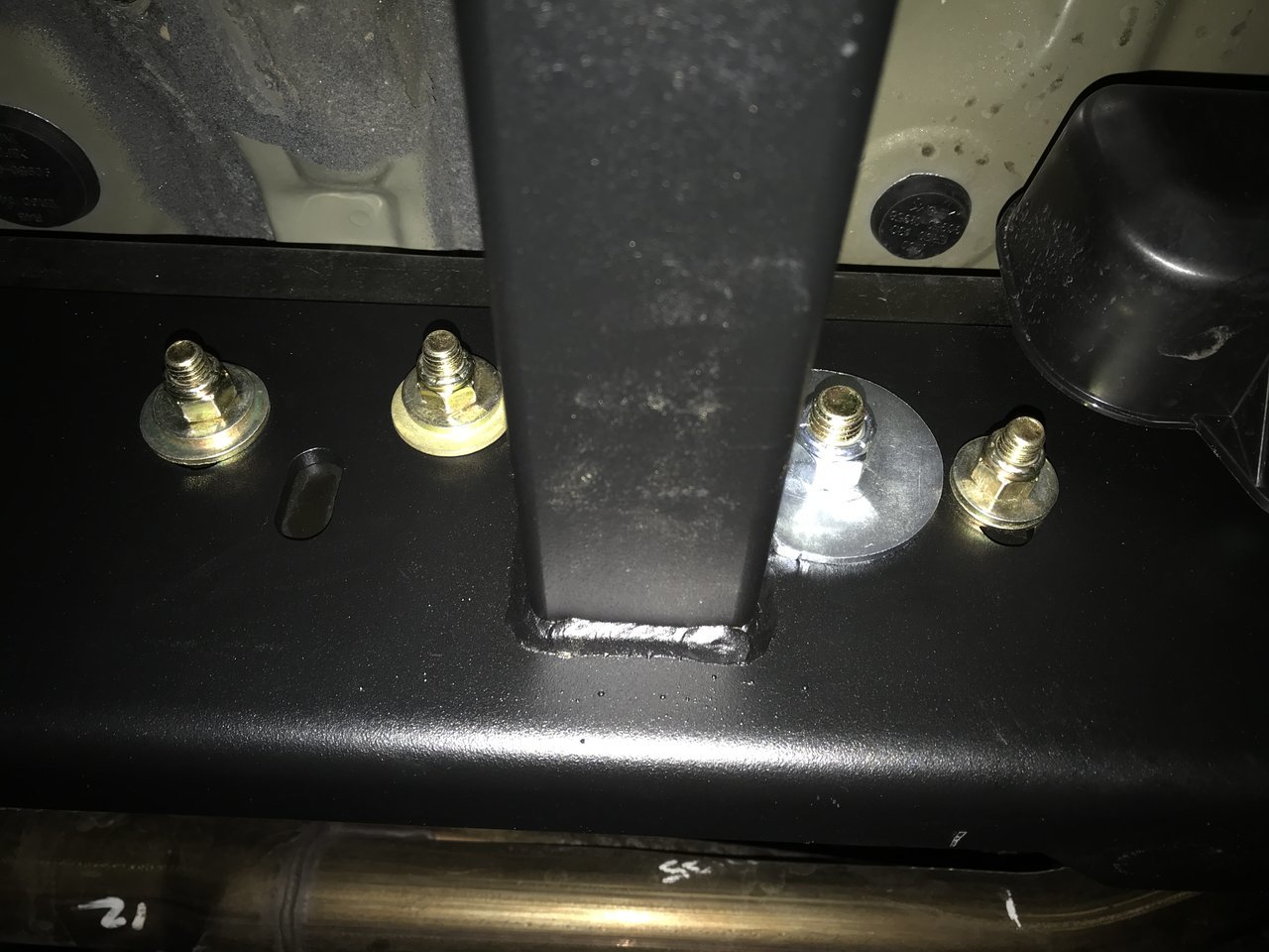

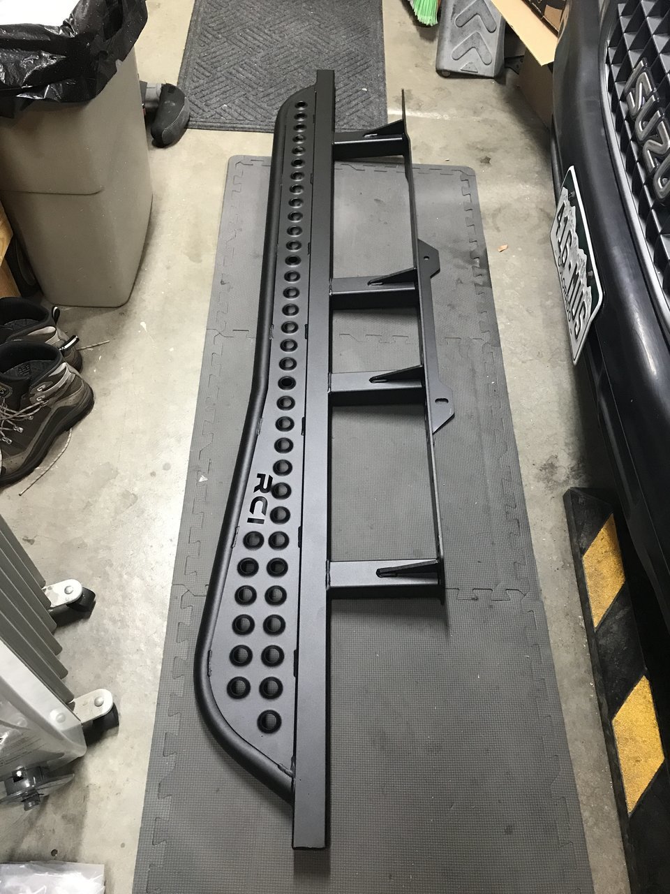

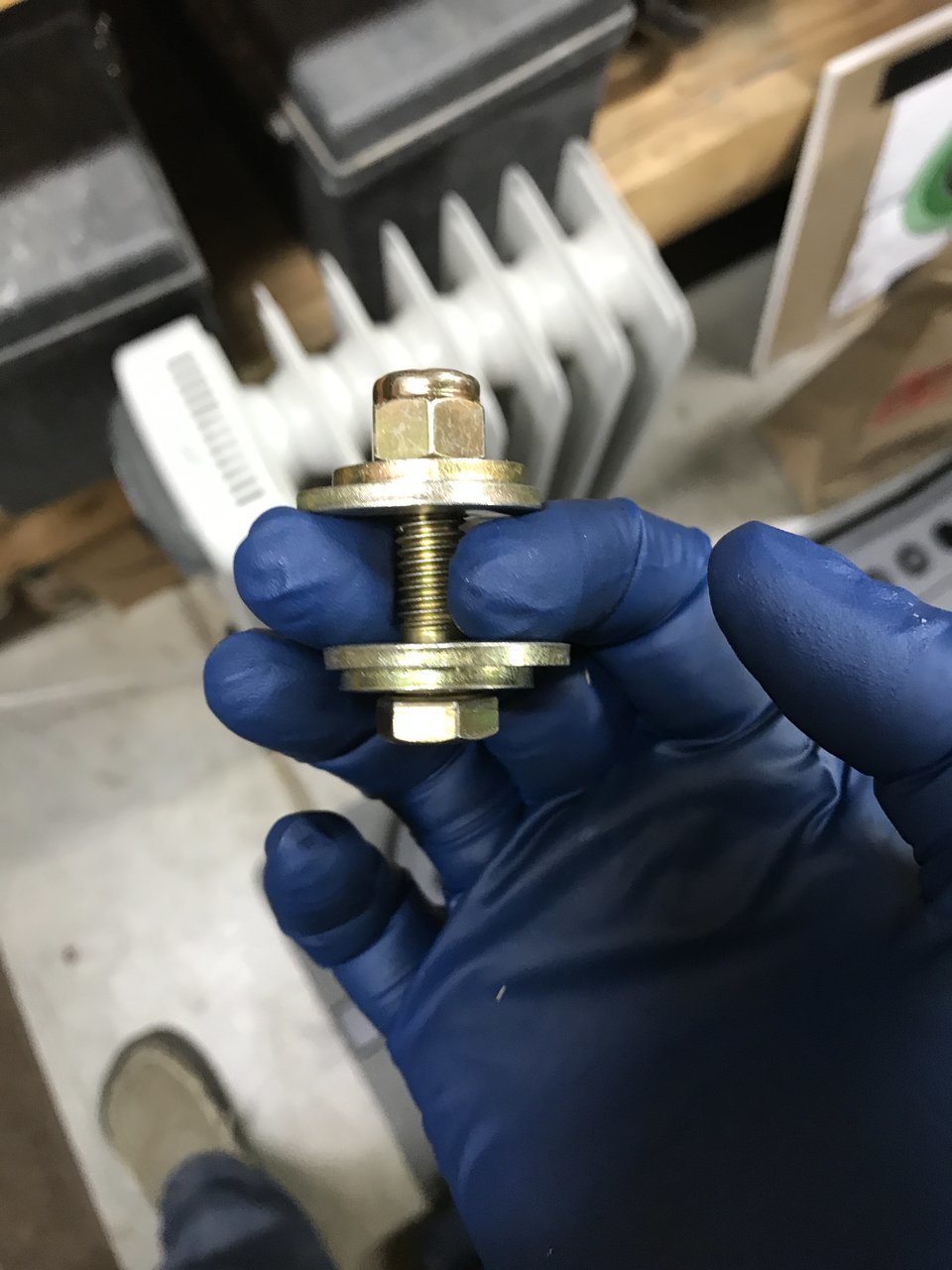

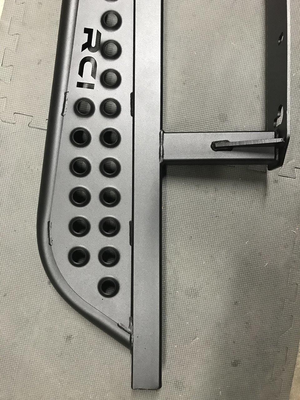

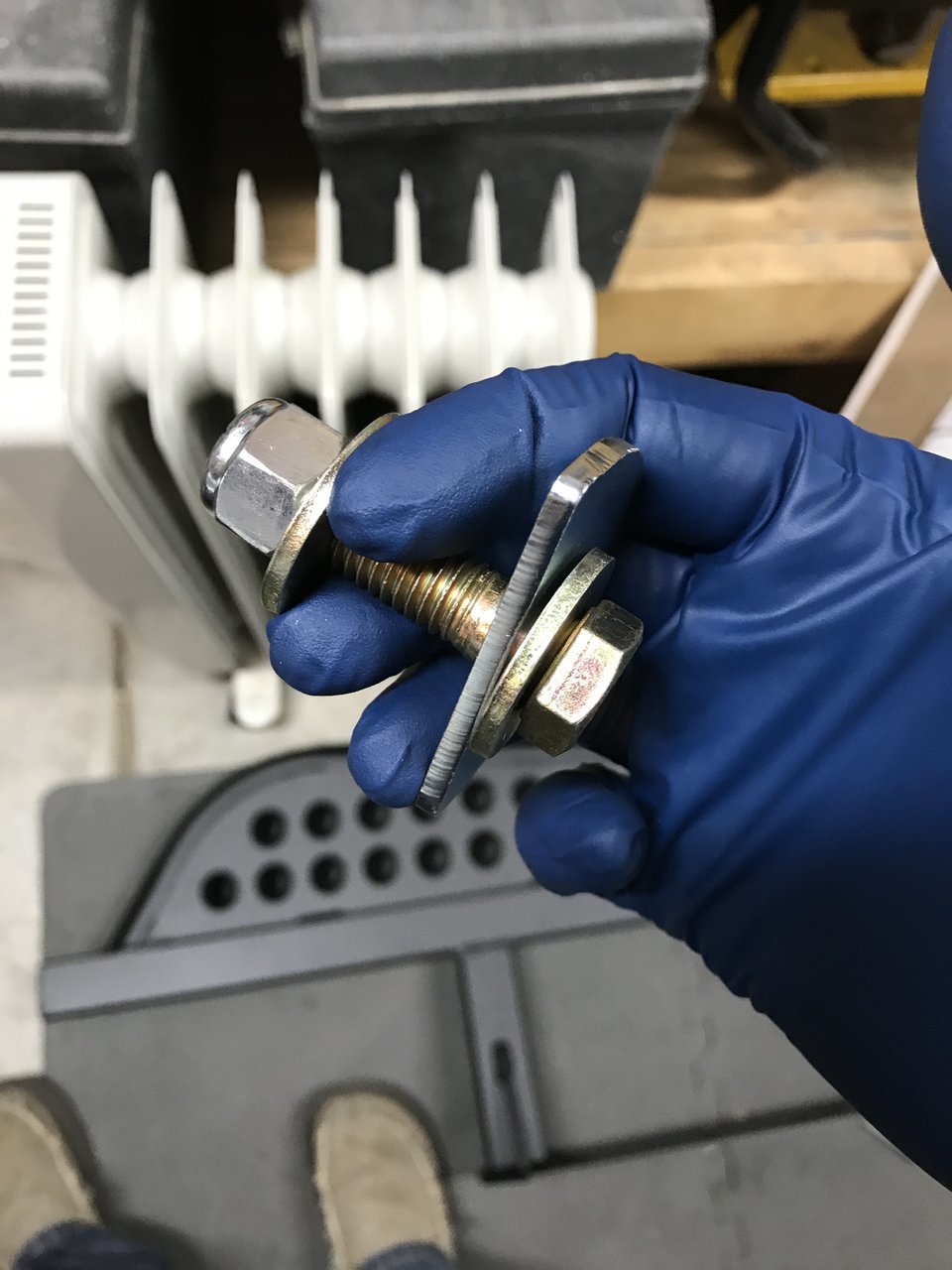

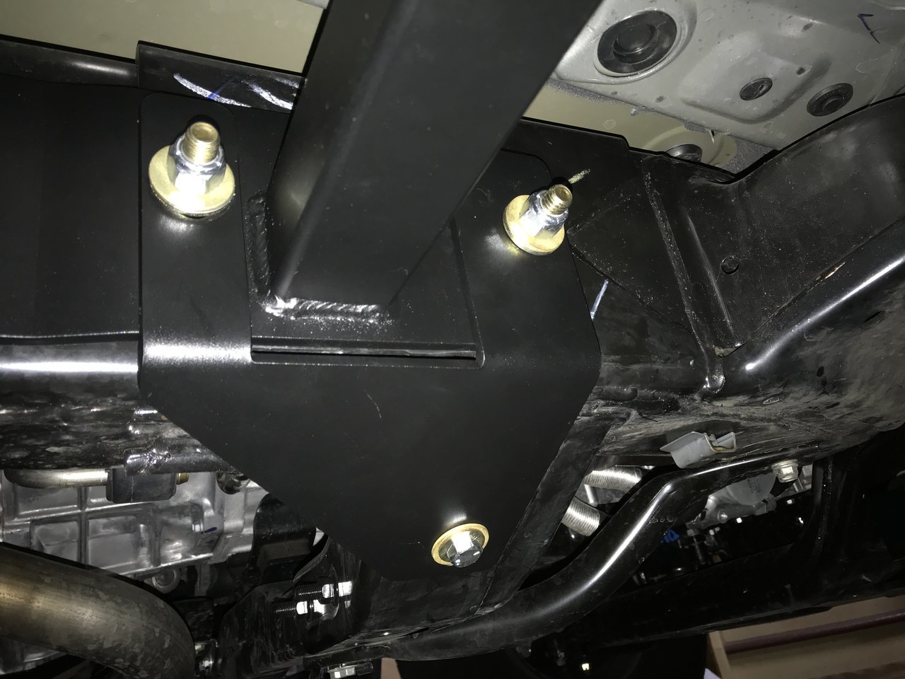

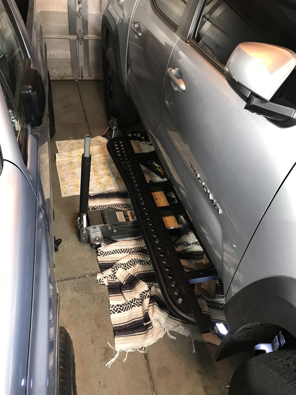

    B937DC42-DCAA-4C6D-A315-0918A2F5DE55.jpg 74B43A62-A60B-49BE-B524-81B53DED334B.jpg 40795C1B-71D5-43CD-94ED-8B440AE2CF7A.jpg AE97601A-8AE4-4A44-B5A9-ACED6D3033B3.jpg EECAE050-D743-473B-A83E-081CFBFDF009.jpg B3C2E751-556E-428A-AF51-D58C649CEBCF.jpg 6A75A7BA-A9AC-45B4-B4EB-596B2B17F101.jpg I just installed RCI sliders yesterday. I’m here in Fort Collins and picked them up from their business and avoided the shipping
    I looked around quite a bit comparing photos and details of what’s out there. I settled on the RCI’s. Main things were the extra gusseting they provide in the supports, overall design quality, and the placement of the top tread pattern is thought out and placed with precision. I ordered them with a holiday discount and spent the savings on factory powder coat. Glad I did, the powder coat is extremely tough, could not have baked on something similar myself. Overall the quality and heft is great, they should call them frame extensions. Only quibble was the hardware, I only used some of what was provided and upgraded to larger bolts, and more of them. Especially the passenger side I found places to put more bolts all over. I bolted the shyte of it. Some half inch bolts and some smaller, all grade 8 hardened, and extra thick hardened washers are a must. Pics included if that helps.

    :eek: Those RCI sliders look like they stick out suuuuper far. Is that an illusion? Are they not actually mounted in that photo? At some point you go from rock protection to dragging rocks you wouldn't have touched anyway!

    I think what you see is how far they are sticking out during the install, in pic they are not bolted in yet...
