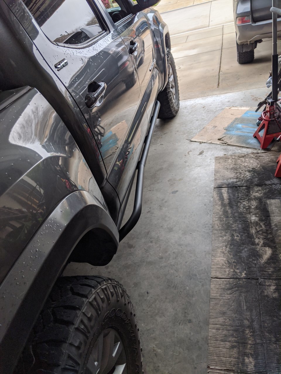

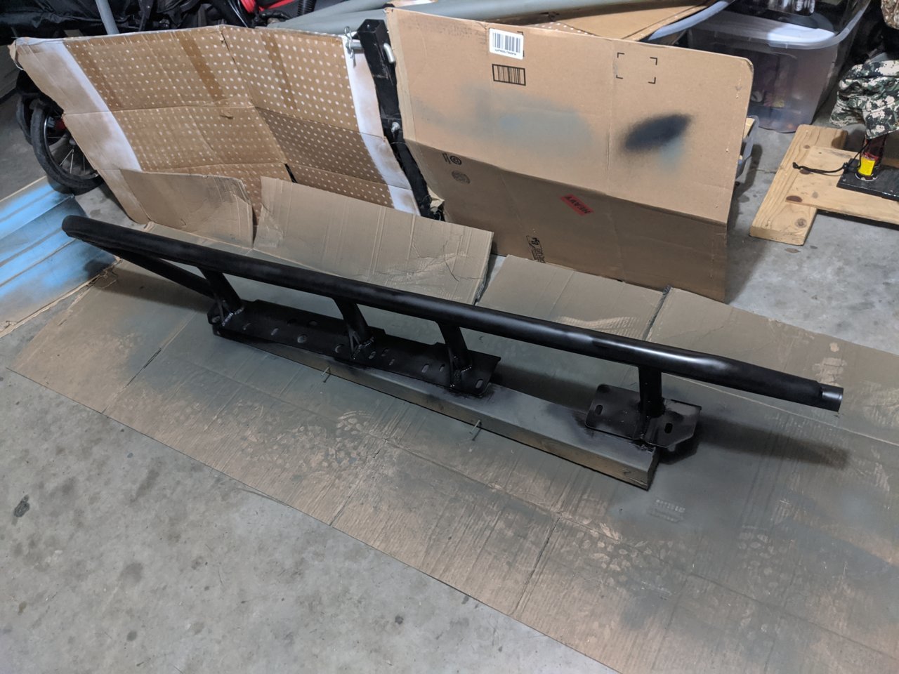

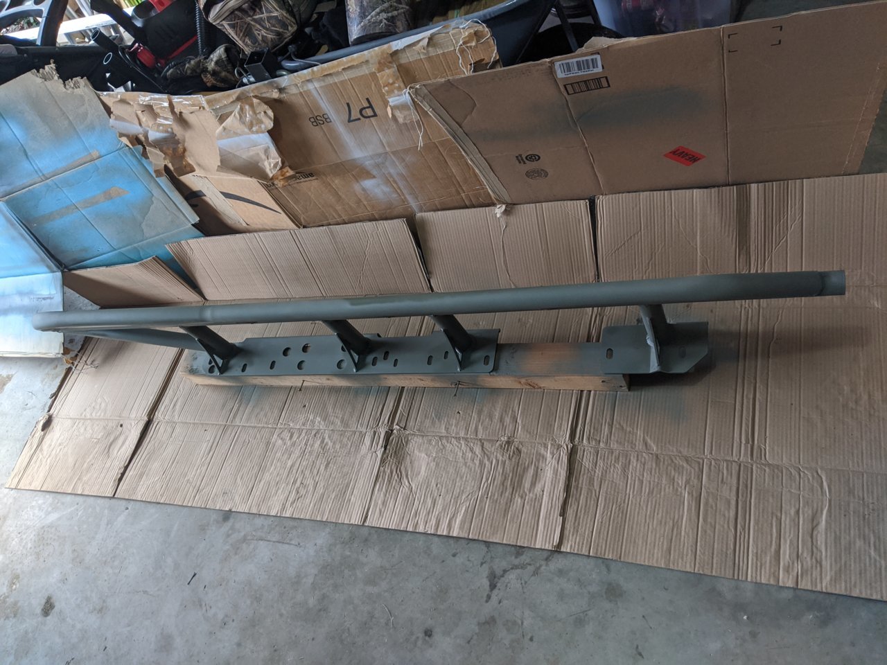

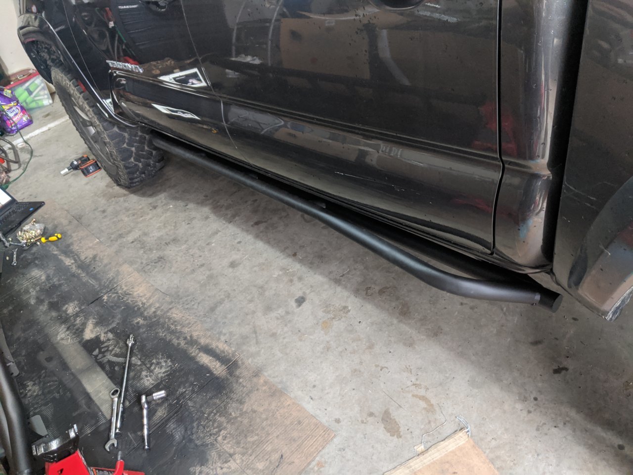

    I picked up some Cali Raised Led bolt on sliders a few weeks about and installed them yesterday morning. They are very stout and I can't wait to test them out. The install was super easy, I was able to complete it with my left leg in a boot healing from being broken, so that should tell you something. I decided against weld on so I could easily remove them if need be. I also got the uncoated ones and used etching primer and matte black paint so I can easily touch them up.
    One thing to note, if you want them to protect from door dings get the 0 degree sliders, they stick out past the door, the 25 does not.

    I rested for 4 weeks, and the install wasn't bad, just laid on my side and lifted the slider with 1 arm and screwed in the stock 14mm bolt with the other. Easy peasy from there on out.
