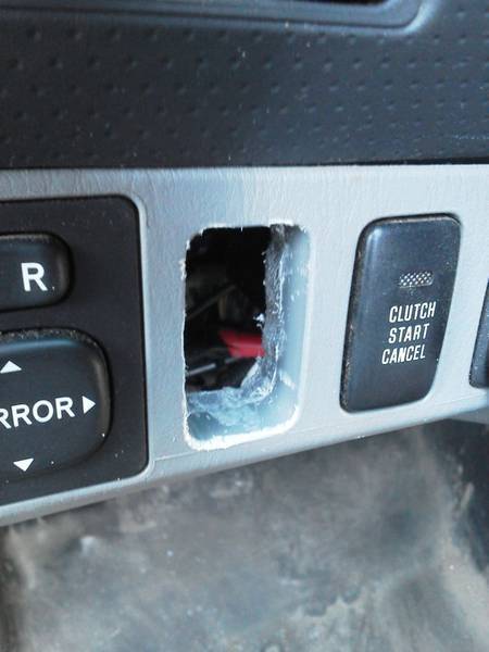

    finallly got my switches in this weekend!
    in order to get the switches in, a little filing needed to be done.. i took a round file to the ridge that is in the stock holes to make the opening flat all around...
    then they will slide right in...

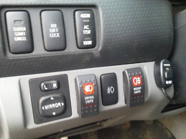

    i have my driving lights setup as an on-off-on where i can have them on anytime (up position) and only when my high beams are on (down position)
    same thing will be done when i hook up my backup lights..
    i swapped my factory fog switch and the clutch switch so i will have all my lights in the same row...just ordered up a rocker switch for rock lights today which will replace the factory fog switch

    for my on-off-on switches (driving and backup lights) i bought the cover and switch separate but they assembled them for me...
    VVAFCN5-17U (driving lights rocker) $3.50
    VVAFC77-18B (backup lights rocker) $3.50
    V6DAF66B-00000-000 V-series contura II sealed rocker switch, body only, no rocker $8.50 each (2)
    then for my rock lights i got the fully assembled
    V1D1J66B-AFCBL-RK1 V-series contura II sealed rocker switch, rock lights
    the switch body is V1DAB60B - 12V single upper light, no lower light
    without the lower light it came to $11.00
    this should be in by the end of the week or early next week...

    is there a reason why you didnt file the switches themselves? personally i woulda done that before changing my dash.
