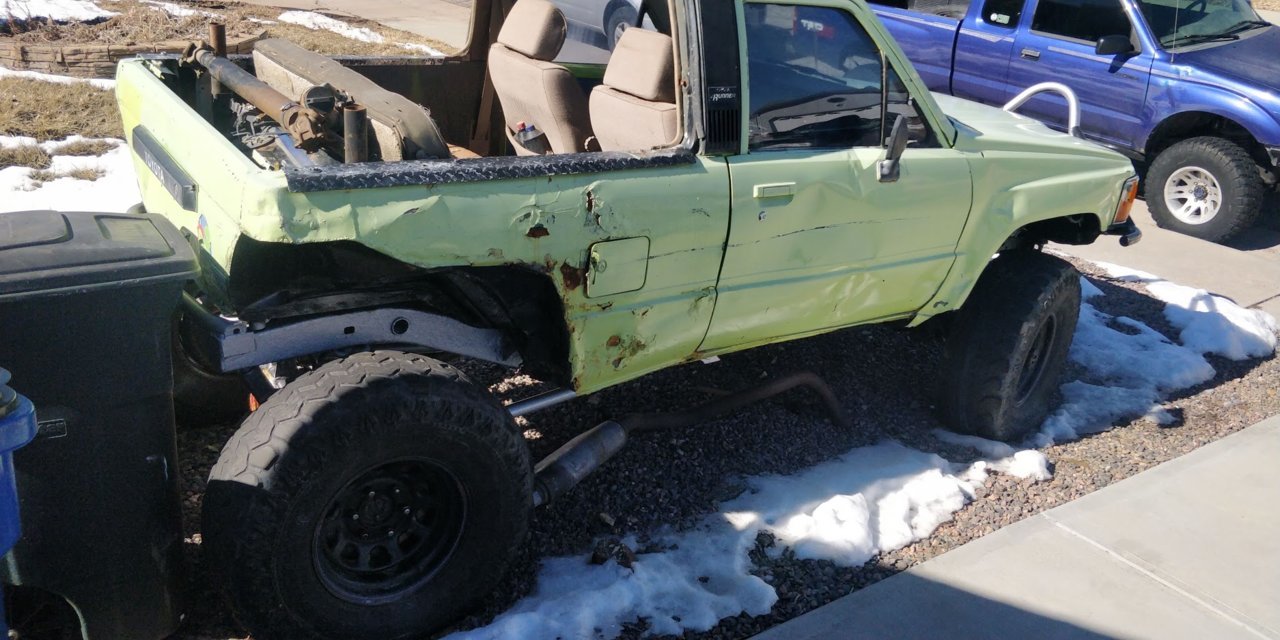

    I bought a 4runner that had this done and the bondo was falling off of the foam.

    Wulf, great to know. Thanks for the pic. Yeah, if I go with foam/bondo it will only be temporary till a real job of cut/weld/paint (either fabricated sheet metal or a real donor rocker).
