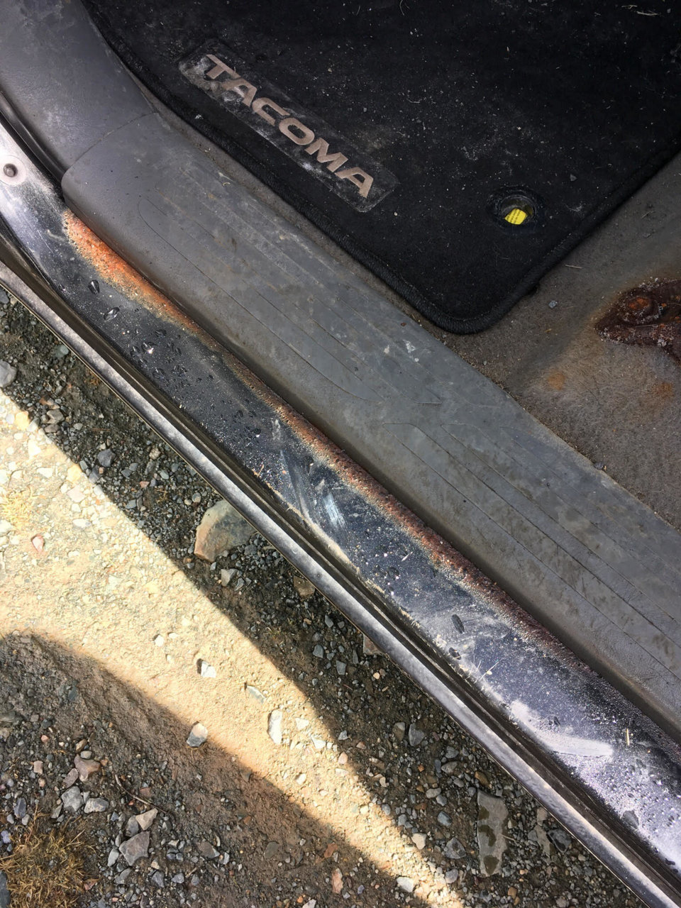

    Hi guys, so when i first bought the truck i noticed the door well (top of the rocker panel) had a fair amount of surface rust on it. I cleaned it and repainted which lasted a year, but come the winter again alot of salt makes its way into the cracks. What I've noticed is the plastic trim on the door well rubs paint off of the metal then salt comes in and it begins to rust the bare metal again. Does anyone have a long term solution to this? I'm tempted to bring it to a body shop but its probably quite expensive :bananadead:

    Heres a before pic of when i first got the truck:
    I cleaned it very well and repainted the works. When i was sucking some salt off the mats just then i noticed right under that plastic you can see the stretch where the plastic touches the metal and the paint is gone along with some surface rust in that line

    Not to detract from your topic, but look at the seat mount. :eek:
    Have you been under the truck and thoroughly examined the frame with a pry bar, ball peen and maybe a borescope (camera to your cell phone) inside the frame?
    If all that is good, we'll come back to the rocker. But based on your seat mount............ I'd be very concerned about the frame.

    This is all normal for winter heavy areas lol, frame passed inspection and seat mounts rust in every car here due to 7 months of winter with heavy salt use. Truck is perfect and the only spot of rust is the seat rails and the door sills lol :)

    I'm glad for you. But I don't trust inpectors as much as I trust myself. With 7 months of rabid salt I'd have to be looking.
    Back to your topic.
    You can remove the sill plate, pull the carpet back a bit, sand the rust down. Then treat with something as simple as muratic acid (very carefully, like on a brush) to finish up eating at the rust.
    Then paint with a rust encapsulator like POR15 or the www.monstaliner.com product to 'seal' it, then finish with your color of choice. You might find black monstaliner to be a good selection for that area, since it appears the truck is black?
    I'd also pull the seat and treat the frame/mount the same way and use a new bolt.

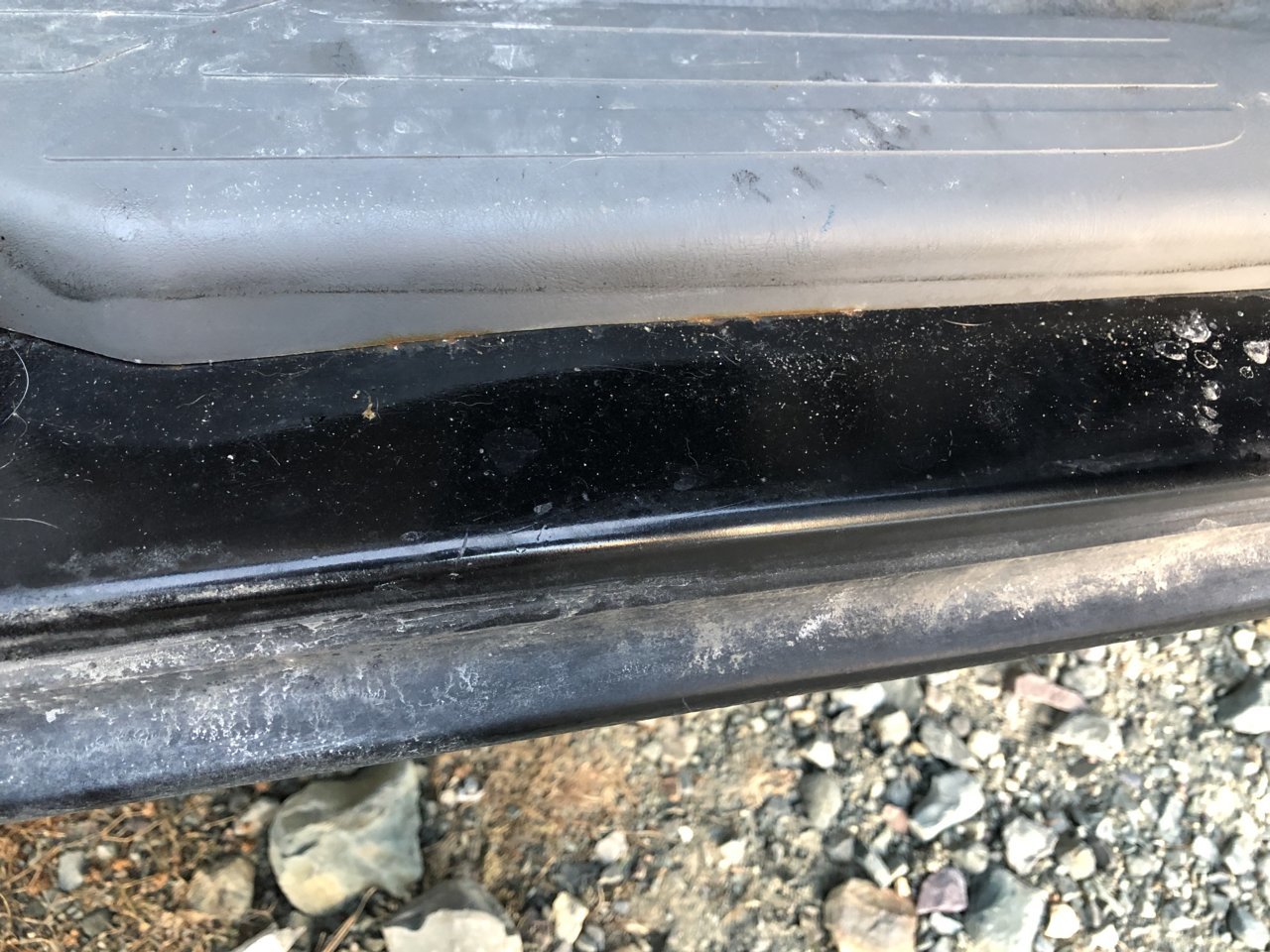

    This is what I was thinking, the rust isn’t behind the sill (at the carpet) it’s simply at the contact point between the plastic and the metal. I really should upload a photo of what it looks like now because I fixed 95% of the rust in the first picture. I’m thinking sand again, prep with the por 15 prep stuff then por 15 paint and maybe a top coat, but that doesn’t matter because almost of the rust is at the edge of the sill plastic

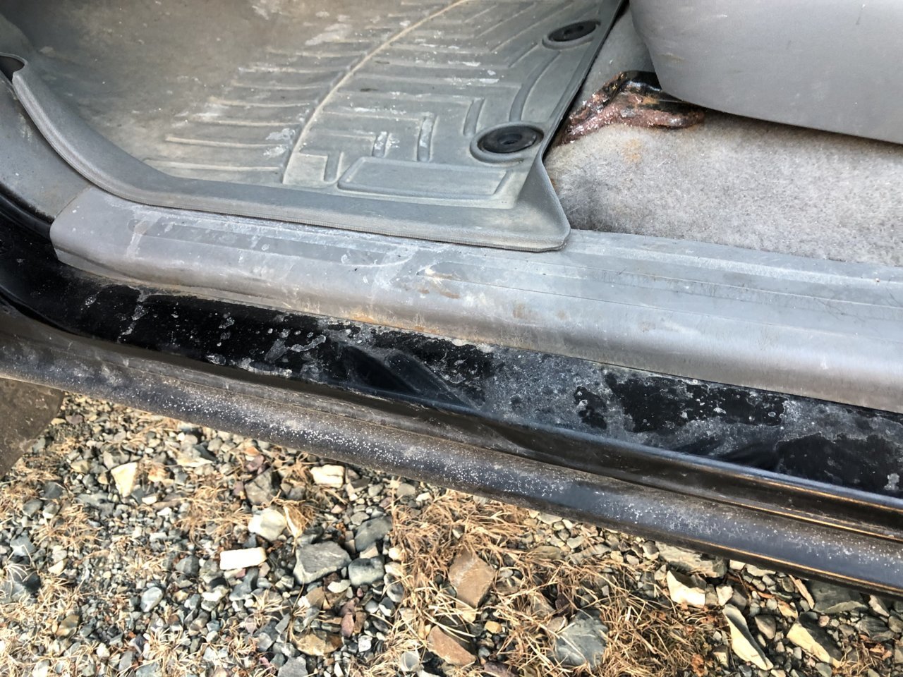

    Here’s what it looks like currently, notice how salt is accumulating in the sill. Also the plastic is stained from prior rust, the front looks good still (first picture) but I’m noticing it start to show a little in the second:

    scribe a line on the offending edge of the sill about 1/16th up from the edge, then gently work the sill along a belt sander to that line. Should give a gap between the sill plate and the paint surface.
    1/16th may not be enough, but it's better to do it a bit at a time till you are happy with the result than to try and take all material off at once.

    That plastic rocker piece does not rub through the paint. Hasn't even scuffed my paint in 13 years. More likely the salt works it's way up inside the trim and eats away at the paint. Like others have said, clean it up to remove the rust, thin coat of por-15, then repaint to match. Por-15 is magical stuff.

    So what I think I’m gonna do is trim the plastics about 1/16 like you said, sand, por15 and I’ll make sure I have enough layers on it to prevent this again
